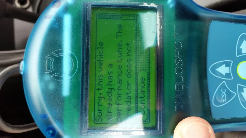

I purchased a auto 01 gt a while back and I had a diablo tuner and I went to plug it in to the obd 2 port and got this message on screen, I'll attach pic. But I have changed my 02 sensors and done a full tune up, accel coils, platinum plugs, fuel filter, and I am currently running 87 octane gas.
I had also disconnected the battery and restored the HP factory tune via tuner. I have not taken it to ford to flash the ECM? But if it has an actual chip where and how would I go about locating and removing it.
