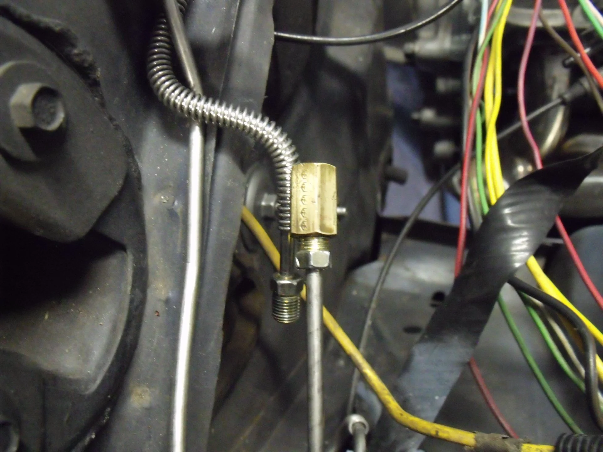

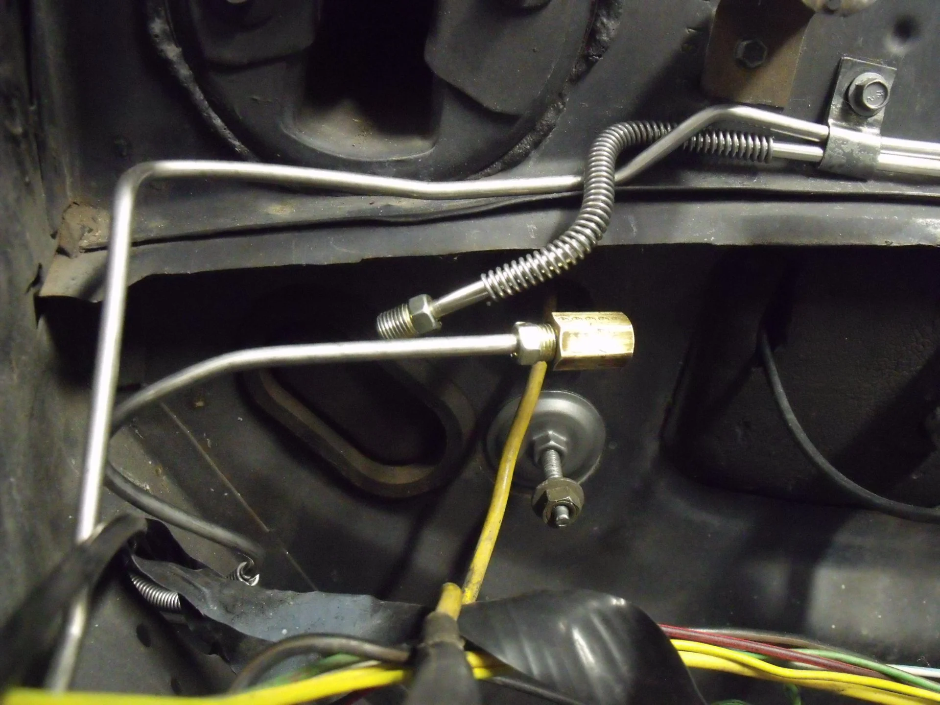

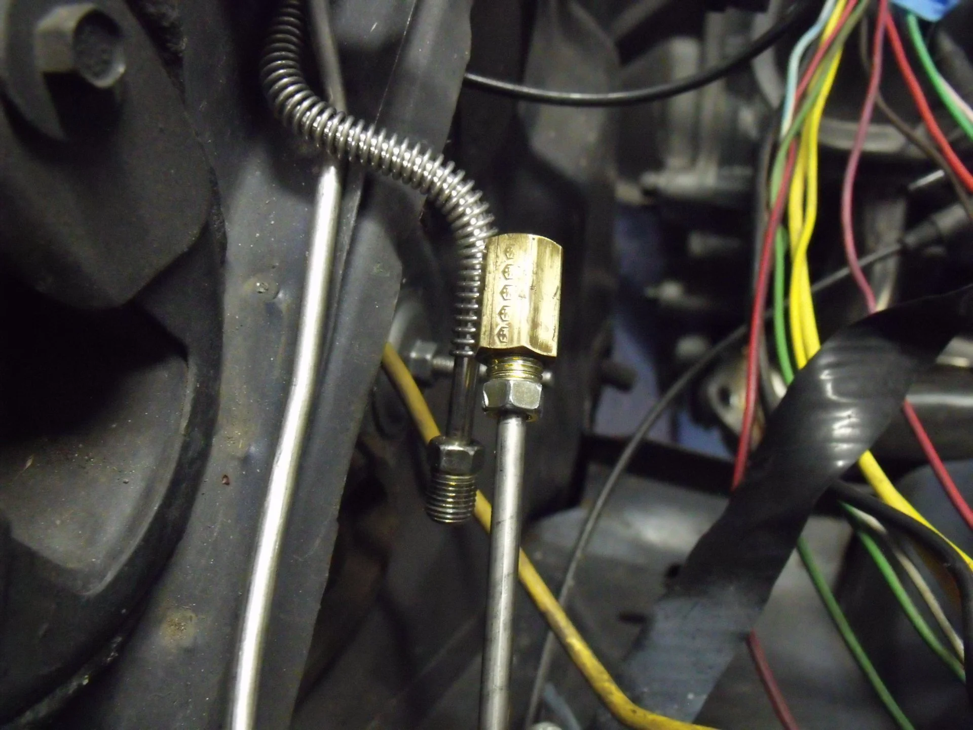

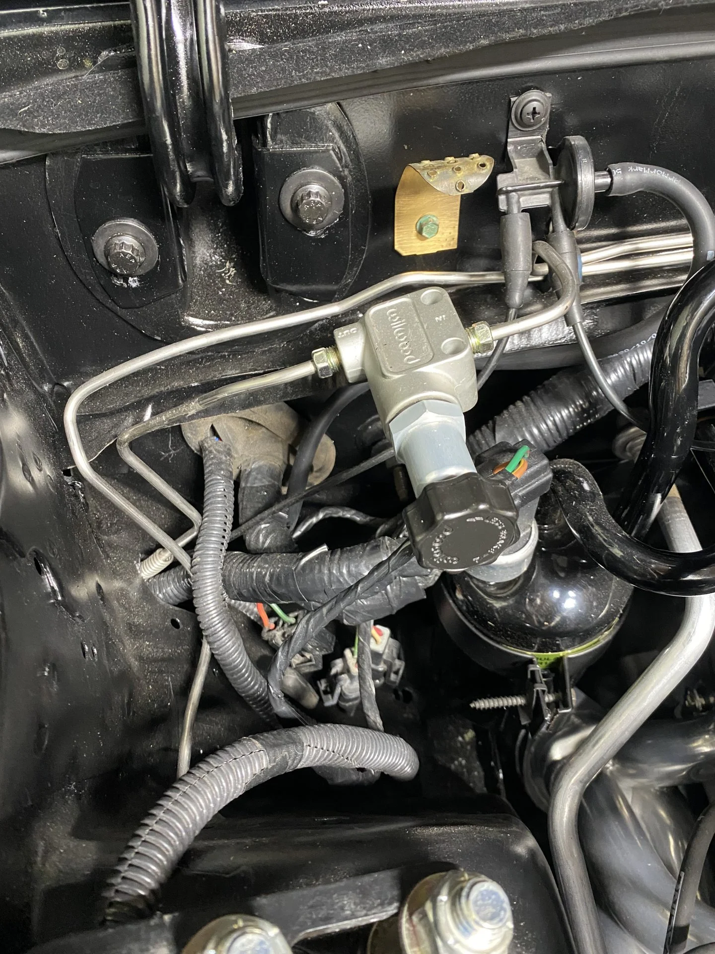

Complete new stainless brake line kit for my 83 GLX..... getting around to installing the line that goes back to the rear and where it attaches to the line across the firewall is not going to work.... I have temporarilly attached it to the bottom of the car where it fits very well but you can see in the pictures its off where hooks to the firewall line...
I cannot bend it any more so I believe my option here is to cut and reflare one or both ends..
No I do not have a flairing tool or have I ever done any flairing before...
Thought I would take the line to a local shop and have them do it....
Anyone add some thoughts to this problem?

I think i had the same issue. I just added a little "kick" to the tubing on the line running to the rear of the car to take up some of the extra line and put the union closer to the firewall.
If I cut and reflared it isnt' there the possibility that the tube can crack?
I have bent it all its going to bend.... Should have seen it before i bent it.....

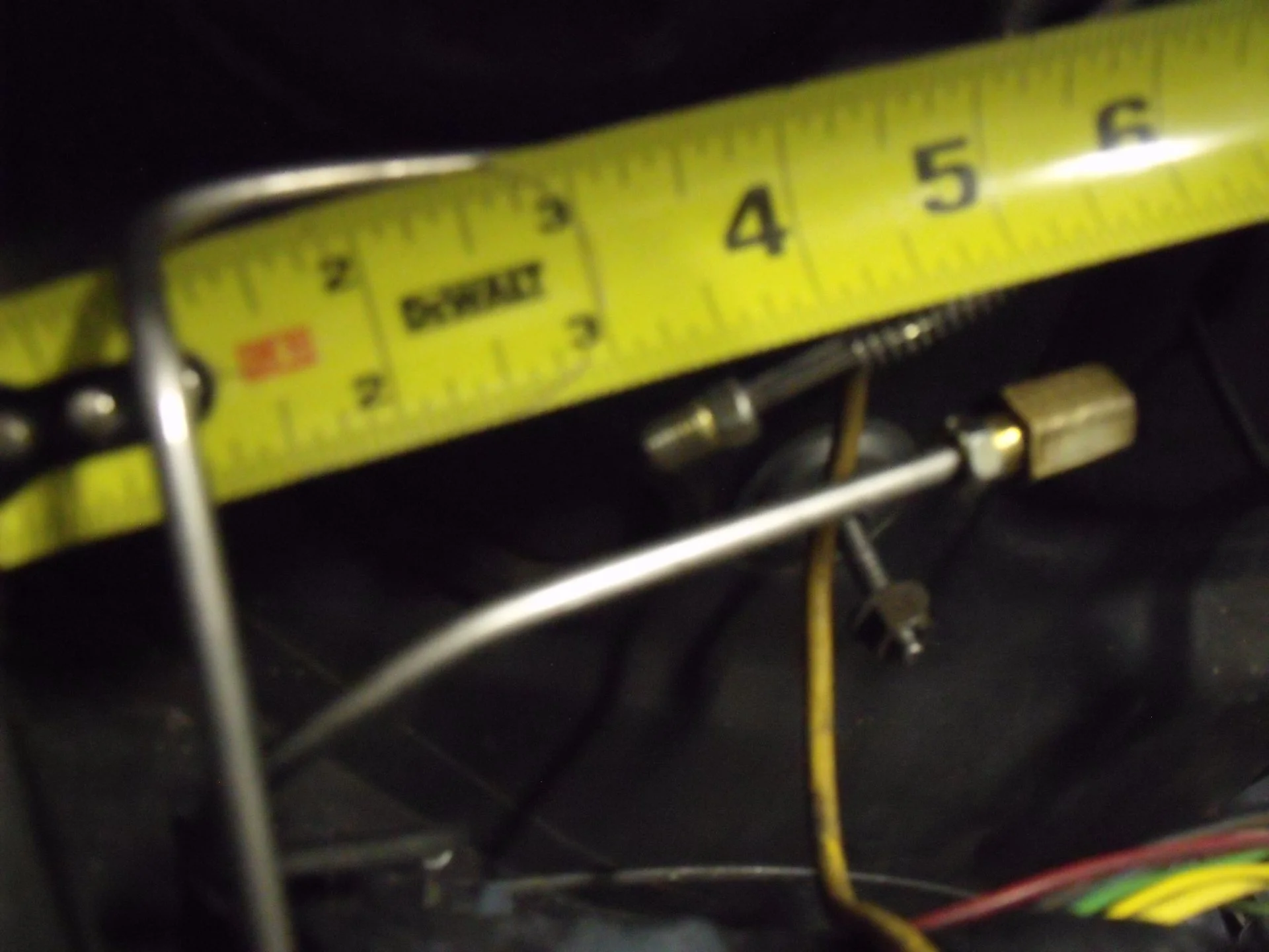

Where the line bolts to the rest of the car is close to perfect, I hate to adjust it elsewhere...

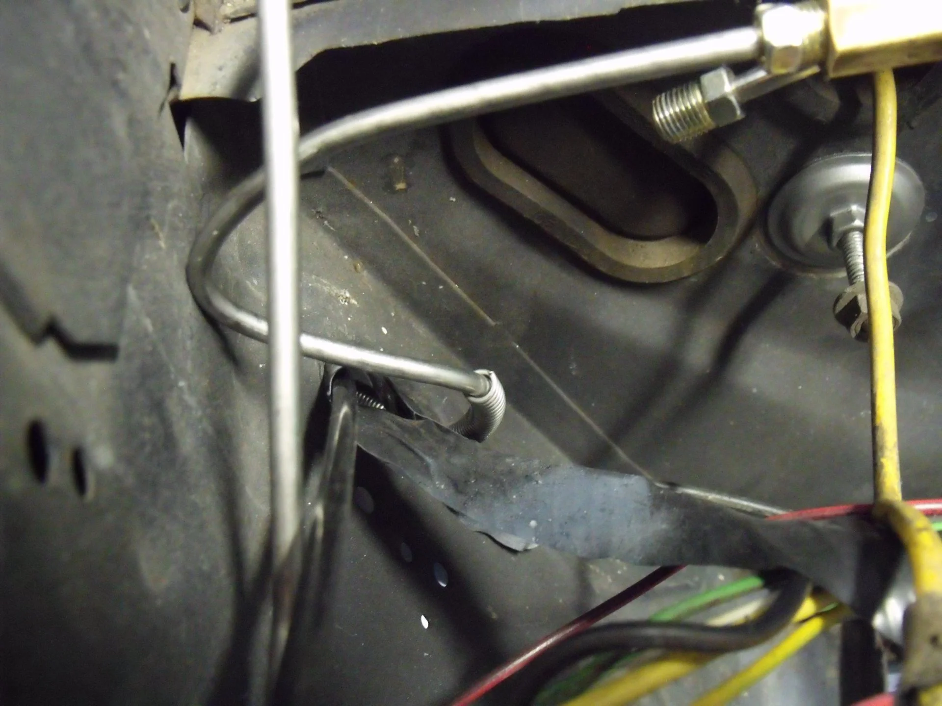

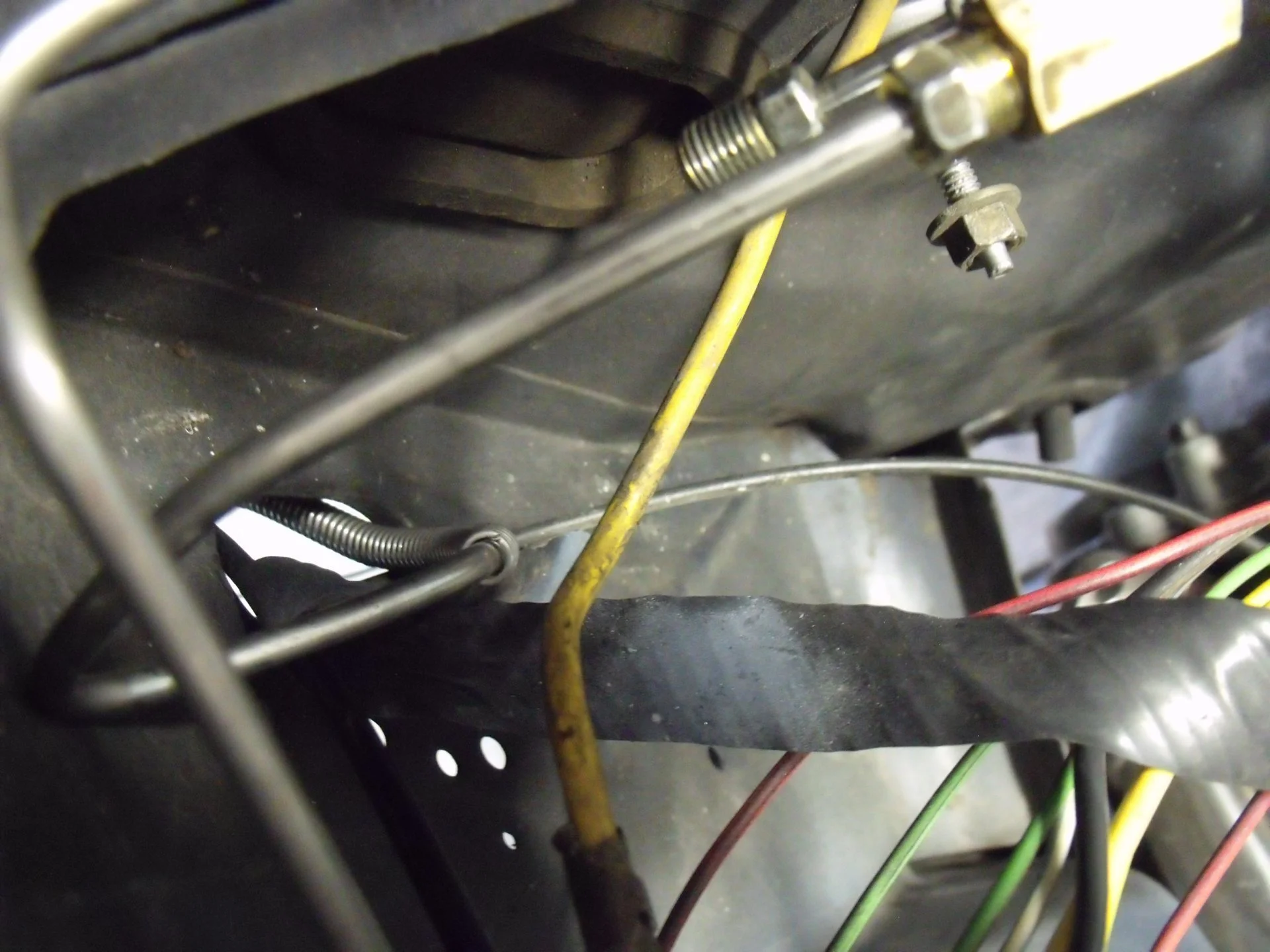

More pics..... The line comes up through a hole in the sheetmetal and then takes a loop towards the pass fender.. There is no room to bend it with this loop.. Too bad the line doesnt' come straight up then bend towards the firewall line... It would bolt right up..
That’s what I’m getting at. Exaggerate the bends to take up the slack
I understand what you are suggesting... Just had some bad experiences with kinking in the past... Not to excited to destroy these brand new lines..

The SS lines are actually pretty robust. I’ve been pretty aggressive with them and haven’t had a kink. That’s one of the main reasons they are a pita to flare. They are very strong.
But I understand your concern. See what they say and go from there

As I said, BOTH of these lines were from the same company and they don't work....

Funny thing is the new line where it goes under the floor pan, then snakes up the back of the fender well fits like a glove there.....
Bring this up because one of the comments back from the " ford " specialist at NPD was " you have it pushed up too far" ... LOL... I guess he wants me to hang the line on the bottom off of some baling wire.....
Tomorrow morning I am going to remove it and install the original fuel line and see if it will connect with the new firewall cross over line.... If it works I might just run it....

Those lines where you are trying to hook them together in my experience rarely fit nicely without some "input". I have done it several times. Grab that line coming from the firewall, bend that thing towards the drivers side, then bend the S tighter. The one coming up from the bottom, same deal. Don't be afraid to grab them and use some force. They will line up. The last thing I would do is cut that line and try to flare it.
