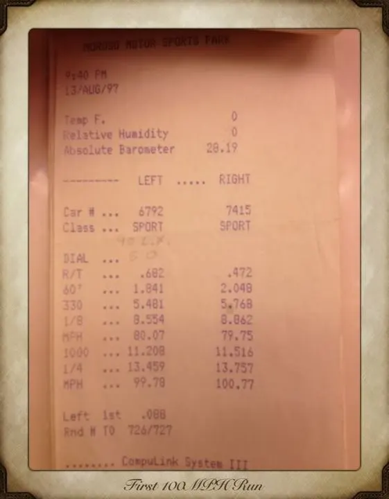

Like mentioned 3:73 gears, Edelbrock Performer Intake, 70MM Throttle Body and Pro-M 77 Mass Air Meter. This with a full exhaust back in the day got me into 13's. I ran 13.75 at 101MPH all day on street tires which is enough to beat a Prelude. Make sure you take it to the track.
Here is the time slip from one of my runs, I'm on the right side. I wrote my mods on the back of all my time slips. This one says- Edelbrock Performer Intake, BBK 70MM TB, Pro-M 77 MAF, MAC 1-5/8" Shorty headers, Bassani X-Pipe (no cats), MAC 2.5" Cat Back, Pulley's, 3:55 Gears, Springs, Steeda Upper / Lower Control Arms, Sub Frames, FRPP King Kobra Clutch Kit, Street Tires 245-50-16's on stock Ponies. Dyno 241 HP / 289 TQ at the wheels.
