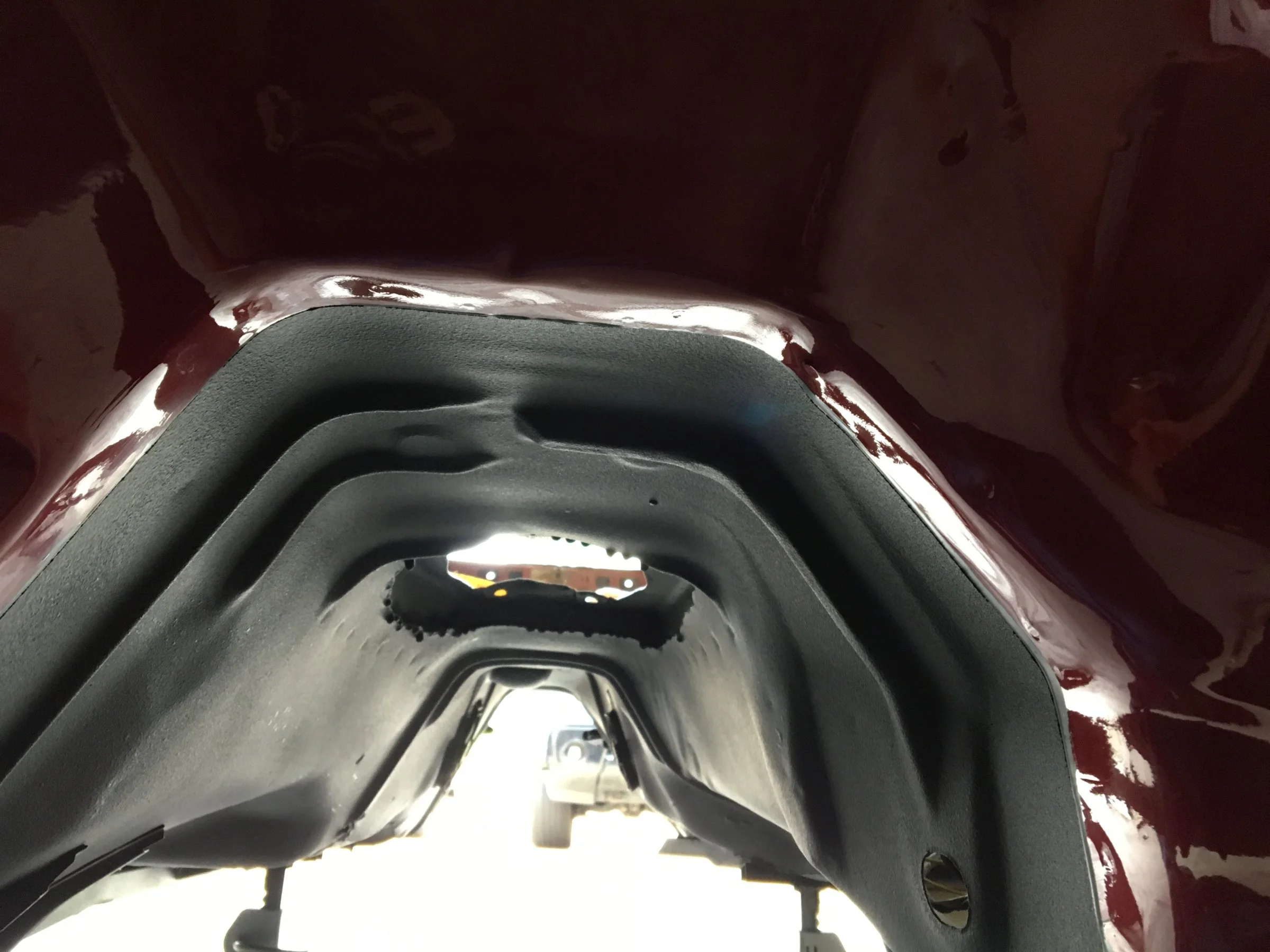

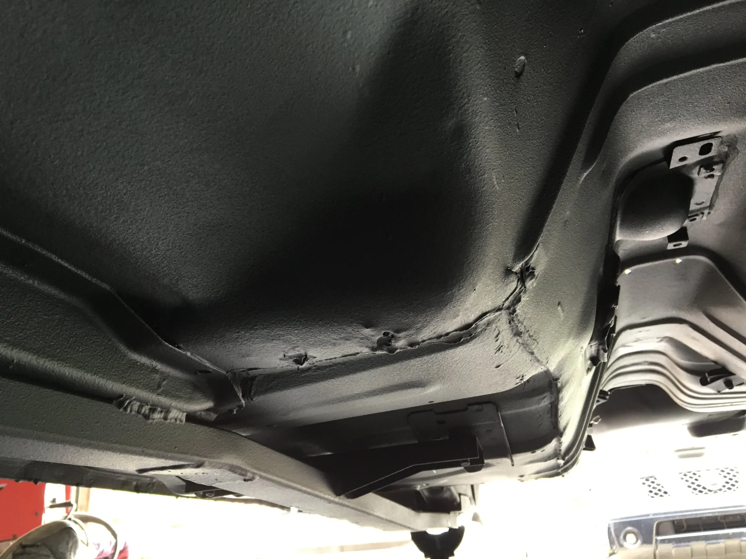

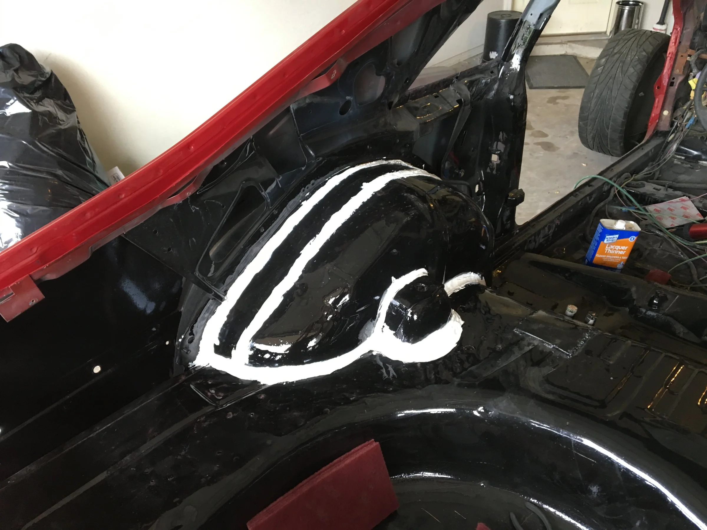

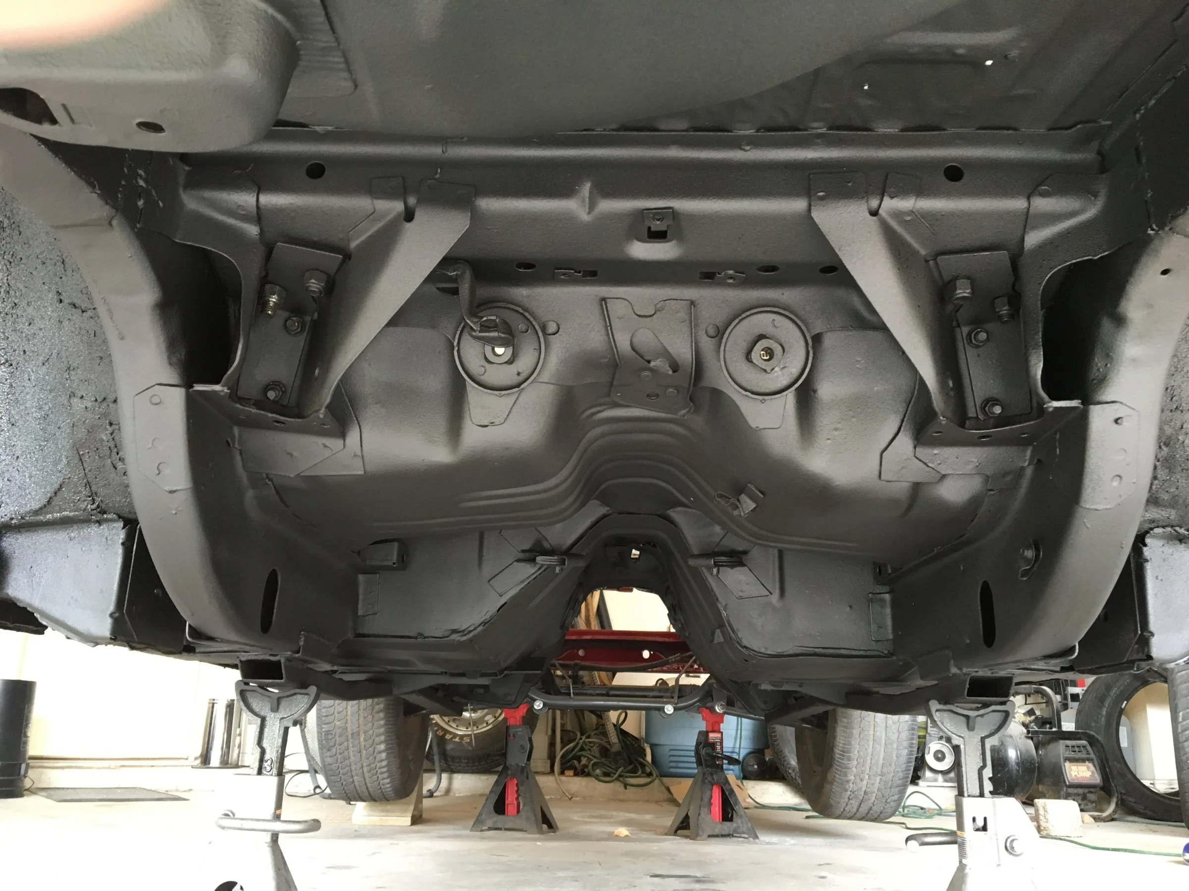

Here's some pictures after i coated the undercarriage and one of the interior. You may see where i had to replace the rear floor pan areas and some of the other patch work i did because of rot, plus a homegrown mini-tubbing.
