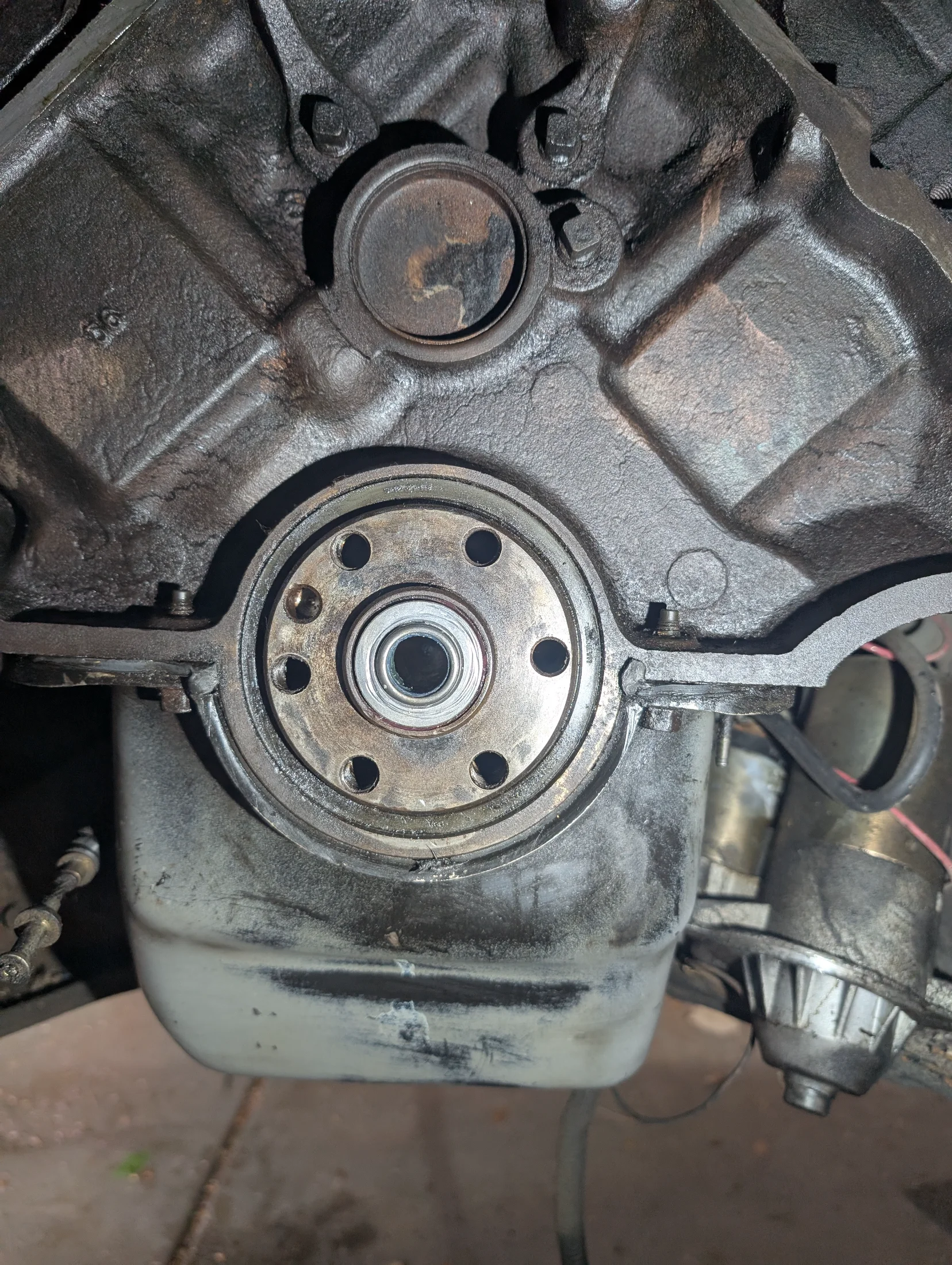

Noobz347 said:
1985-1997 Models Ford 302 Engine Rear Main Seal Repair Kit
Shop our premium Ford 302 Engine Rear Main Seal Repair Kit, featuring a durable silicone rubber seal, sleeve, and a convenient installation tool.
tdmotion.com
Their may be places to get one for less.
This sounds relevant to my interests. Seems lik a way better solution than just putting a new seal in and hoping for the best.

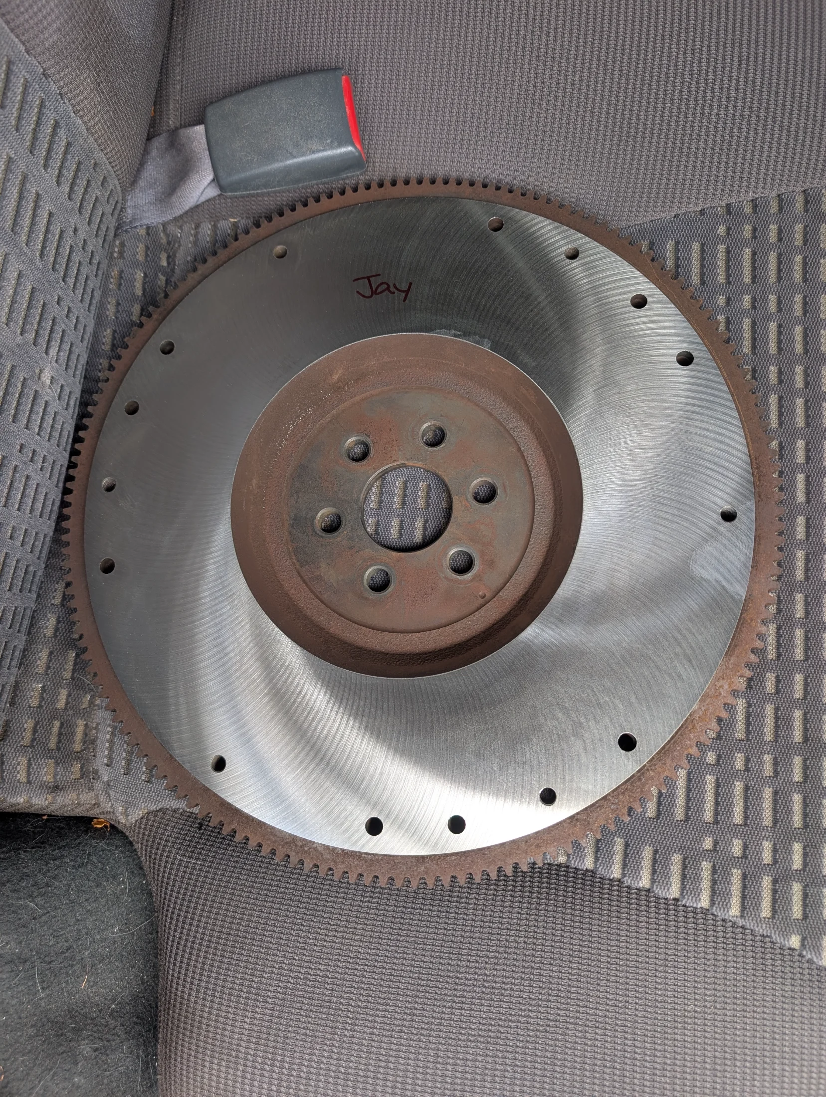

Yeah, that flywheel would go to a shop and get ground if it was mine. Needs the proper surfacing for the new clutch plate to properly bed. Not saying what you have won’t work but for all the effort I would have it ground. Would suck to pull it all back apart.

Yeah, he was talking about replacing it but it looks salvageable to me.
If you do replace it, I'd go with billet steel.

Dropped off the flywheel at a machine shop. See what he says.

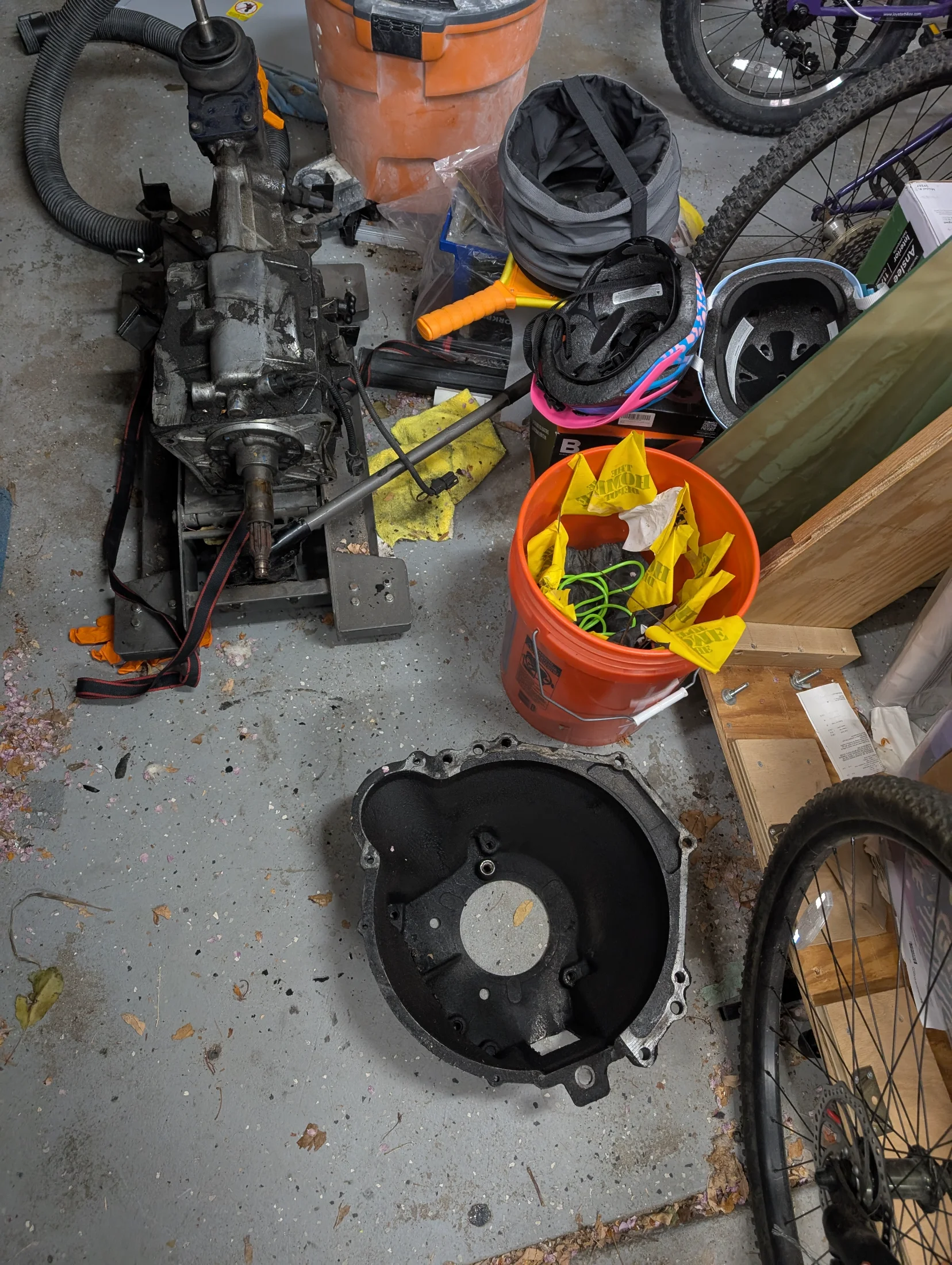

What's the consensus?
I've gotta take the bell housing off the transmission so I can degrease TF out of it. Easier to mount the bell housing to the block and then offer up the transmission after the fact? Or go through the difficult task of reaching those upper bellhousing bolts with the transmission in tow. Understanding that getting the throwout fork lined up will be a PITA without it already riding on the bearing retainer, but the bolt pattern on the transmission is way easier to access under the car.

Aaaaaand I just realized that there are no dowel pins sticking out of the back of the block.

Pulled the bellhousing off. Gonna take it to the local car wash this weekend and pressure wash TF out of it. Ecological disaster indeed.
I don't think I want to with the bearing retainer since nothing is leaking and this was an off the shelf T5z that had all the relevant upgrades 15yrs and less than 10k ago. I'll probably just brass wheel the input shaft and sleeve to get the off.
Sleeve should be here tomorrow. Got the blocking plate and bolts/dowels for the clutch. Dowels for the bell housing are en route.
Found that I can get the actual Ford Racing throwout fork and OE pivot stud from the local dealer for a good price.
FML and open my wallet.
