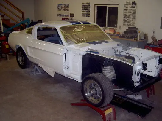

You can see pics from my paint process here. http://www.lumacrest.com/jimmyray/paint pictures.htm

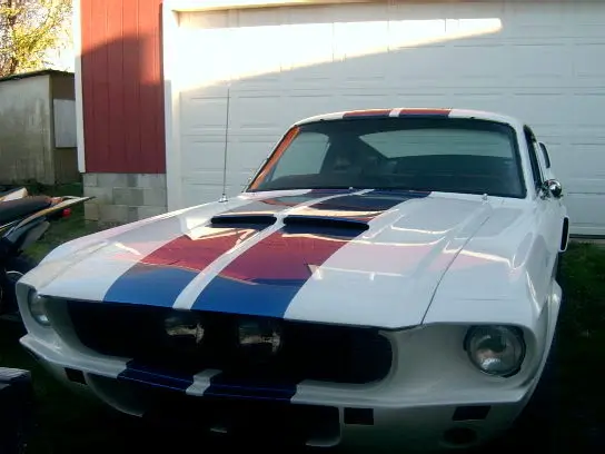

Are you serious? Kevin, without your help on paintucation.com I would've never in my wildest dreams had the courage to try painting my pride and joy. My username over there was CRFJim, and I spent lots of time reading all the posts, asking questions and without exception I was always treated to sound advice. I can't tell you how many people have stopped by to check out my long-term fastback project and been amazed that the car was painted in my garage, and that it is my first attempt at painting. I'm no magician, I just applied what you taught me. I could've never afforder to pay someone to paint my car, so doing it myself was my only option. Now that it's done, it's a HUGE source of pride as well. Thanks Kevin
Jim "Zookeeper" Elliott
BTW, the paint had not been buffed at the time these pics were taken!
Jim! I recognize your login now! VERY nice work on the fastback... I can almost smell the clearcoat outgassing! LOL! Thank you so much for the kind words.... I appreciate it very much. My mission with Paintucation is to try and do exactly that... give people a little inspiration to do it themselves. It looks like your bodywork is first clas too.. nice panel gaps and attention to detail. I'm in the process of revamping the website, if you could send me some pics of your fastback I'll stick em up where they're visible if that's OK with you.
Nice work! and remember that I wasn't there that day..... you did everything! You should be very proud of that car.
