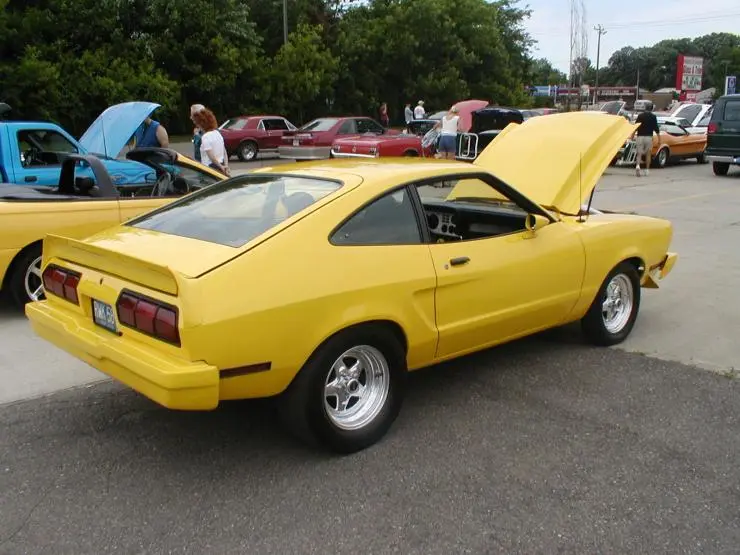

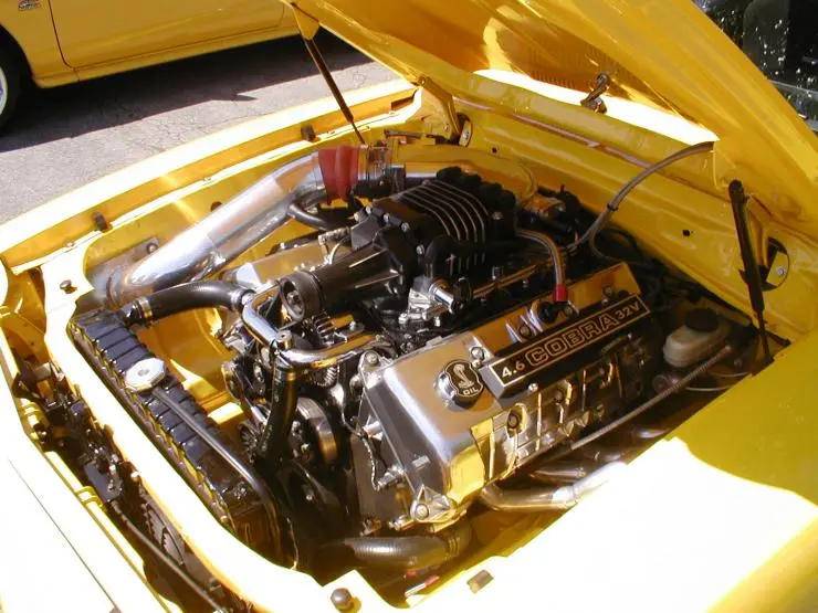

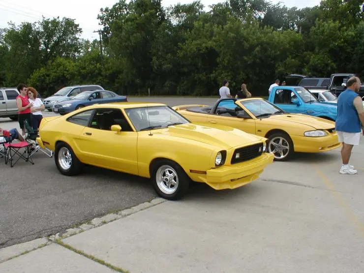

OFF topic, has anybody ever seen a Mustang II with a 4.6 i it? Just curious.
