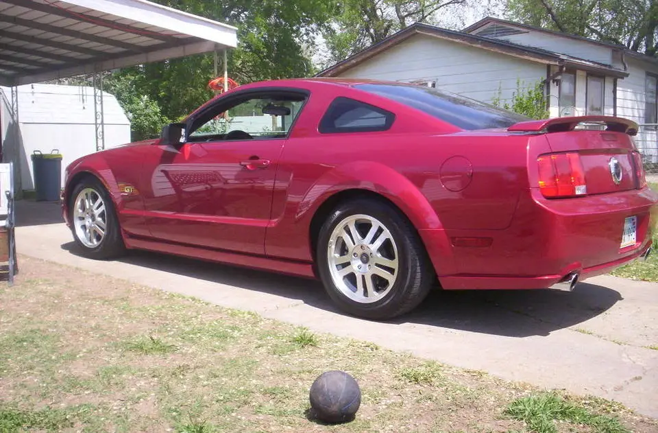

Pro Kit
The pro kit is the way to go. If you ever plan on installing an aftermarket driveshaft which is a larger diameter, the sportline kit will cause major driveshaft rub problems. The adjustable upper control arms do not allow that much of a pinion angle adjustment. My Steeda springs only dropped the ass end 3/4" and I still had to beat a few dents in the trans tunnel under the rear seat to keep the big aluminum shaft from rubbing.
