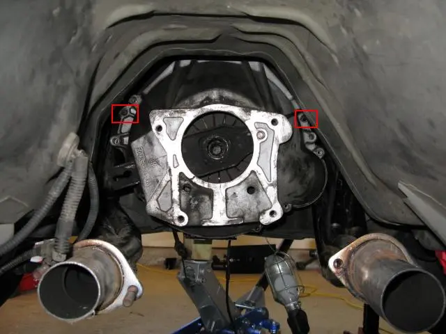

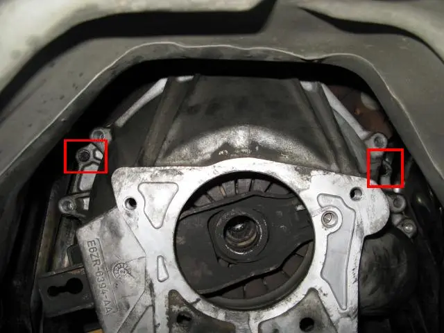

For some reason I can't get the bellhousing off the engine block. It's a 1993 5.0 with a T5. All the bolts are removed, front and back of the bellhousing. Chilton's says there are two dowels on each side of the bell housing, that's all that's left. I've marked the dowels in red on the photos. Are these the dowels? I've checked the front and back of the dowels and they're aren't any bolt heads or allen wrench heads on them so I'm assuming they're press fit. Any ideas?

You are correct. Those are the pins. Its a tight fit. Sometimes you have to persude it to come off.

Do you have the starter off? I think you have to remove the starter bolts if they go into the bell housing.

Yeah, the starter is off. After 30 minutes persuasion with a rubber mallet I think I've got it about halfway off.

I was just gonna say..use a rubber mallet.

Bell housing off,thanks for the help everyone. But just to answer everyone's questions, yup, replacing the clutch. Also installing a new rear mail seal, pilot bearing, TO bearing, fork, clutch cable, steel bearing retainer for the T5, and a new aluminum flywheel.
