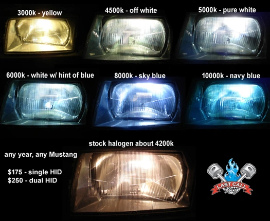

I'm thinking they slapped your package together with mismatched bulbs.
3000k is pretty yellow, 4500 is slightly off white, and 6000k is white with a slight hint of blue.
What does it look most like on our chart?
