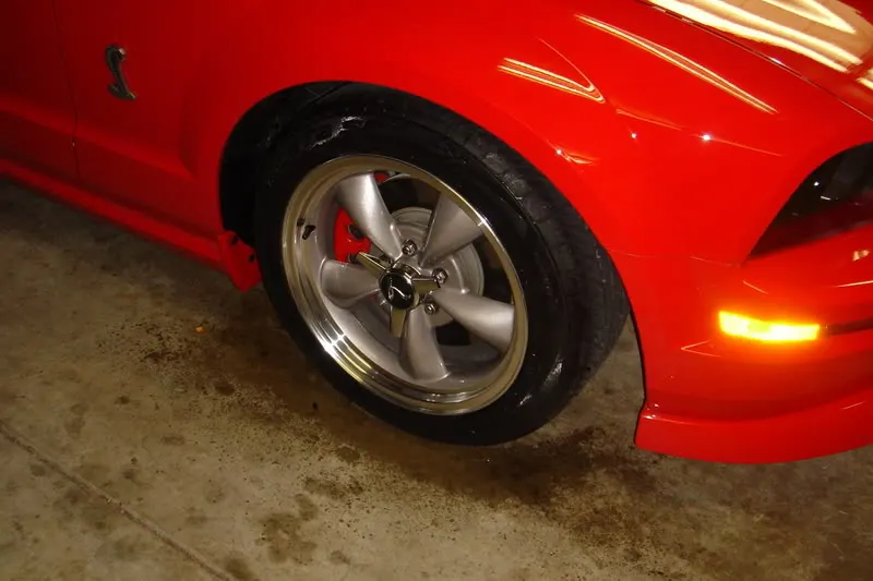

My rims...
Rock36 said:
I knew they were M&S but I really just wanted the wider tire that was close to the same diameter as stock and fit on the stock rim, and to me they felt better than the stockers. I didn't have much luck finding other 255/50-17s, but that was before I started looking at tirerack.com. As for being a harder compound, I agree and I have had a hellacious time hooking at the track with them which isn't much of a surprise.
BTW are you running the Kumhos on the stock rims or did you get a wider rim.
I actually bought these aftermarket Bullet rims off Ebay and they are 17 X 9's all the way around. It Gives me that wider foot print in the rear.
