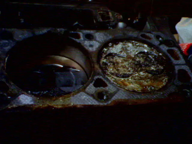

i was driving when all of a sudden i heard a very minor tinking noice (sounded like a very minor exhaust leak) then all of a sudden it became extremely loud!! when i stepped on the gas to get over to the side, it was like i had no back pressure and had to give it alot of gas just to move the dam car! anyway my car ended up dieing and would not start the next day. i charged the battery and tried cranking it. The engine wanted to crank but the starter wasnt doing anything, ( you heard it turn on when you tried to start the car but nothing happened). so i took the serpintine belt off along with the spark plugs. the rearmost spark plug on the drivers side was completely bashed up. i turned the engine by hand. It turned counter clockwise just fine, however when i tried turning it clockwise... it would turn then just stop and not move.
so i proceeded to pull the drivers side head and finished this task last night and this is what i saw...

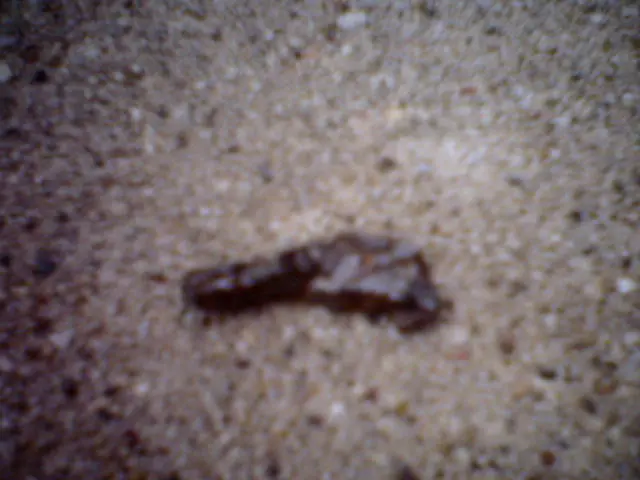

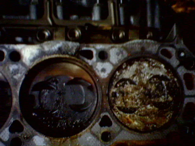

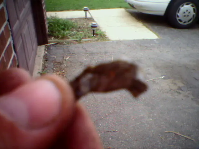

in the rearmost cylinder on the drivers side (same cylinder with the bashed plug) there was a piece of metal about 1" wide and 1/4" thick that was in there. the top of the piston had millions of "lil divits" from the metal bouncing around in there. they valves on the heads were rusted. (is this from the spark plug being completely demolished and not using this cylinder with a spark?)
i dont see anything wrong with the top end of the engine. and cannot locate where that metal piece came from... i am attempting to attach pics with this post lets hope it works...
so where do i go from here? do i need a complete rebuild? how much does something like this cost? would it be wise to bore it out to a 331 and just build the engine up now? how much would this cost roughly???

Sounds like the timing chain jumped a tooth or two.
Or a valve galled to a valve guide and the piston hit it, or a valvespring died, and let the piston hit the valve. Been there, done that, still have the marks in the piston, two head swaps later......
If the plug broke first, pieces of it could beat up the piston.
Probably need to take some more of it apart, and look over everything from the valvetrain down.
Well i looked at the valves on the heads, and i really didnt see any marks. They just looked rusted..
Where should i go from here? i have the engine out of the car. i removed all accessories, upper and lower intake, valve covers, push rods, and the drivers side head... what should the next step i take be?
can i leave the piston the way it is and fix it or does this need to be completely machined?
you can still use that piston as long as all damage has been contained to the top of the piston, meaning that debri didnt work its way between the side of the piston above the ring and the cylinder wall. if the cylinder wall is not scored you sholud use a dremel tool with a small fine grit stone to knock down any high spots to below the plane hieght that the piston was originaly. we had to do it to my brothers low 11 sec. gt after he missed a shift and the engine over reved. he had the car for almost 2 more years before he sold it and never had anymore problems with the short block.

when the engine was still in the car i tried cranking the engine by hand and it wouldnt turn all the way clockwise... after pulling the heads and finding the piece of metal in there... the engine turns fine.
i checked for scoring in the cylinder walls and it was VERY VERY VERY minimal... i really couldnt feel much i think if i took some like 1200 grit sand paper i can get the scores out...

well, it can only get in there one way. through the intake tract. trace back up the intake to the throttle body... make sure there is nothing missing or broken. was the engine just recently assembled, or has the heads been off recently? (just wondering if something fell down and got lodged into the intake while having service done, and just recently came loose and went the rest of the way into the engine. jeesh, would be awful hard for it to make it past that valve without causing major damage. are the seats scored up on that valve?

to answer the other questions... im not to sure if its carbon. i dont know what carbon looks like. thats why i posted pics.. i always figured carbon was a black residue... hoever this was a silverish material that was hard like a rock ( i think it even had a couple of gold spots in there, maybe from rubbing on something or glazing from all the heat)
i left the spark plug in the hole. i didnt know it was bashed up until my engine died and i pulled the plugs to find out what cylinder was wrong...
