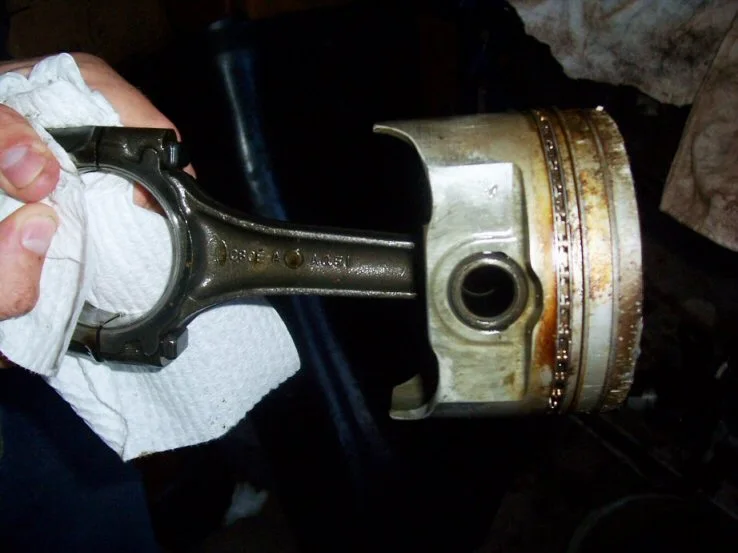

so your saying the wristpin is siezed... so something must have caused it to seize.... but even if pieces fell/came off of the wristpin, they wouldnt make thier way to the top of the piston (well they could, but you would have definatly noticed that when you hauled the head off!!!). i think the wristpin was caused by the foreign object, not the other way around.
i guess carbon could have made its way down from the egr (never heard of that before, but it must be possible).
any way you can get some clearer pictures of the whole deal (the underside of the siezed piston where the connecting rod and wristpin meet up).

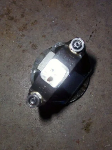

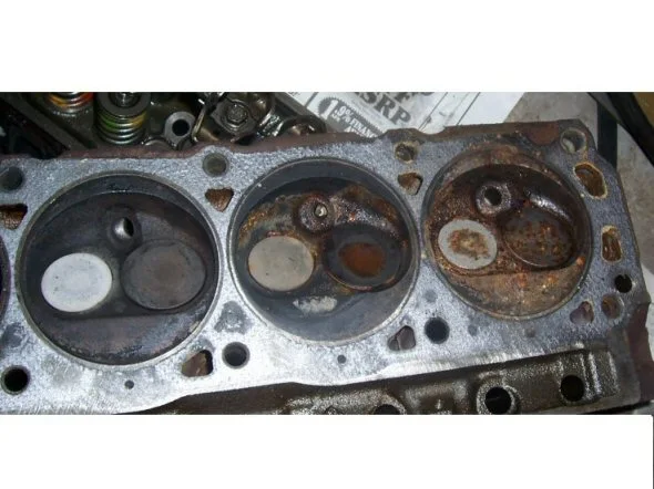

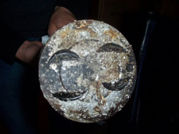

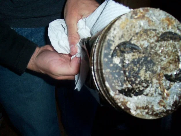

heres some more picutres as you requested guys.... do any of these help you out?
this one shows the bottom of the head.. the most rusted cylinder is the cylinder where the metal chunk was in...

i just spoke to a mechanic at work and showed him the pics. He was looking at the pic with the head and asked if i had antifreeze in my oil... i forgot to post that detail!!!!
i did have minor antifreeze in my oil!!!!! if you look closely at the head pic you can see rust spots where the gasket blew he told me most head gaskets have a metal ring around the edge of the cylinder to help seal it..
unfortunatly i threw the head gaskets away, is there any other way i can check to see if it was this ring?

Im not talking about piston rings.
Look at the pic of the head,or better yet,look at the head and see the lighter "ring" around the combustion face.Does any particular spot look odd?
