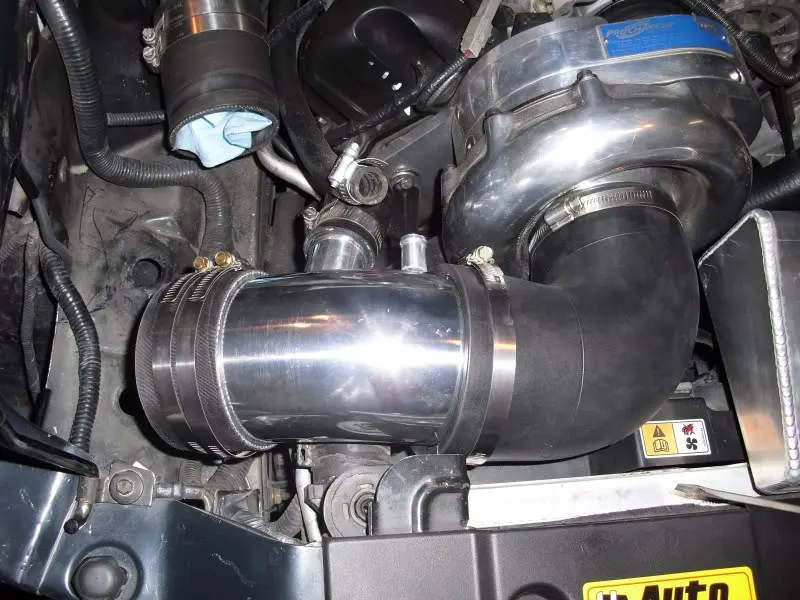

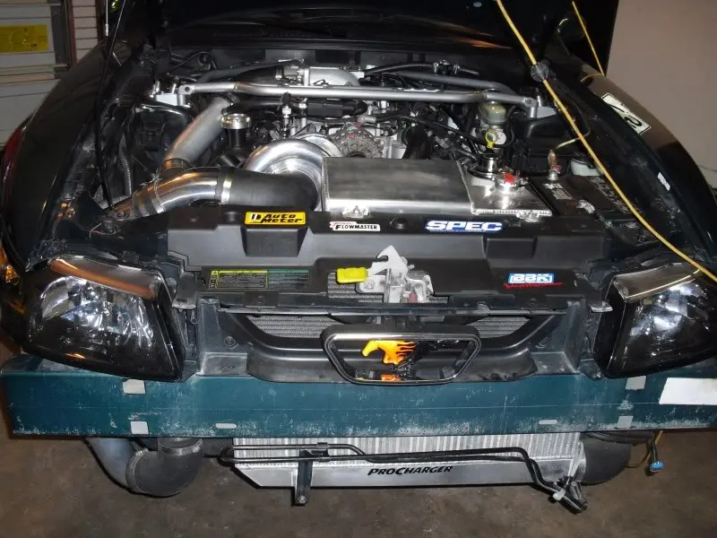

Got my Anderson Power Pipe in the other day so I figured Id post some pics of the install. Im pretty happy with how smooth it went and it looks awesome with the Procharger. Hopefully Ill see some decent gains with it.

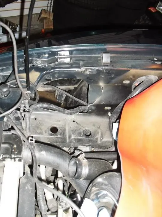

Before..

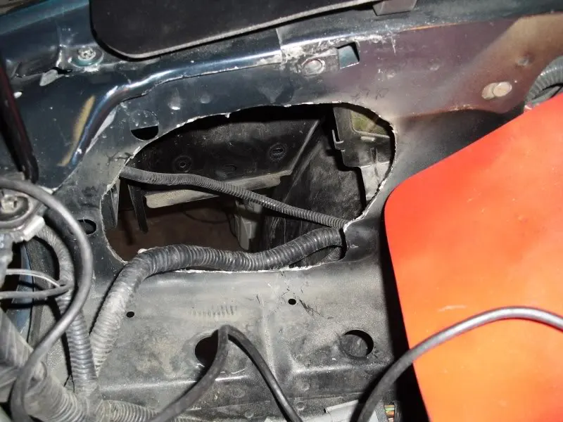

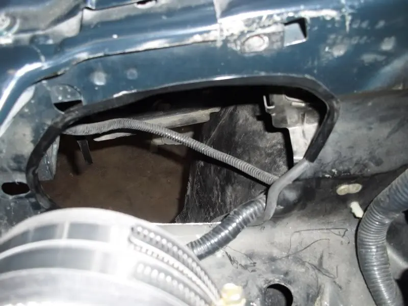

Used a dremel tool to make the fender opening wide enough for both pipes...

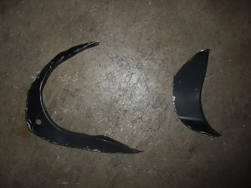

Cut this much out..
Put the edge guard around the opening..

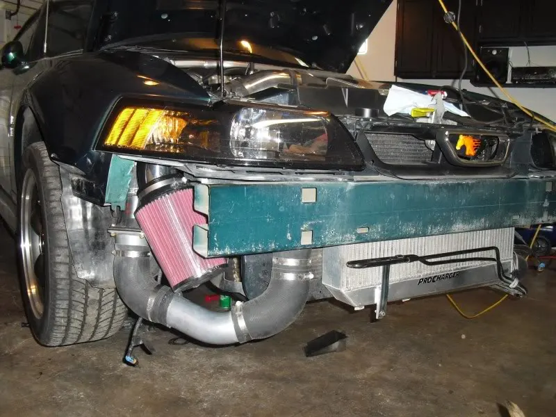

Test Fitting the upper pipe

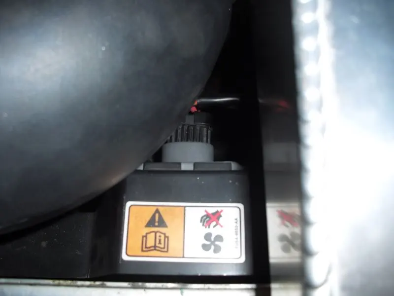

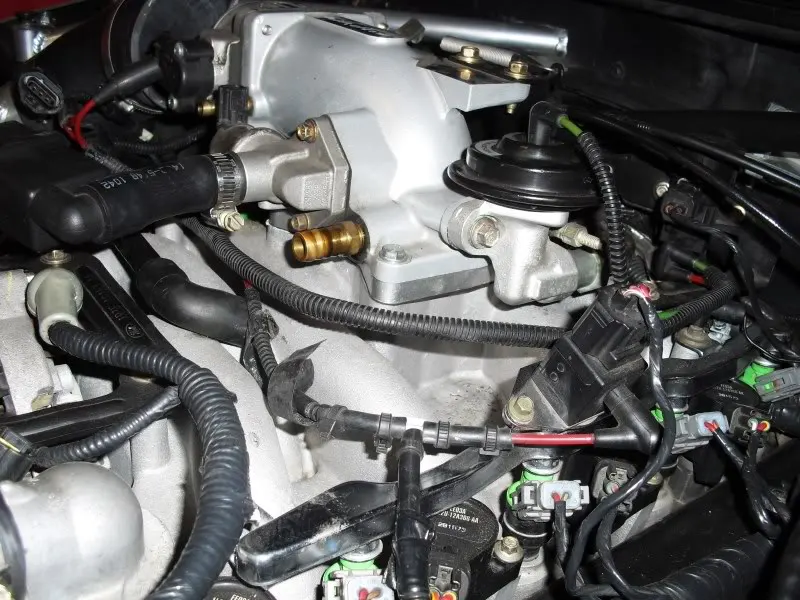

Had to flip the coolant sensor for more clearance

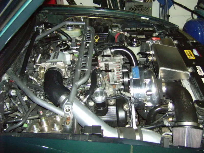

All done..
Oh yea also slapped on a free intake spacer..
Great install Pics, I'm looking into the Power Pipe as well so please keep us posted on what you were able to get out of all of it #'s wise. One Question though are you going to move the fan controller or just modify to make room for the inlet elbow on the Procharger?
