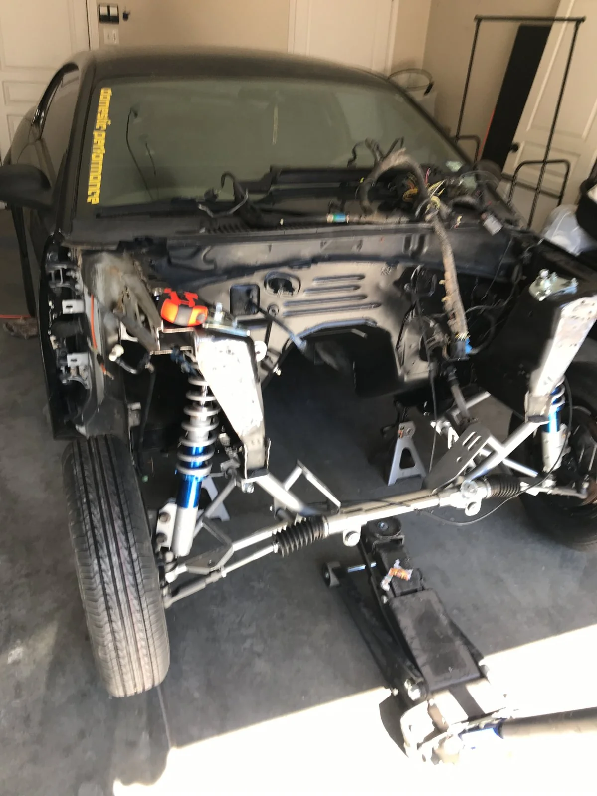

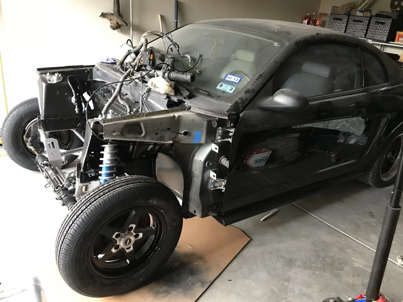

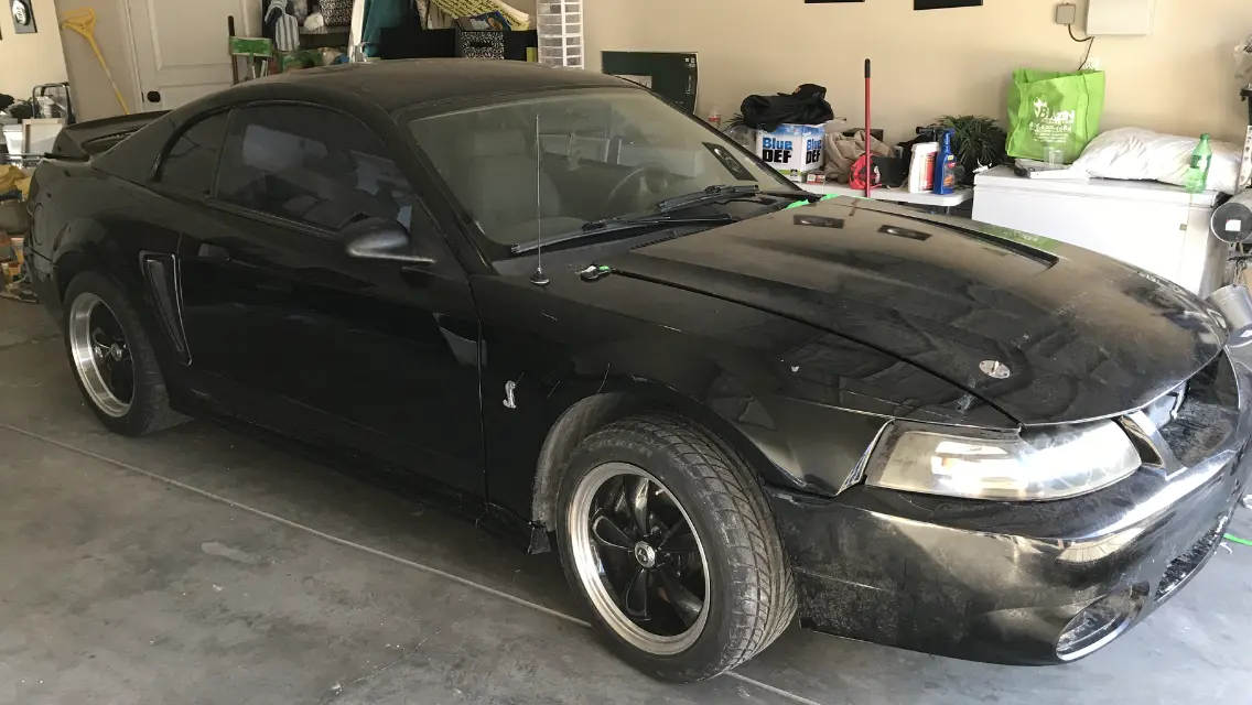

Have a 99 cobra that started life as an actual cobra. Now only thing to tell it is a few points like VIN and badges. Everything else is GONE. 668ADFF4-BE3E-45EF-9613-E7202BE8F4B0.webp

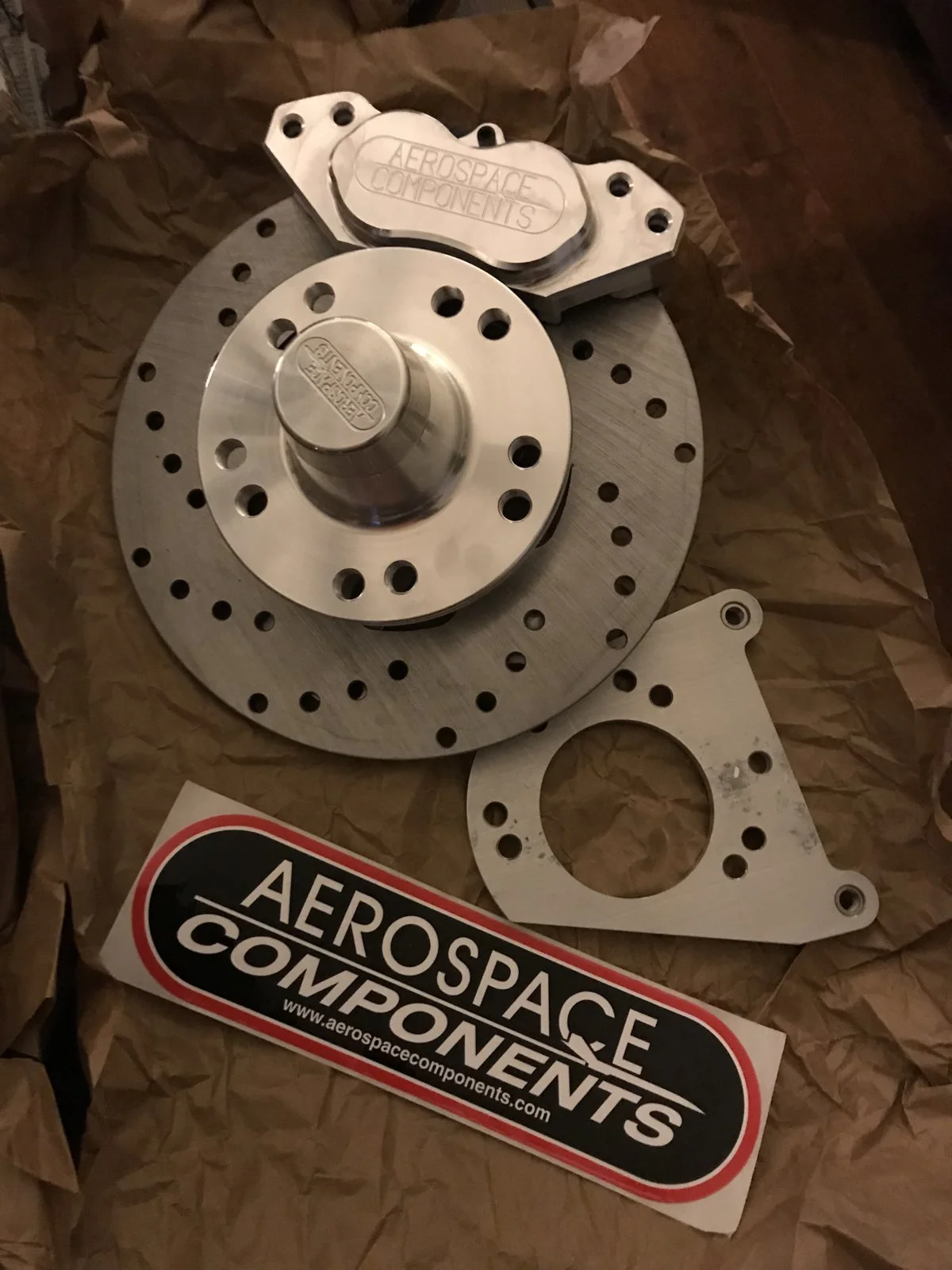

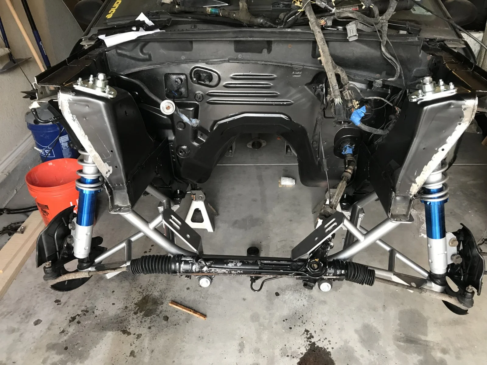

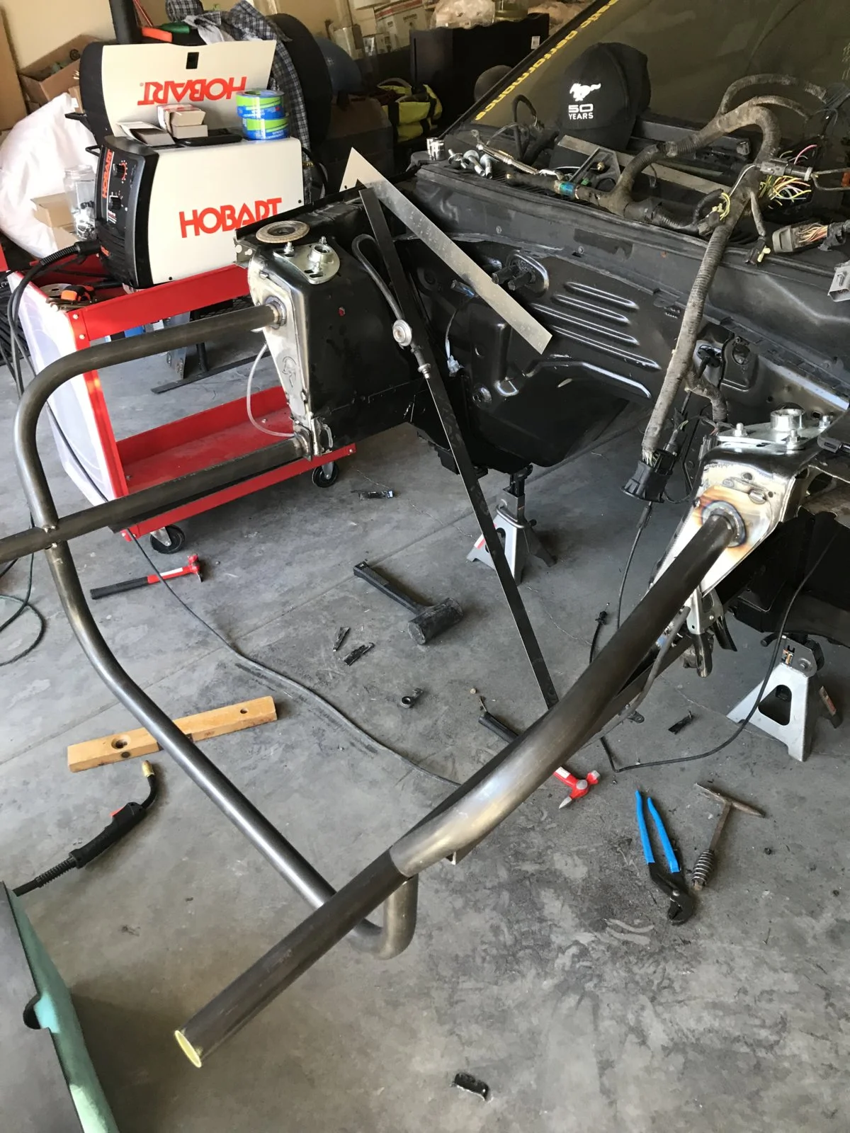

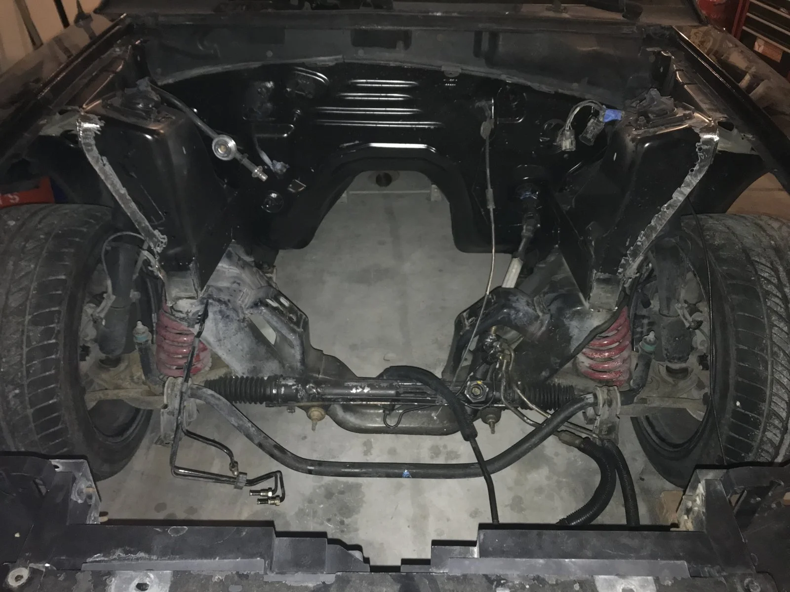

Since basically everything on the car has been swapped to Fox Body parts, I am looking for spindles for a 87-93 fox. Why? Well the K member is a UPR that will accommodate a BBF motor mounts. And with the aerospace front brakes I have I am needing the Fox body spindles. Out back has a Fox Stramge 8.8. Fully adjustable upper and lower UPR control arms.
