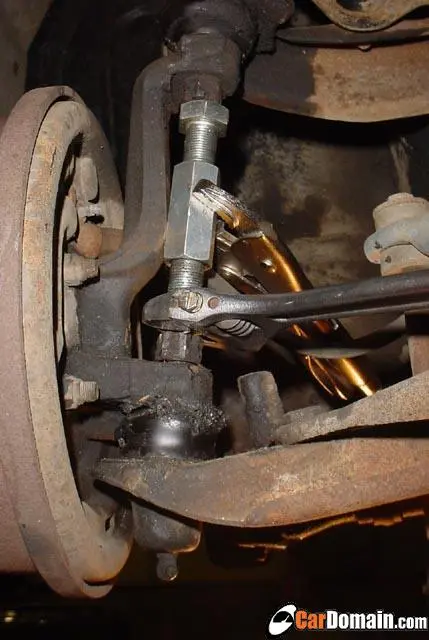

Okay, i'm getting my butt kicked with the front spindles. I can't the get the upper control arm separated from the spindle. The darn thing is stuck. I have sprayed with penetration lube, beat on it for an hour with a tie rod remover and hammer. Any suggestions because this is really holding up progress on the front.

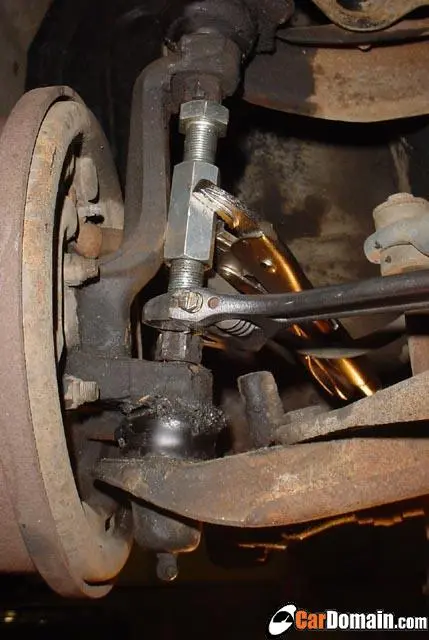

You might consider making a ball joint separator like this, it's just 2 bolts and a rod connector from the hardware store...
I made this back when I was removing alot of spindles at the junkyard and with this tool I got the process down to 20 minutes a side for complete removal...
68Restoman
Saweeet! This is what i'm talkin' bout! I'll swing down to the hardware store and pick this up, in addition to a 5lb sledge!:nice:
