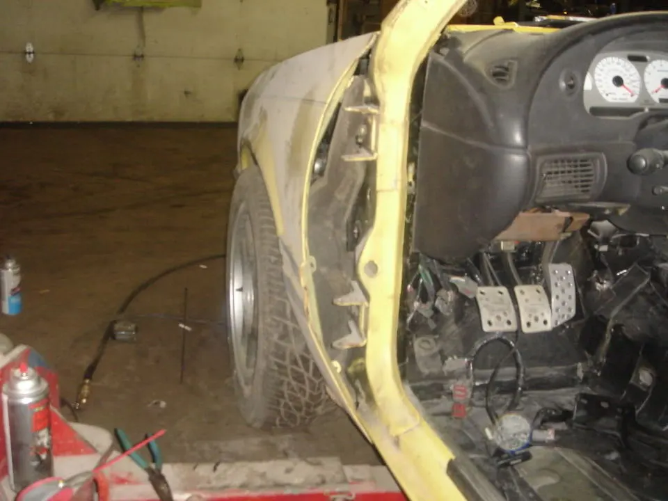

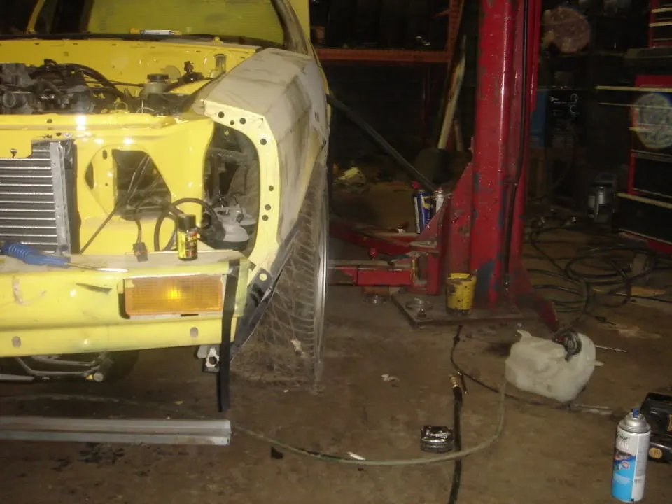

Front: 17X8 30mm offset. STOCK 94-04 style wheels, STOCK FOX LCA's, 96+ spindles:

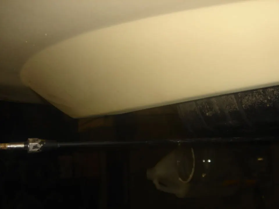

The straight edge test. They DO NOT STICK OUT. They are even.

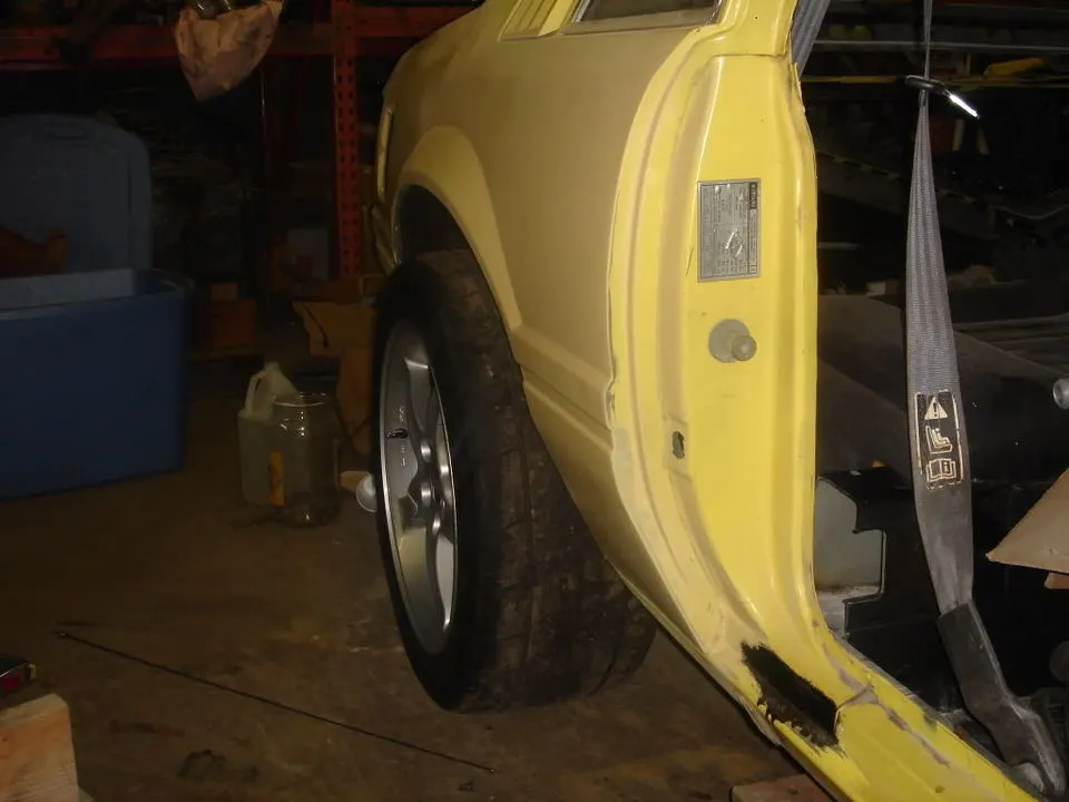

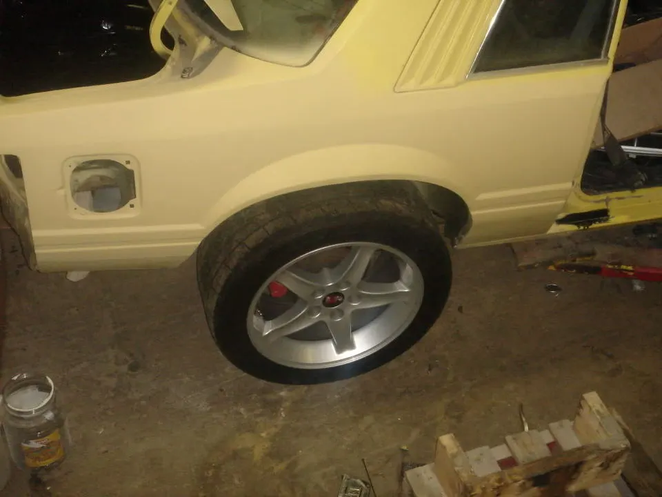

REAR: 17X9 24mm offset. Cobra R wheels Nitto 275 40 17 tire. 1999-2004 axle:
They don't look too bad, but I need to see the car further away, and I need to get the ride height right with all the weight on the car and possibly cut rear springs. The quarter is 29 inches off the ground right now. I need to get it to at least 27 or 27-1/2" like my other notch.

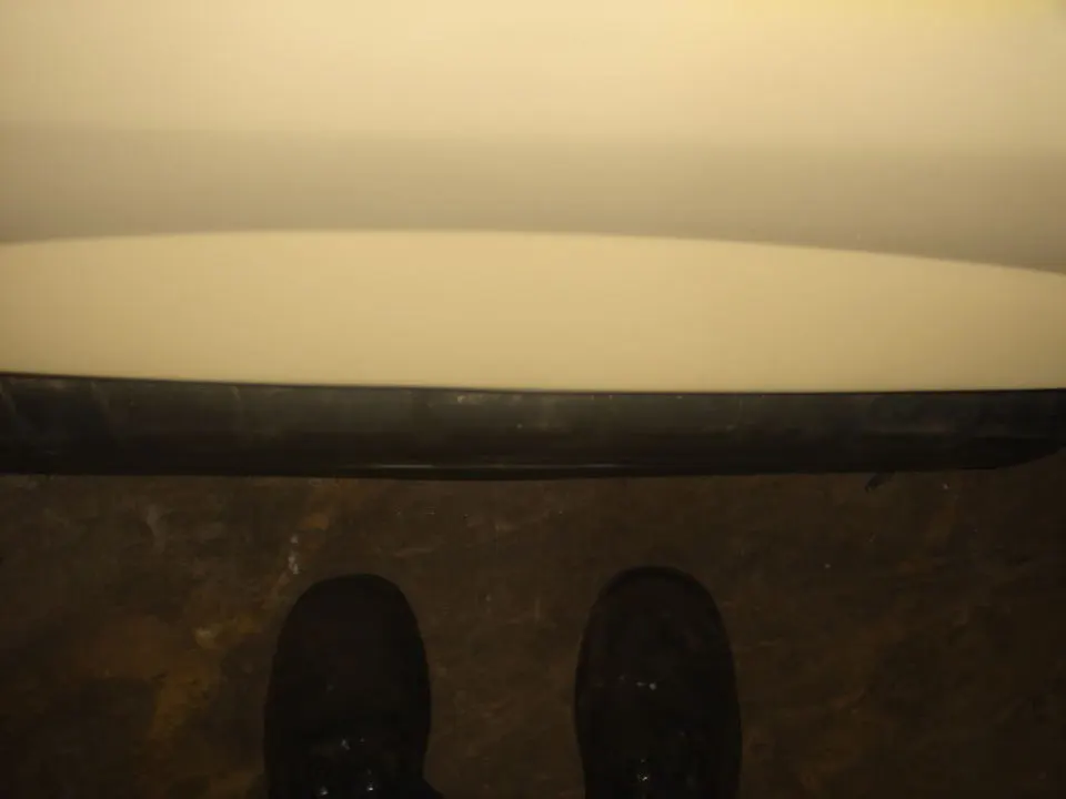

Straight edge test. The tire sticks out 7/8" from the quarter panel.
So....What I plan on doing, is buying Bullit 17X9 S197 wheels with the +45mm offset for the rear. That will tuck the wheel inward 21mm. That is about 7/8". That means I get the 17X9 wheel with more backspacing and it won't stick out, it will be dead even. I plan on buying Bullit 17X8 99-04 wheels with a +30mm offset for the front. As I made a thread earilers, since they are replica wheels, they all look the same. If not, Bullit's, then Pony R's.
