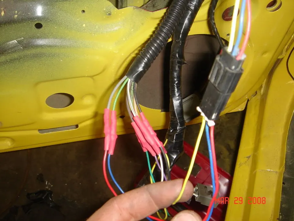

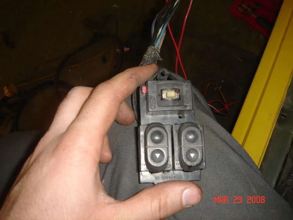

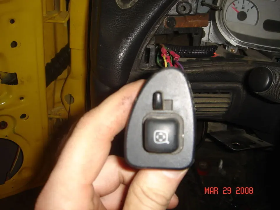

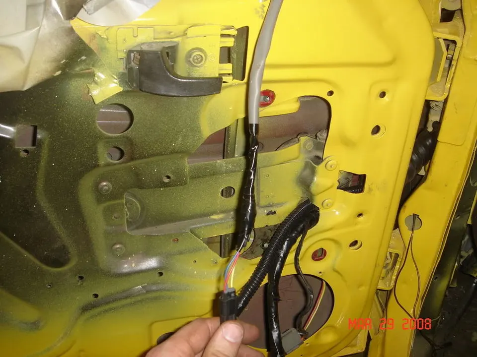

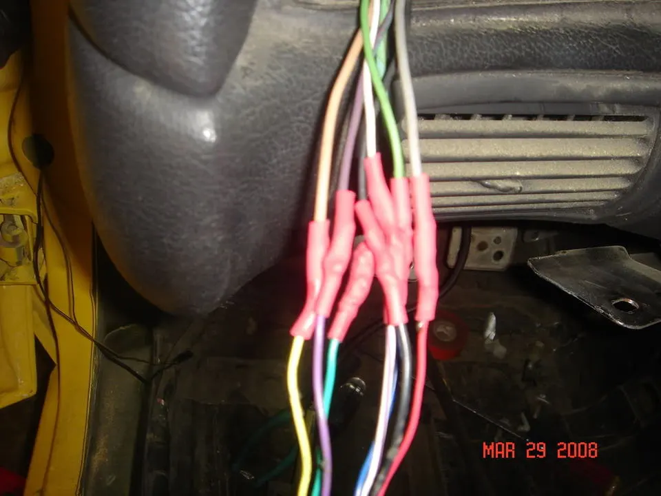

Project 81 Hack Job Weekend PICS***
You guys asked for them. This is what I have done after work today.
I installed the 2001 door harness into the fox body door. I am in the middle of changing the plugs over since they are different. I just got the mirrors working....which was a MAJOR hangup. As you all know the Fox body mirror switch is in the console, and the 94-04 Mustang mirror switch is in the door panel. So......I made another harness and ran it through the door through the A-pillar and through the dash. I am mounting the switch in the speedo bezel under the headlight switch. It looks really trick. BTW..the fox body window switches plug right into the 2001 control pad backing.
Here they are.
And....the CELEBRATION BEER!!!!!!
Okay...back to get the window switch and lock actuator switch plugs changed over...then cleaning up and going home.

Dammit that looks like fun. I'm coming to help

Thanks mang, I needed a break from this moving crap.
I have done wireing for a living and I like the work you did, soldier and heat shrink FTW
