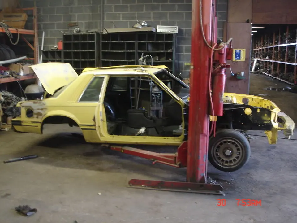

Finally got another chance to work on it and I got pretty far.

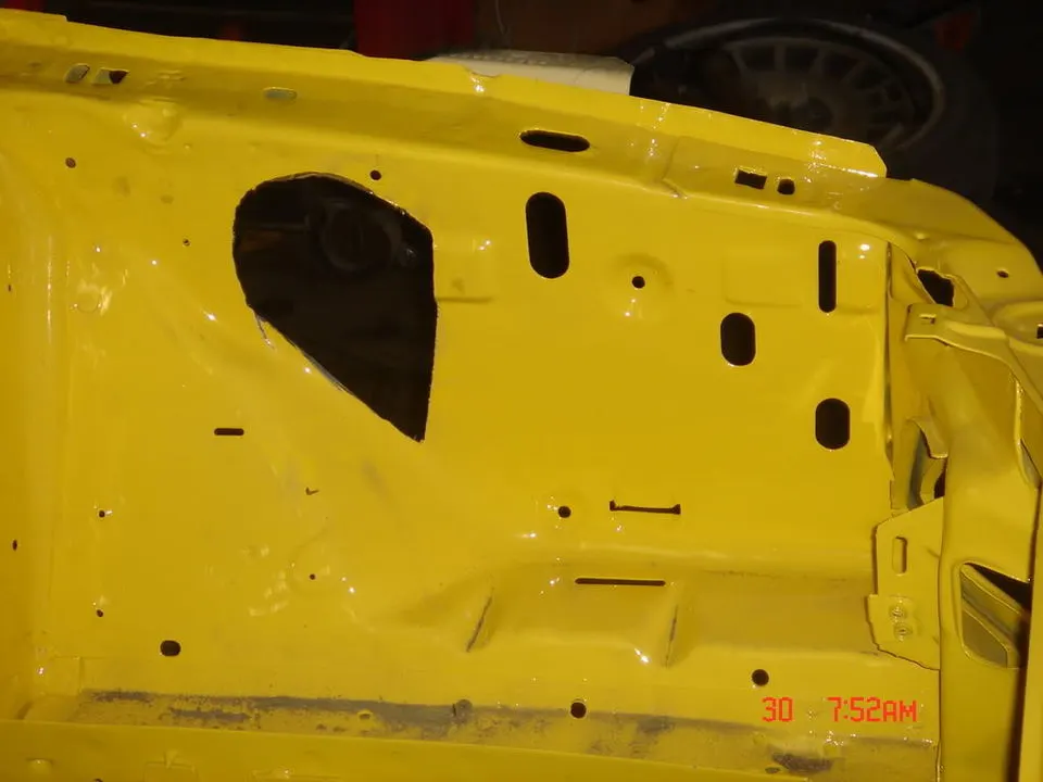

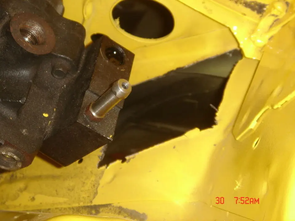

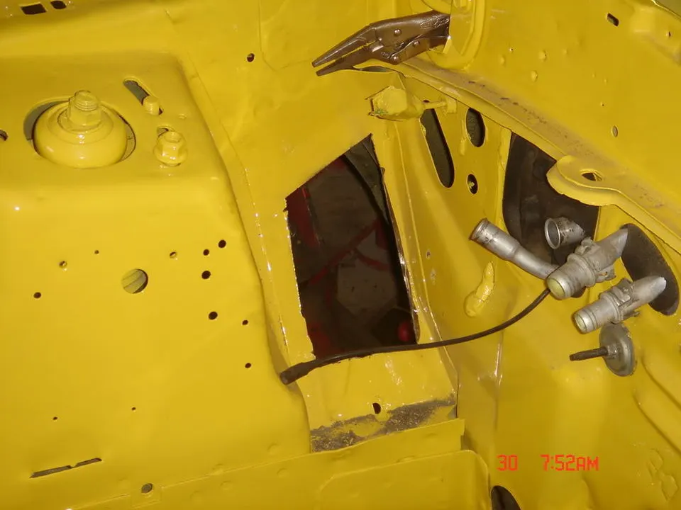

Pic 1..Cut hole for washer bottle and wire harness

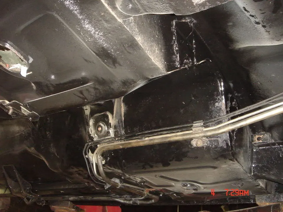

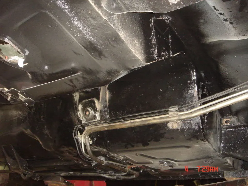

Pic 2...Cut hole for fuel lines and emiision lines.

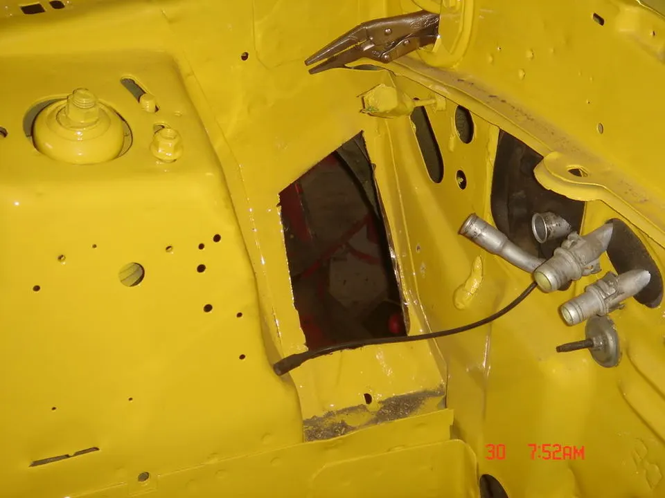

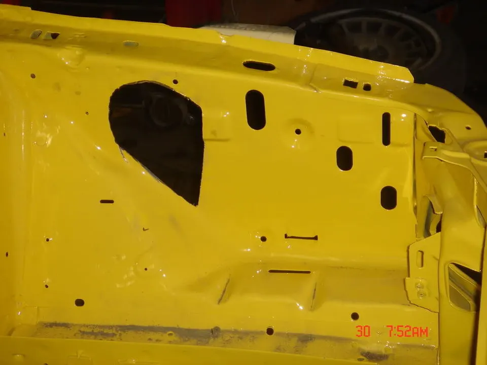

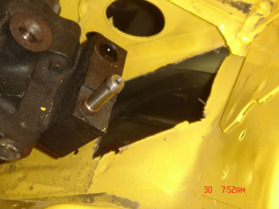

Pic 3..Cut hole for wire harness and cruise control cable to go through.

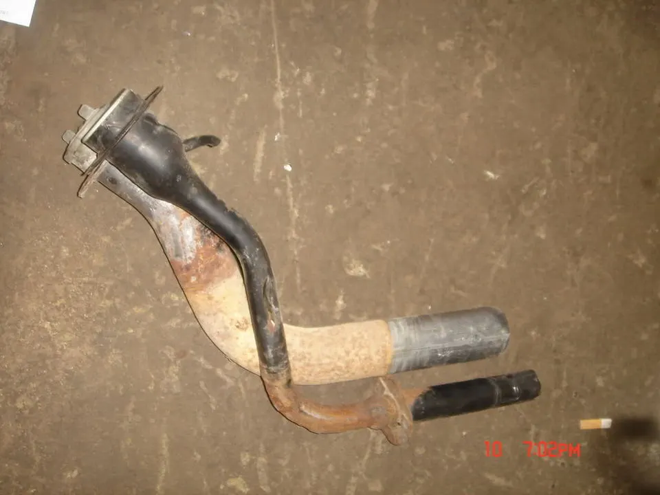

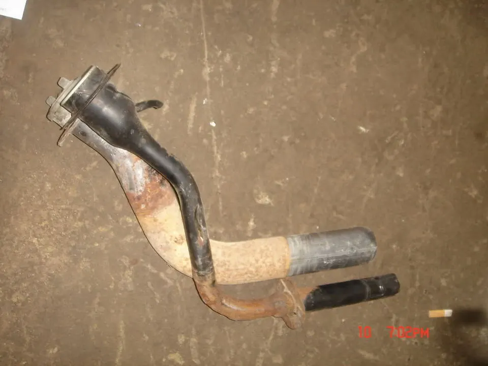

Pic 4...Must cut, trim and reweld gas tank filler neck to fit short trunk depth of the fox

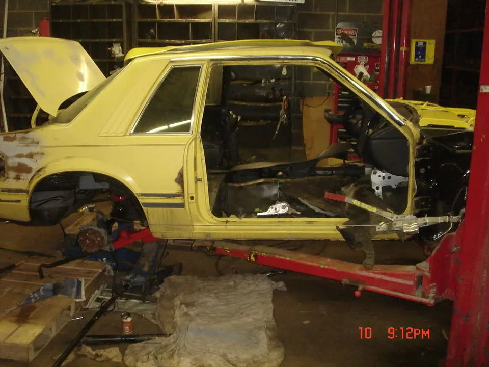

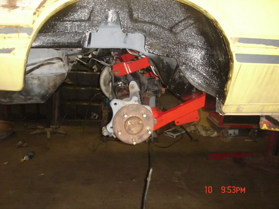

Pic 5...Where did my axle go???:shrug:

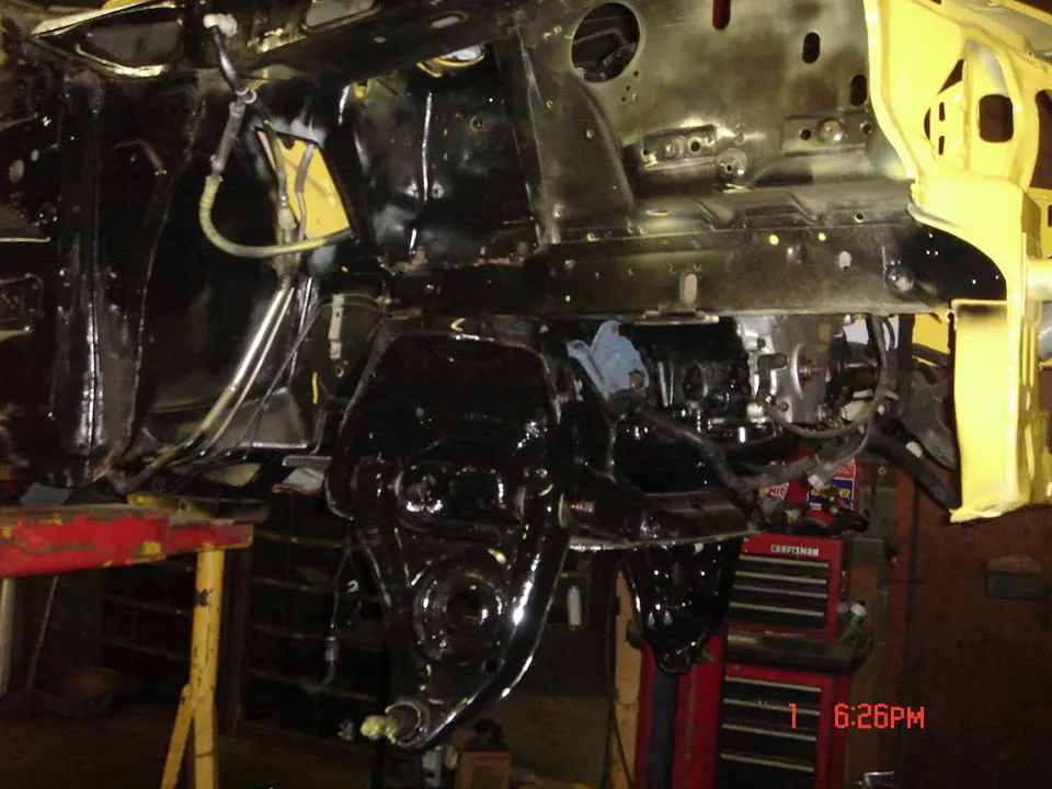

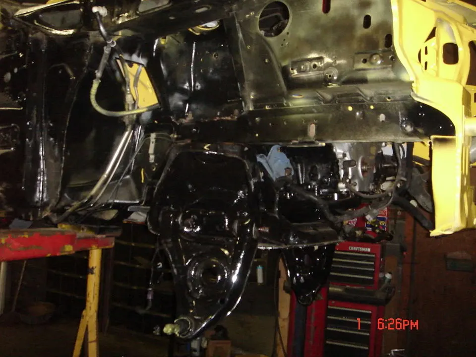

Pic...6 Ahh...the PITA LCA's and UCA's that are as stiff as a brick wall..
Pic 7.....The wheels fit and the 01 axle DOES NOT make the wheels stick out..

Pic 8....Would have never got the axle in with out the good ole come-a-long...
Pic 9....The fuel lines and brake lines fit perfectly from the 01 to the 81

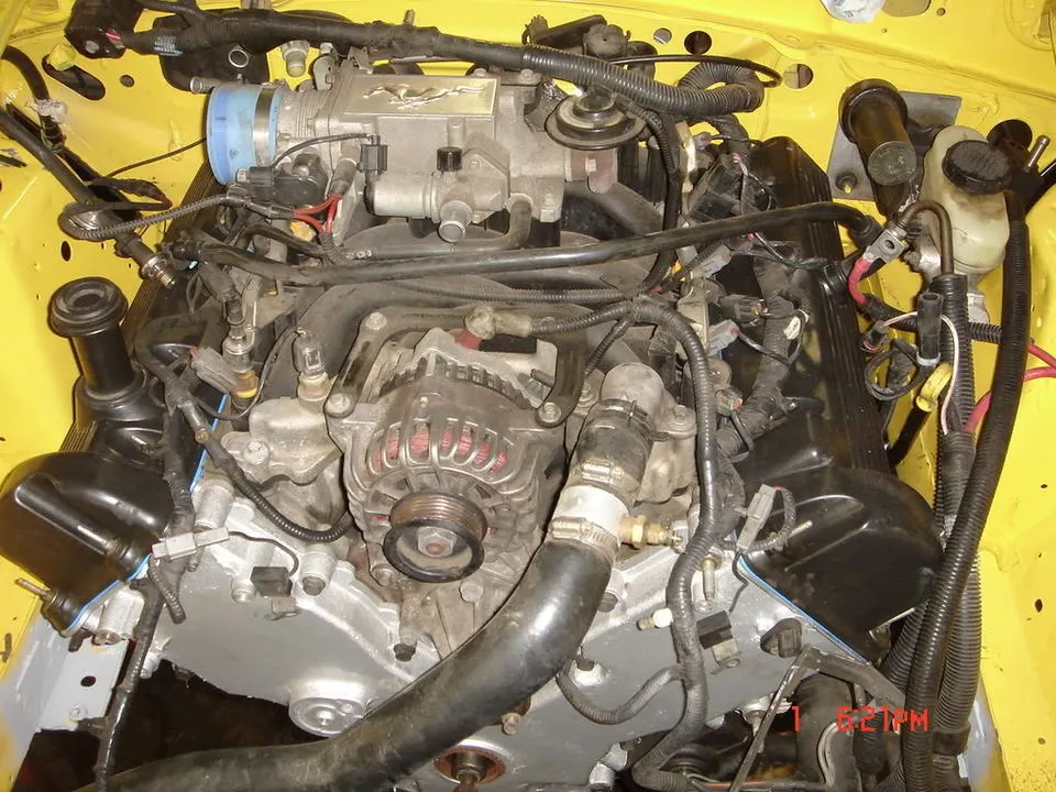

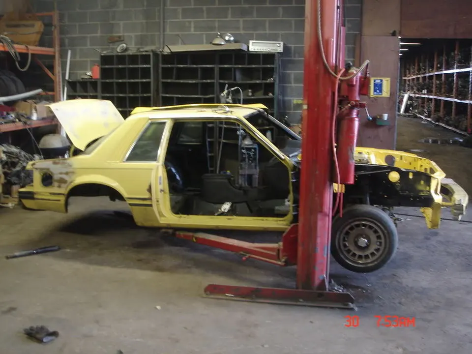

Pic 10...AAAHH The good stuff...motor in and it looks sweet...(Just needs cleaning) But I already have new motor mounts, new exhaust manifolds, new studs and bolts, new valve cover gaskets, timing gaskets, harmonic balancer, new oil pan and gasket....soon to come...new hoses, fluids, and tune up...(when it runs)
Pic 11.....Front suspension is in as well...New bushings and ball joints, New motor mounts.
That is about it....All is going well...The axle was done 1 evening after work....the lines and motor trans, and K-frame was one long day by myself, and man I was beat after that.

Front engine view
http://i184.photobucket.com/albums/x258/svt32vdohc/DSC03689.jpg
