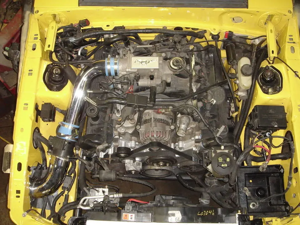

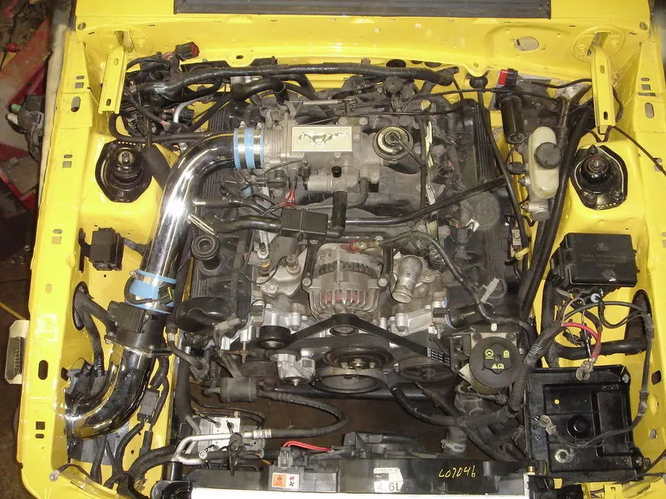

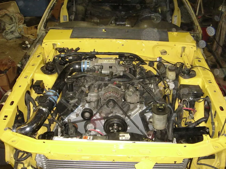

Front engine view

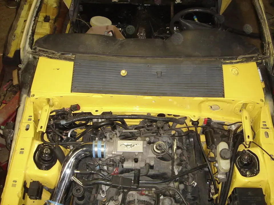

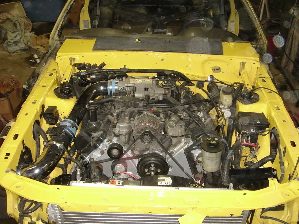

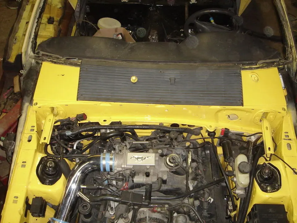

Overhead engine view
Back of motor, cowl, dash

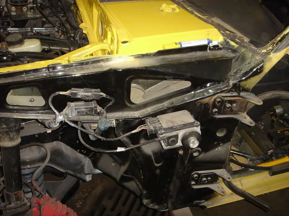

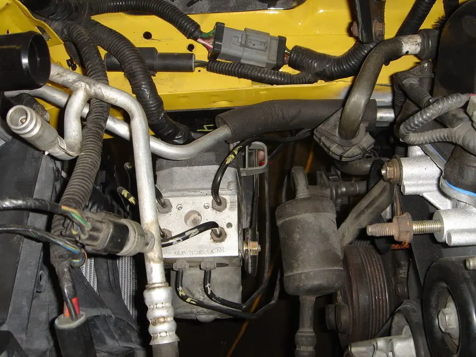

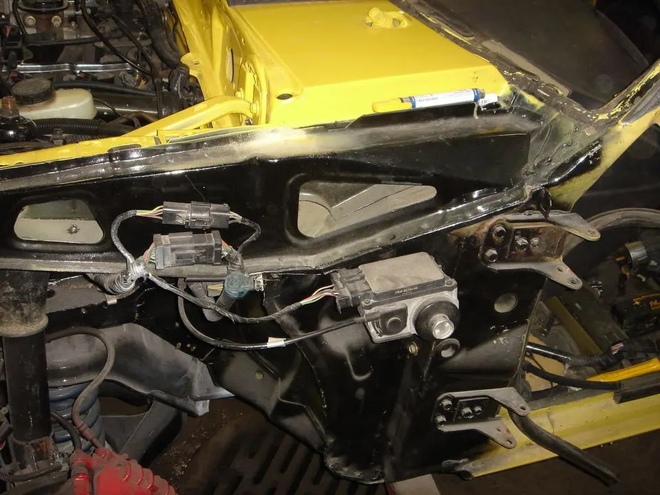

ABS and traction control in a 1981 Mustang...yes!!
Cruise module

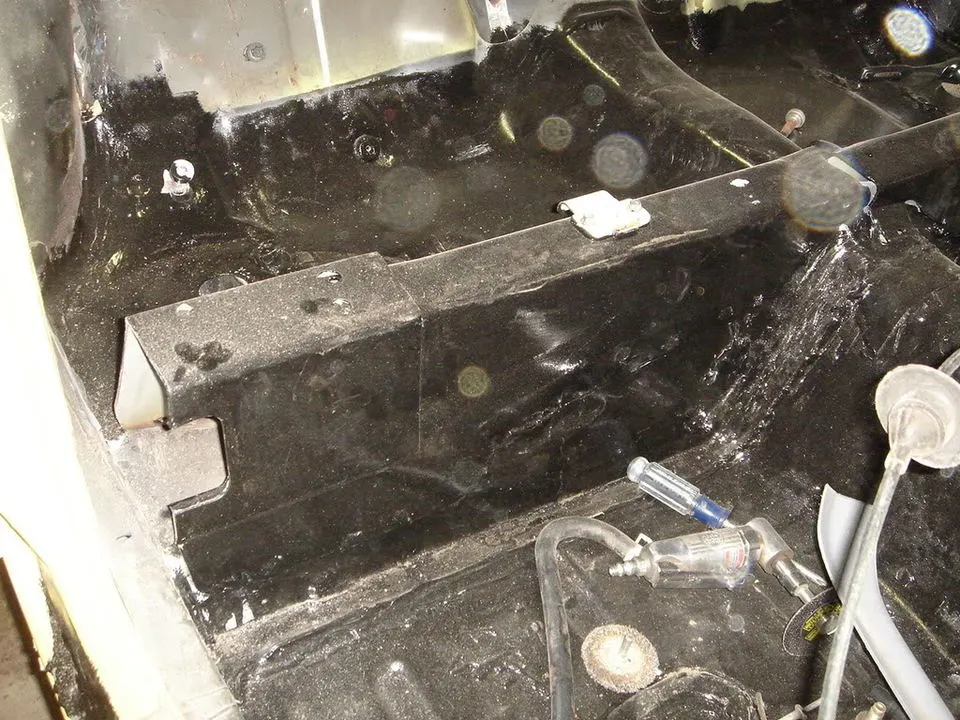

2001 rear seat brace welded in to fox...lots of work!!!!!!

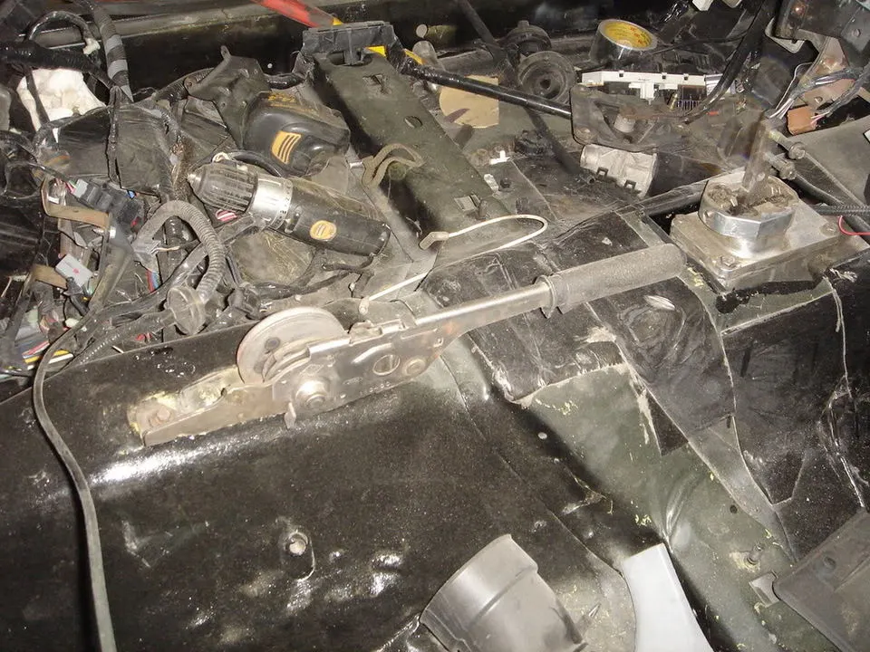

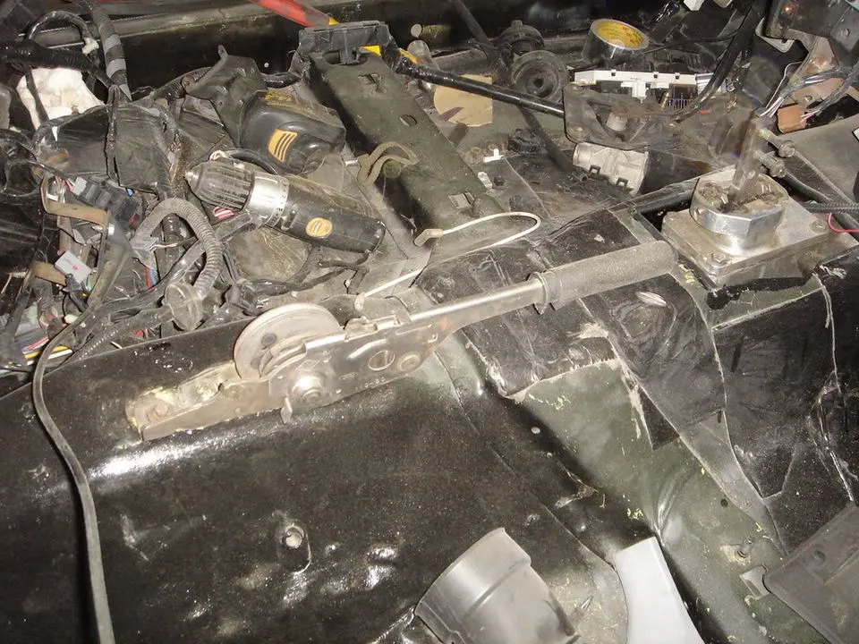

2001 E-brake handle, 2001 cables and all brackets under car.

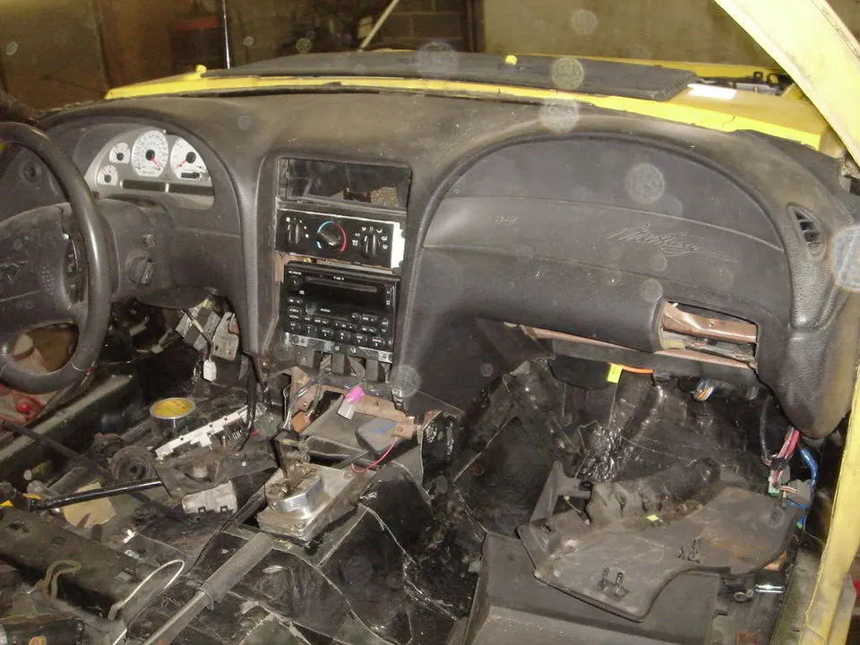

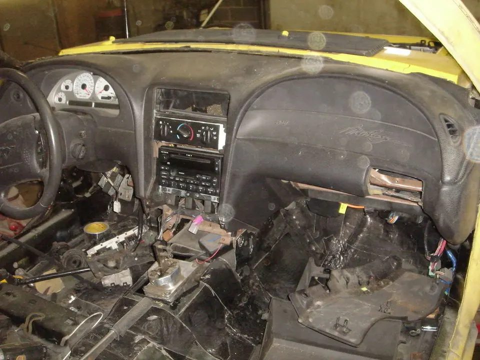

2001 dash shot. Airbag fit perfect. Still gotta get odds and ends put in.

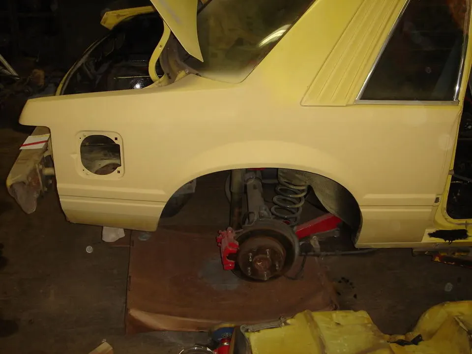

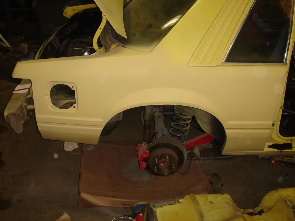

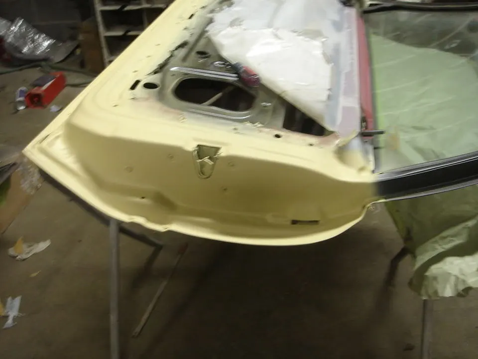

Remember that ugly RH quarter?? Well, this after body work and 1st coat of primer. I am gonna block and prime the entire car a few time when it's all togehter

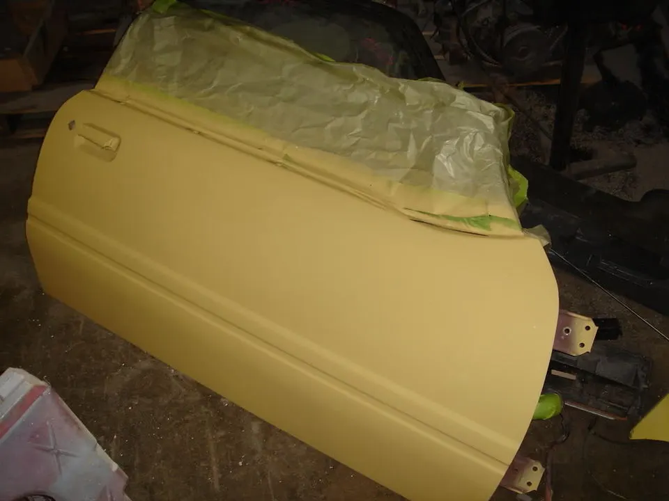

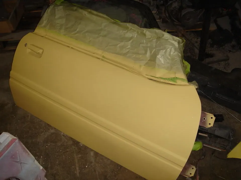

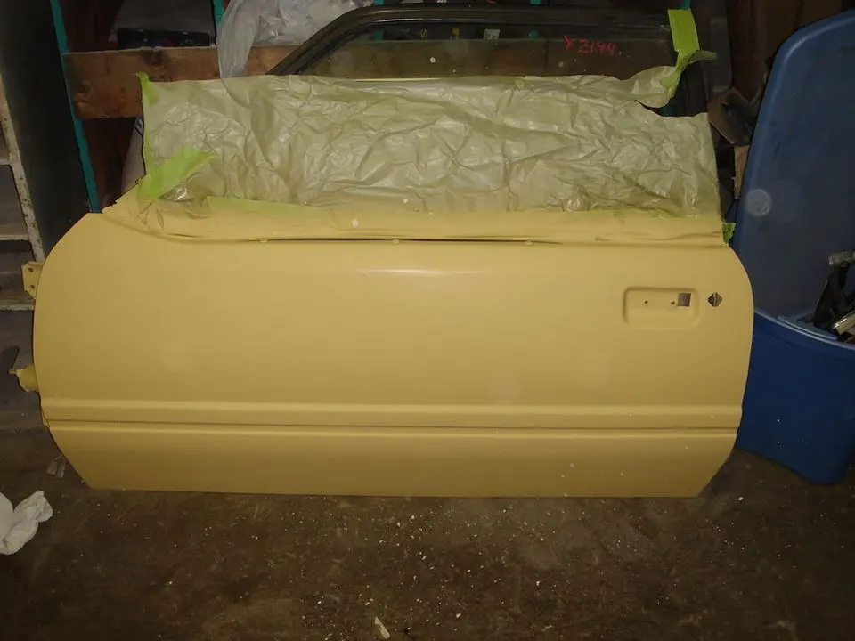

RH door

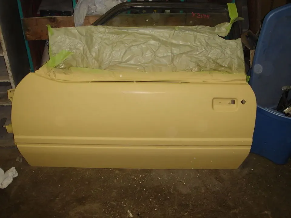

LH door

2nd...The shifter bezel fits great. I am using the 2001 console as well, and I mocked it in place before I welded the the brackets in from the 2001. This was a tricky task, because you needed the gap between the dash and the console to be nice. I got it good the day I did it. It gave me touble the other day while trying to mount the E-brake and hook the cables up, but the bottom of the dash is not bolted down, so I narrowed the problem down to that. Ford was nice for leaving such large holes in the brackets. This allows much room for adjustment.

ive got more of a technical question for you....how are you going to get the ABS to work? is it just going to be rear ABS or 4 wheel ABS? unless i missed somewhere and you already said you are using the brakes and spindles and whatnot from a later model
i think he is using the newer brakes all around
Correct!! I am using everything from the 2001. Lines, wiring, everything!! There is nothing fox body about that car....but the body!!:D
I have all the stock sensors in place, and they run along the fox body perfectly, just like the 2001 car. The fuel lines look like they were made to fit the 81...even though they are 20 years newer!! I just had to modify the left rear quarter well to fit the evap canister back there behind the wheel. I wanted to use everything stock, so I don't have any issues trying to get it running.

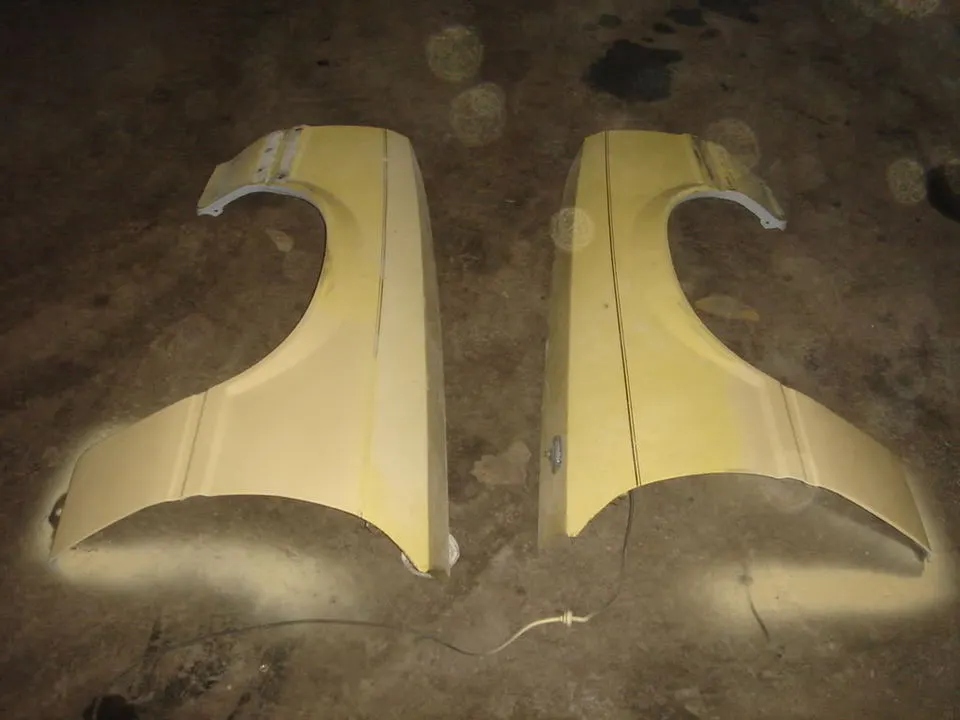

Here is some stuff in 2K primer for now....
