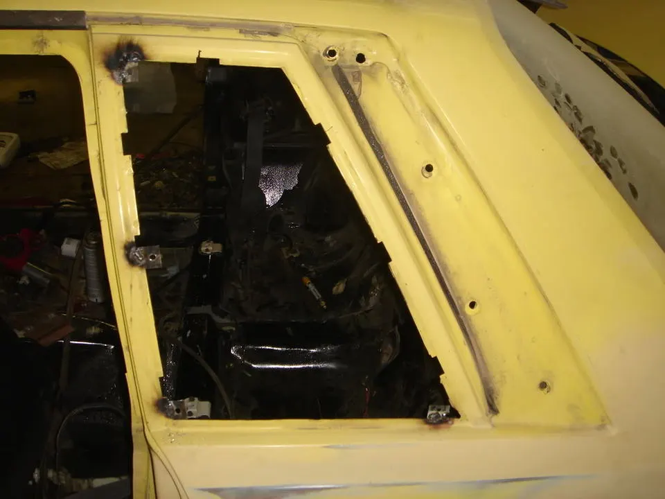

More pics.

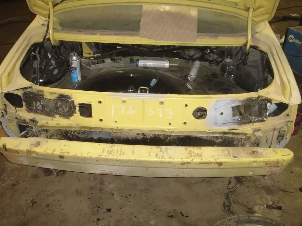

81 tail panel will not allow 87-93 lights to go it. Make one big hole and remove some of tail panel and weld in new metal so the panel can accept sockets and bulbs. The two middle studs have to have something to bolt to as well. (The ideal way is to weld a 87-93 tail panel in, but I'm not going through all that, and the seal fits good.)

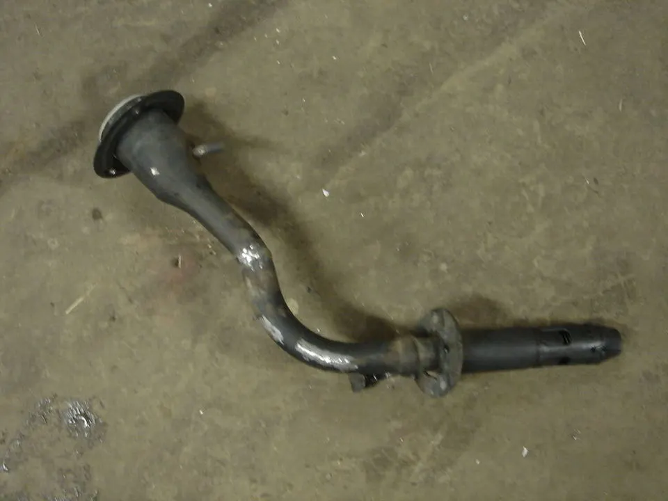

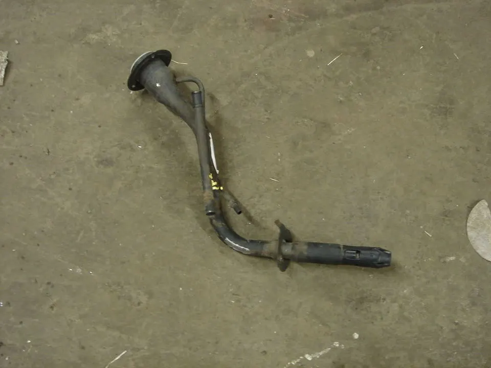

2001 gas tank neck is too long and has the wrong angle. I cut a section out, turned it and welded it.
BEFORE:
AFTER:

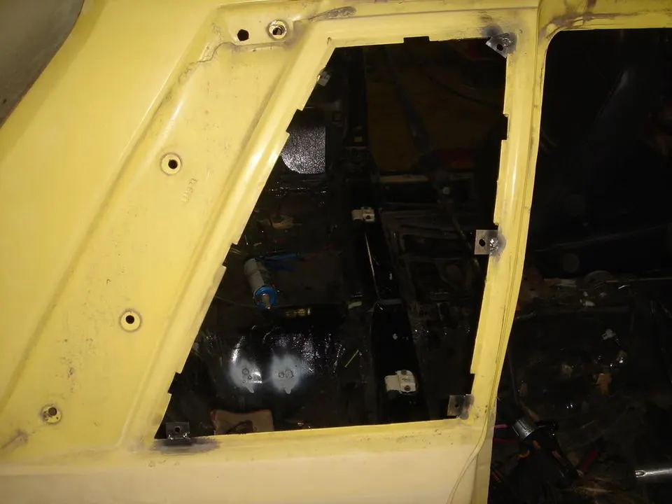

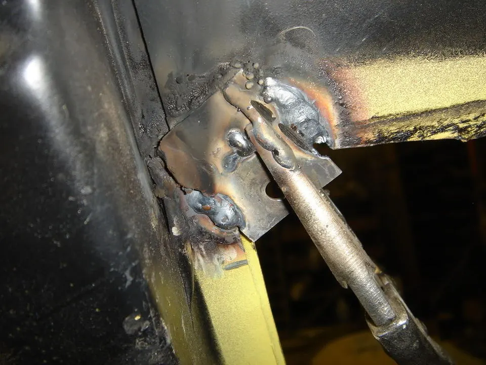

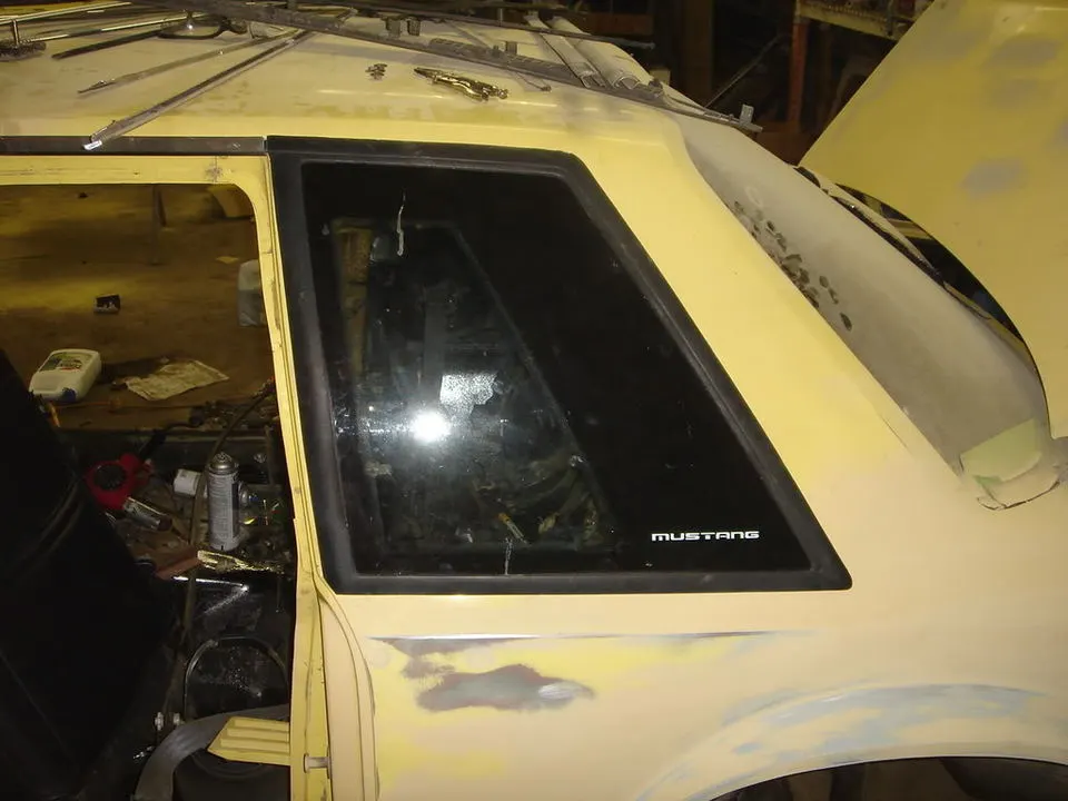

Old style cars have the early quarter glass. In order to put the newer ones in I had to drill one hole on each side. I also welded tabs on the car so the studs have something to bolt to. I know they use buetel tape to seal, but I wanted to have something to draw them in when I install them to insure there are no leaks.
Don't weld your Vise Grips to the car like I did....I need a new welding helmet I can't see crap.
And finally...mocked in are the 87-93 glasses.
Well...time for lunch and then back to work!!!!!!!!

Just keep modding/fixing/building...it just takes time, practice, trial and error. I still make oops' on every car I build, we're human. I mean look at the pic where I welded my Vise Grips to the car!! HAHA That was so funny I had to take a picture...then grind them off.

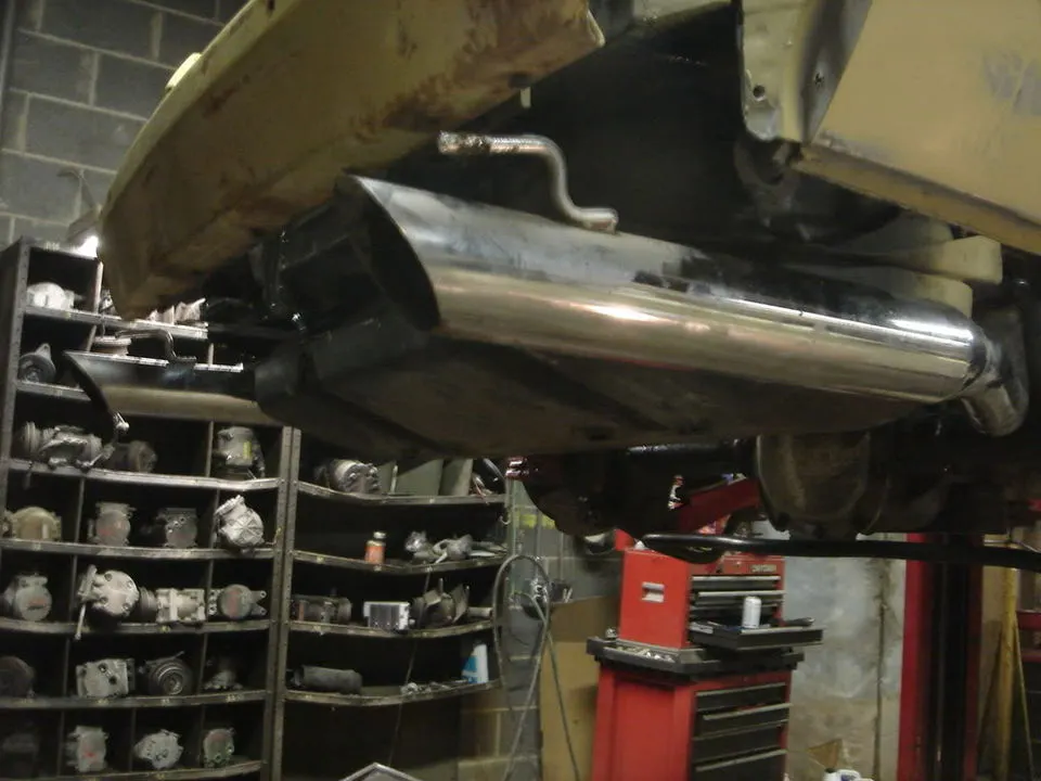

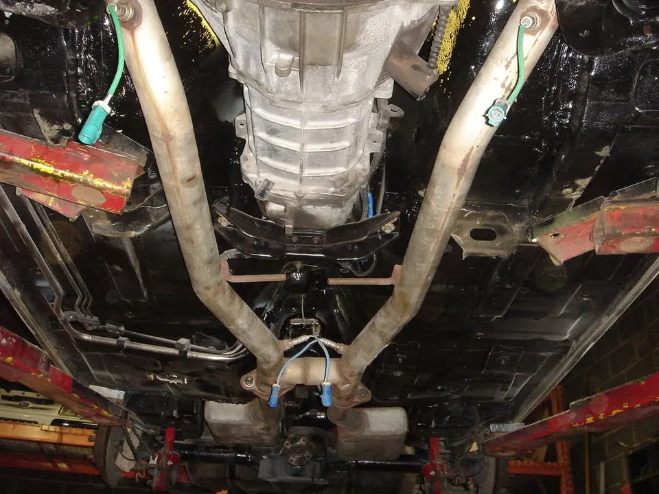

Guys....the car sounds amazing in person. 2001 4.6L SOHC engine. Stock manifolds, BBK O/R H pipe, MAC 2-1/2 cat-back with 3" tail pipes. And it fit just like a fox body exhaust did. No problems what so ever. I have to readjust the tails, but that is when the car is completely finsihed. I need to get the bumper on and the tires and wheels to see what I need to do with them.
MORE VIDEOS!!!!
No tail pipes. It is just dumped over the axle.
With tail pipes. Sounds amazing in person. I think the video might sound fuzzy.
