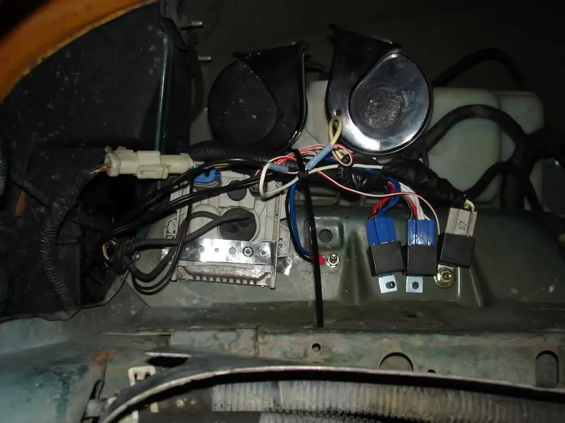

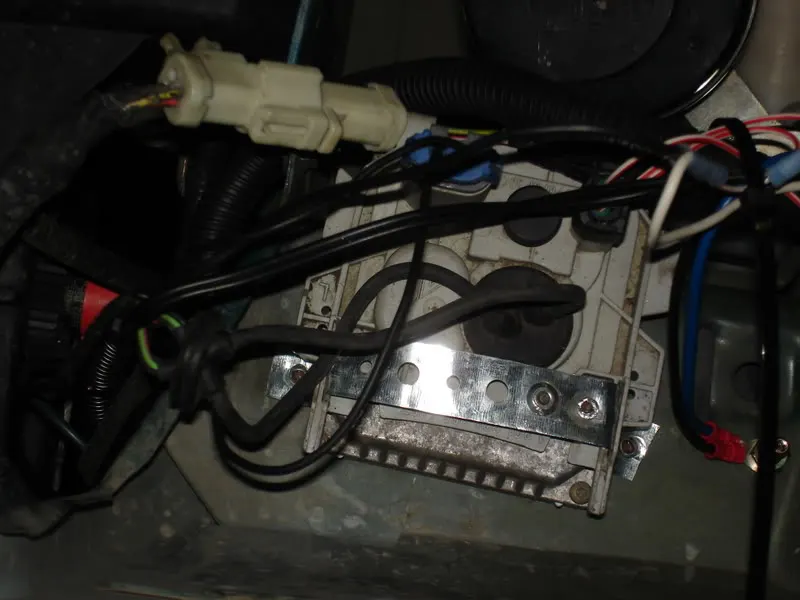

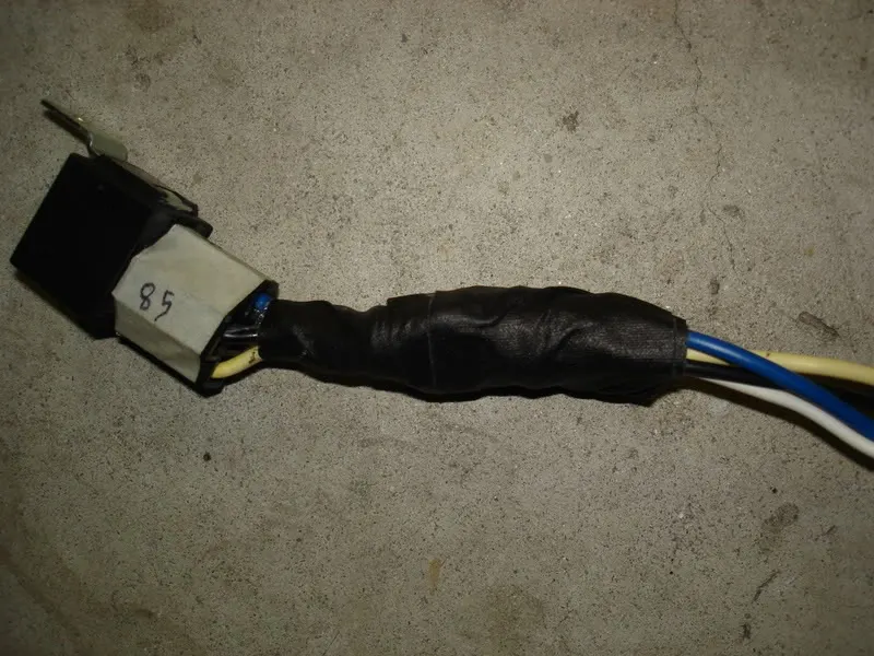

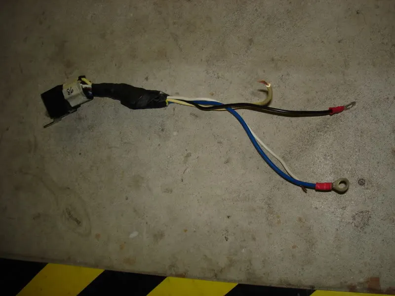

Well sorry for the wait Had interenet problems I got the bright wiring harness hooked up the flash to pass works, but brights don't I think I need to redo the harness to make sure it working ok.
I still haven't adjusted the project in the housing. Haven't had much time due to thanksgiving.
All I know right now is that It will get fixed , They drain my battery quickly when my car isn't running ,and they are bright.
I'll try and get some more pics uploaded.

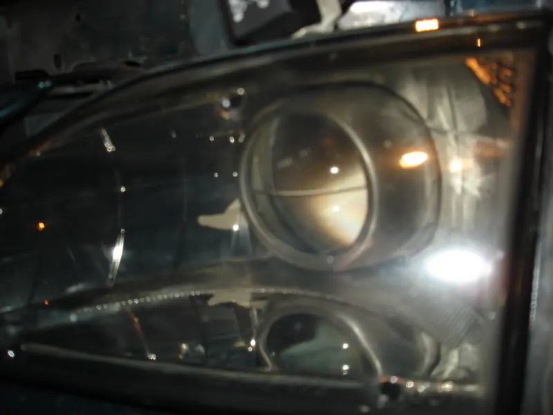

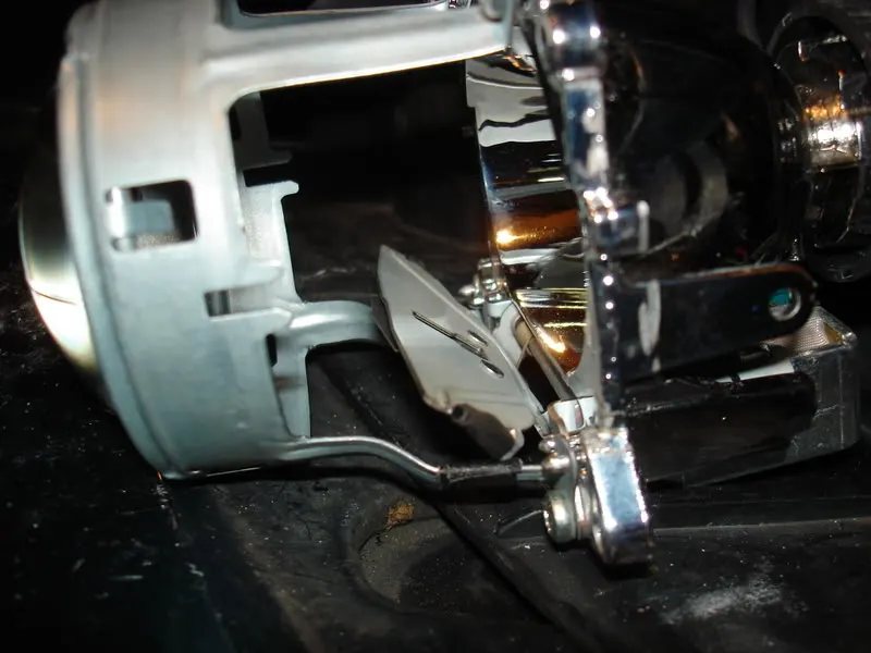

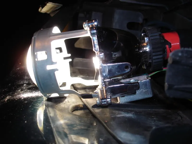

I've got the next 3 days off so hopefully I'll finish. Heres some pics til then.
Heres with the brights ON open shutter but no light

How come so many relays? Awesome job man!!!!!
Bosko5.0
May 18, 2006
1,067
37
longwood, FL
Nov 28, 2007
#27
  • Nov 28, 2007
  • #27
2 are for the power to each light then the third is for the highbeams since they can,t hold 12v.

I was under the impression that HID's only consisted of the bulbs and ballast.. i didnt realize the good kits had an ignitor as well.. and for the life of me i couldnt understand how the cut off worked if the bottom half of the light pattern was being blocked, why wouldnt the top half have light.. I see that to switch to hi beam mode the little cutoff door just folds down. Am i on the right track or completely off? haha
I think the projector was upside down in that picture. The open flap would allow the light to shine upwards more to give you high beams.
Someone correct me if i'm wrong...
you are correct. The flap is suppose to be on the bottom. the cut off of light is due too the reflection created by the housing itsself, not the one i made. When the brights are on the beam raise from the cutoff point to a higher cutoff point.

I bought them off ebay for $287 they are e46 hid lights the kit included: 2 ballast, 2 igniters, 2 ds2 bulbs(true HID bulbs), and 2 projector, and luckly no cut wires

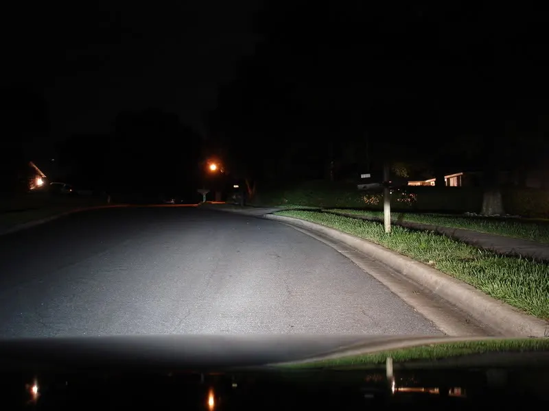

Well after refinishing my Hid the day I left for Carlisle I never got to take some night pics So heres a couple.
Heres just lowbeams with a nice cut off.
High beams
And here it low beams on the street.
Highbeams on the street.
And here is a fake hid bulb kit that I had before. high beams
notice the difference!
I would have had finished them sooner but got into accident in dec. and busted the drivers light up, hid housing was fine but the projector got bent some So I had to purchase new projectors. and was running around with smoked corner, yellow faded headlight, brand new head light,and old stock corner, I did that for a couple months. but All is good.

IM in the MINORITY on this one, but we are a forum of opinions. I think that is a LOT of time, effort and especially MONEY for a non power, non cosmetic mod. I just read through all the posts and it seems like a big hassle to make the road a LITTLE brighter.. Just my opinion. Respect the dedication though.

Well the hardest part was remembering how i ran the wires. they do help alot, and when I get out of work it is always dark plus its easier to travel at night due to less traffic.
