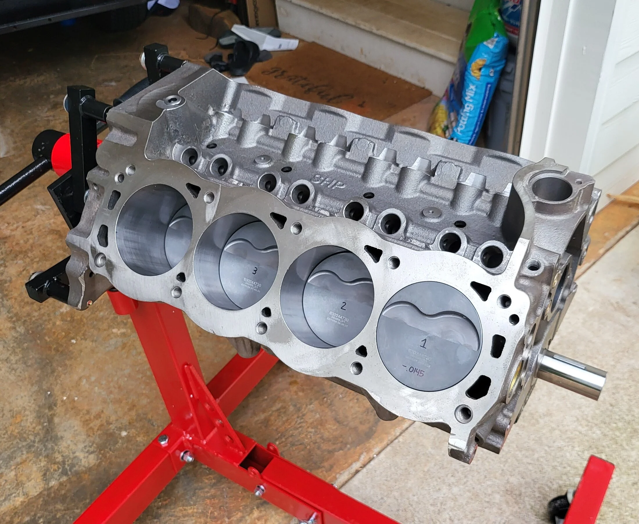

I pulled the trigger on an eagle competition rotating assembly yesterday and have a machine shop lined up to get the block in spec and balance the rotating assembly. I ended up with a 347 kit like my 92 car I had before. I went this route partly for nostalgia and so I will have more wall to cut into if I ever damage the cylinder walls. I should have the engine ready to go once I get the car back from the body shop but it will probably still be a wait for the transmission.

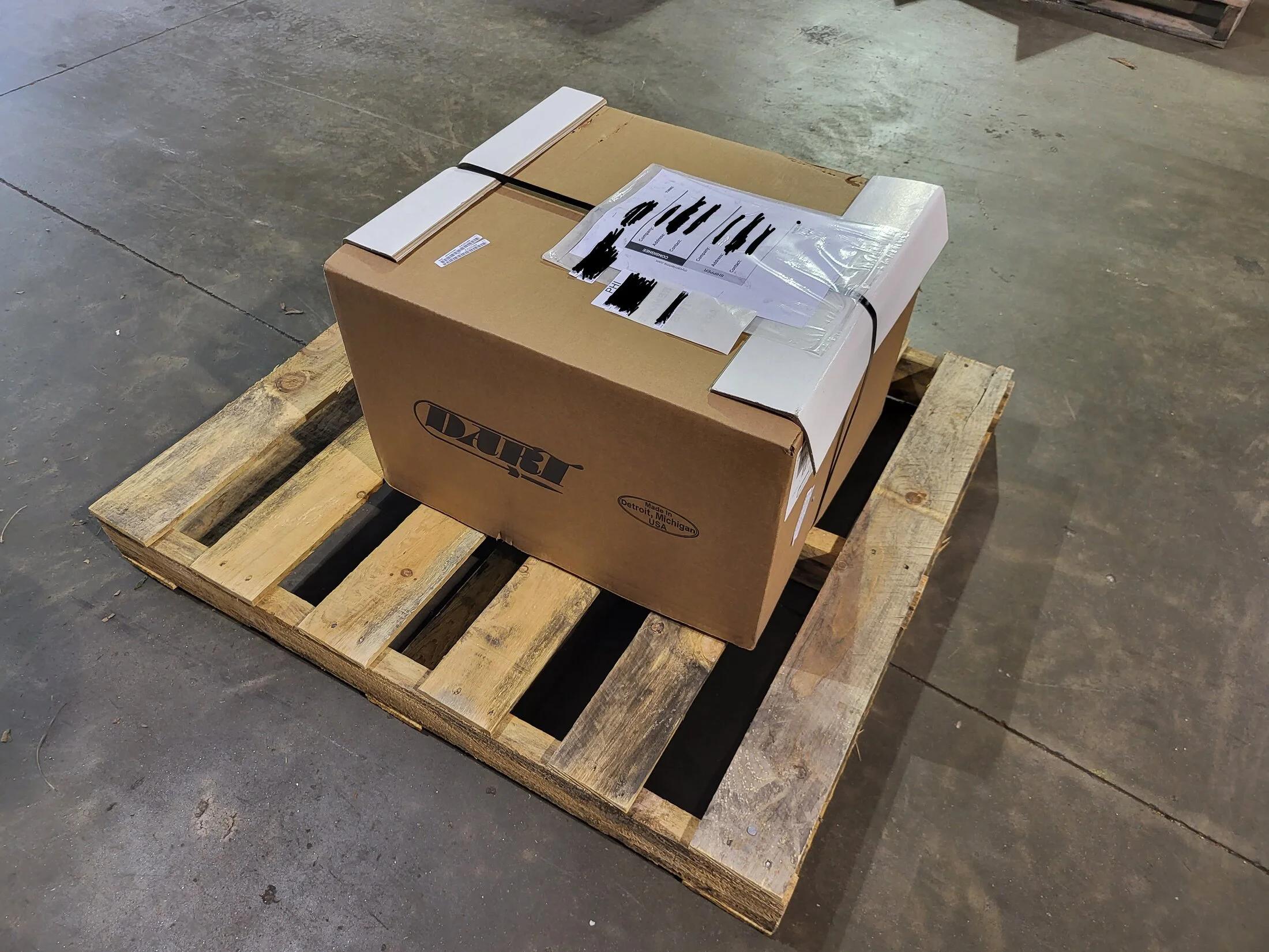

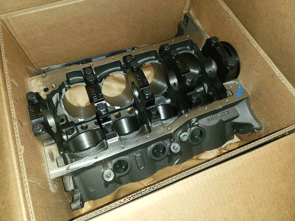

The dart block I ordered early this week from Johnson Engine parts has already arrived. I also received the rotating assembly today as well.

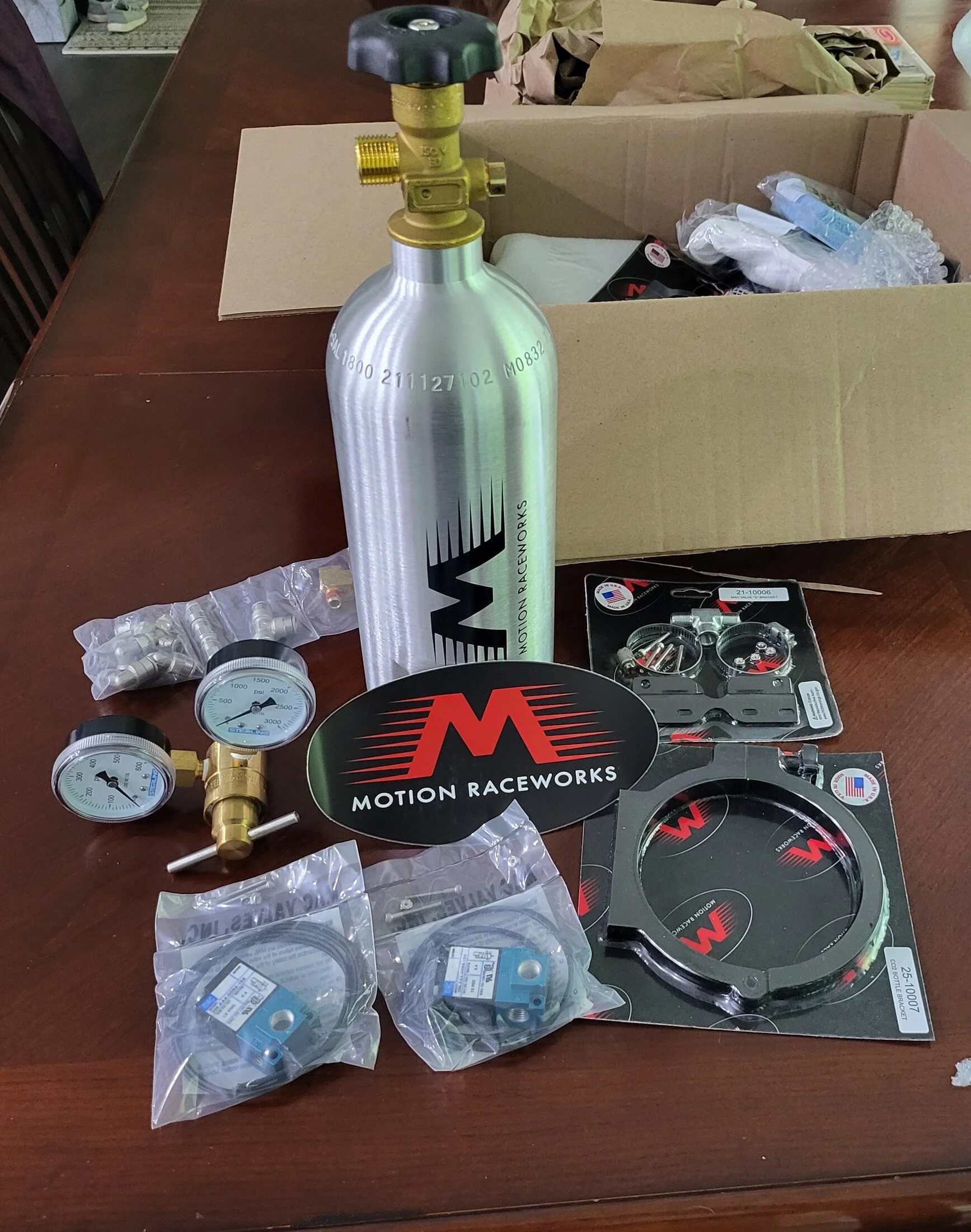

I am going to run boost control by gear with the terminator x so I picked up this CO2 tank and mac valves. The tank will mount on the cage behind one of the seats.

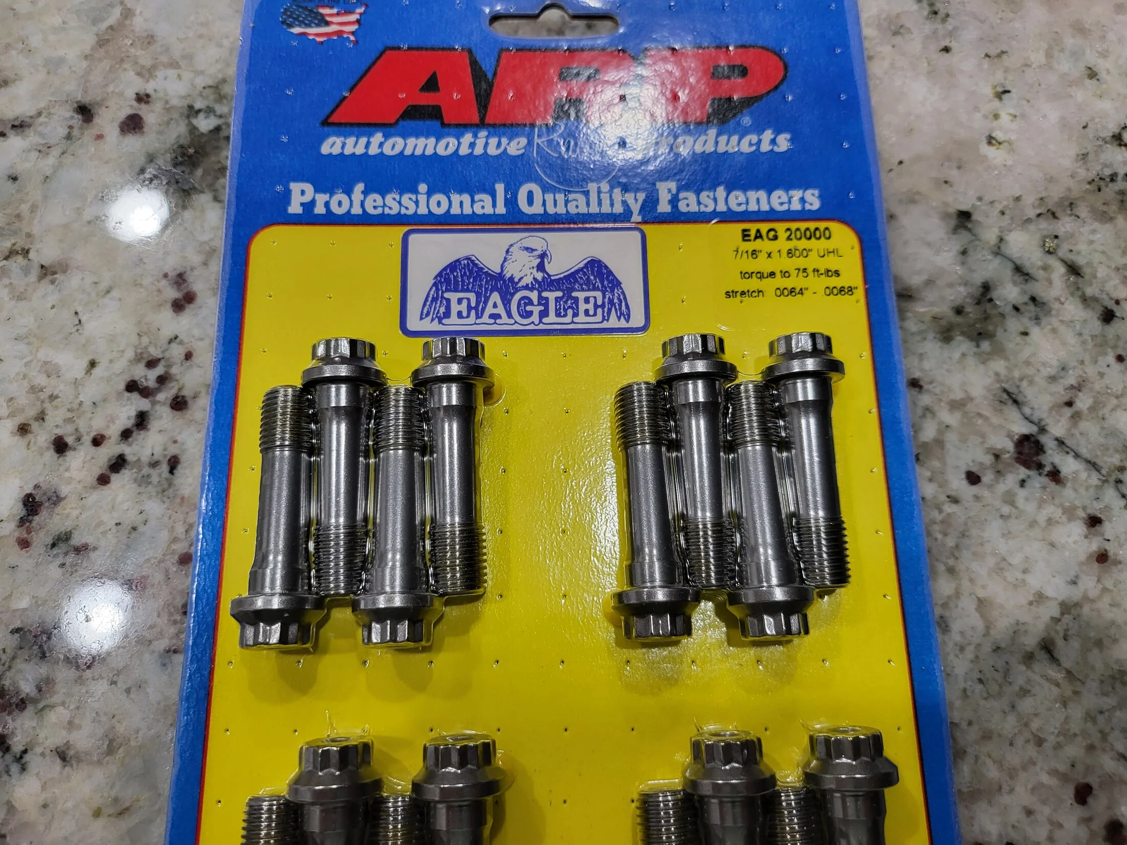

The rod bolts are supposed to make the rotating assembly go from being rated for 750 to 1200.

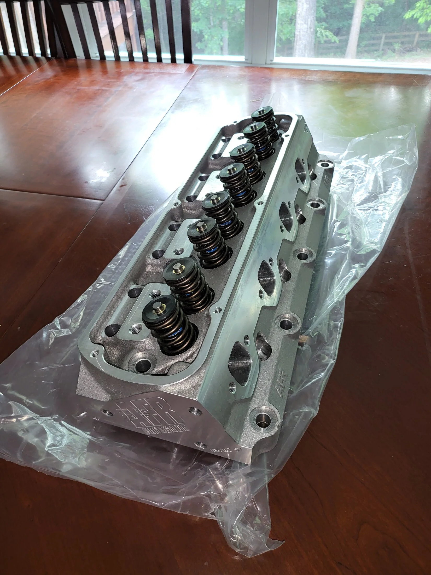

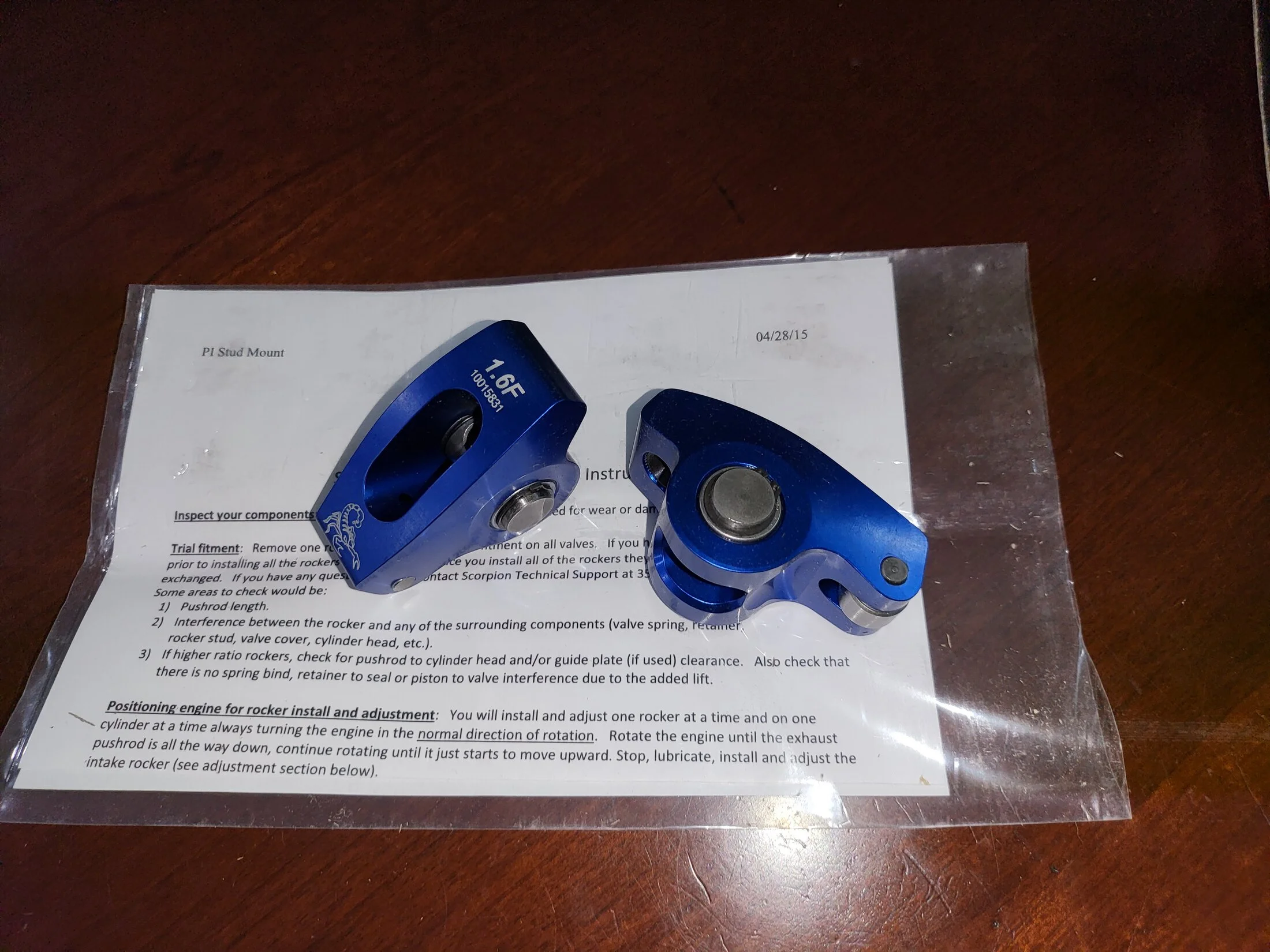

I ordered the heads and roller rockers last night so I have everything for the build now besides gaskets and the pushrods that I will measure for later.

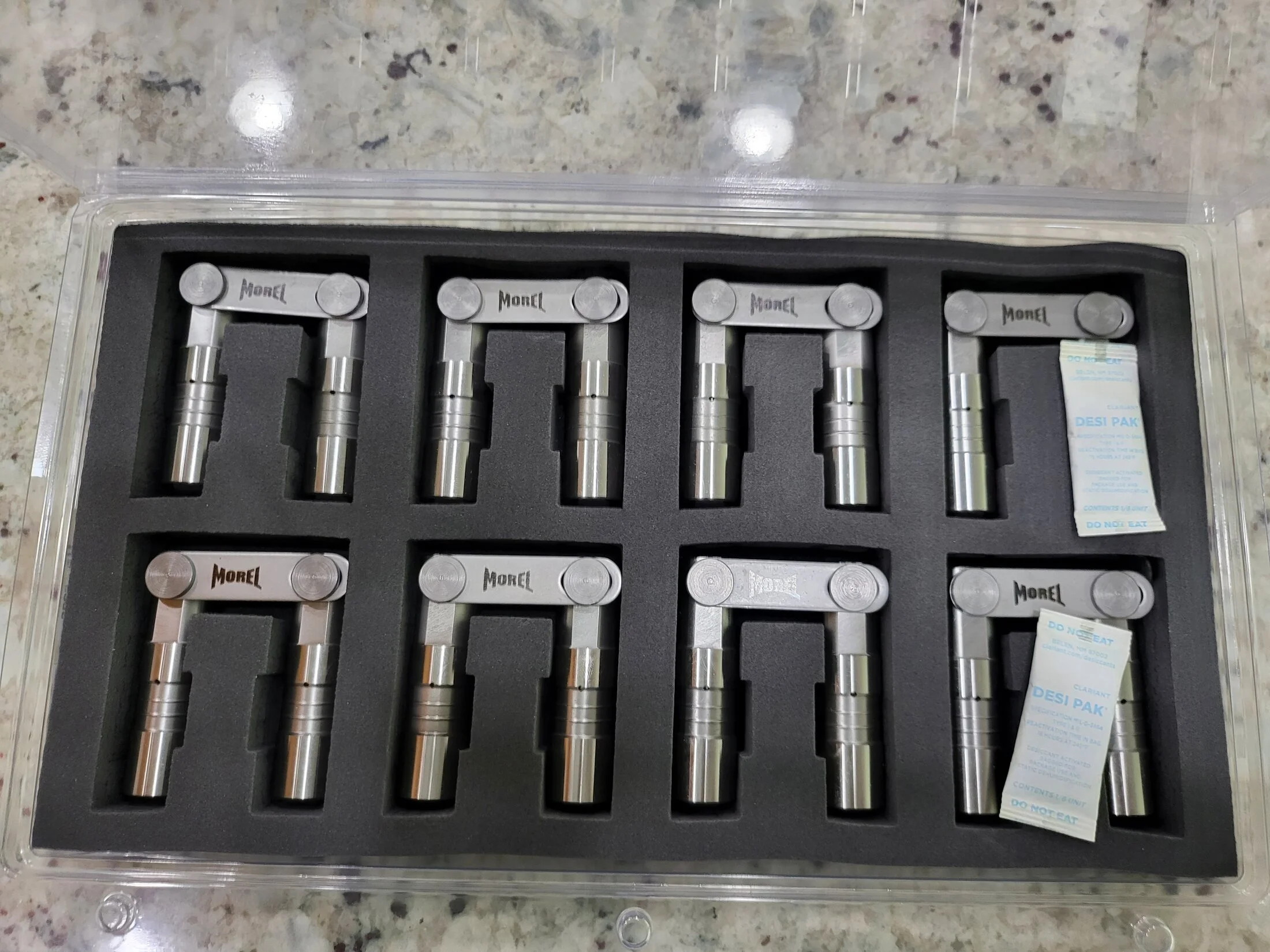

The Morel 5323 lifters showed up. I am dropping them by the machine shop tomorrow to check the lift bore clearance. The dart blocks ship with the bore on the tighter side and these are a little wider than stock. I should have everything back in a week or so.

After talking to the guy who is doing the body work for me it sounds like I won't have the car back for about 2 more months or so. I just got the call from the machine shop that my block and rotating assembly are ready to be picked up. I plan on going to get it today and assembling the engine over the next week or two. With that in mind should I get an engine bag or something to keep it in while it is sitting waiting for the car to come back? Is there anything else I should do considering it will be sitting for 2-3 months? I also have about 2 1/2 more months until the transmission is ready.
I put a 306 together and just taped up the exhaust ports, lower intake ports, and any other holes. Bagged it and it sat in the shop for about 6 months before it went in the car and had zero issues. Left the engine oil out and dumped that in and primed it before it went in the car.
