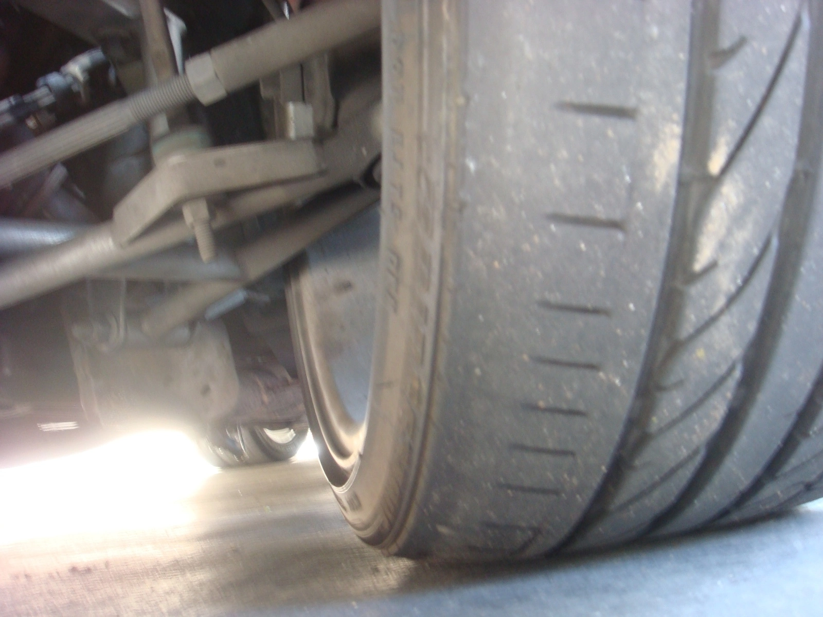

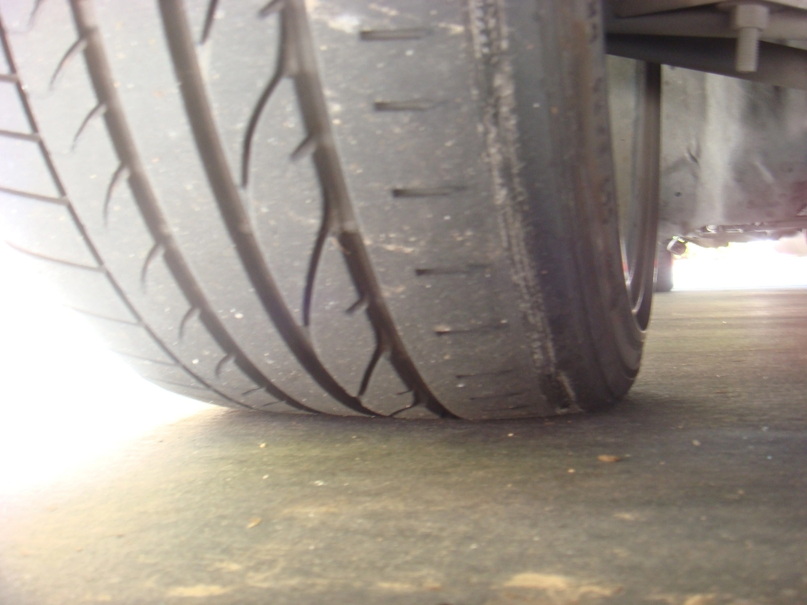

Yesterday, that passenger front tire finally gave up the ghost. Thankfully, the run-flat tires didn't give up before I got my girlfriend/roommate to her unemployment interview. Found a Just Tires nearby and picked up a pair of Fierce Instinct ZR's in 245/40/18, and at $138/tire I can't complain so far.

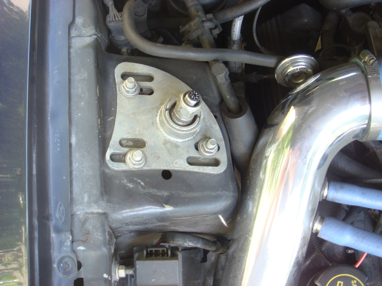

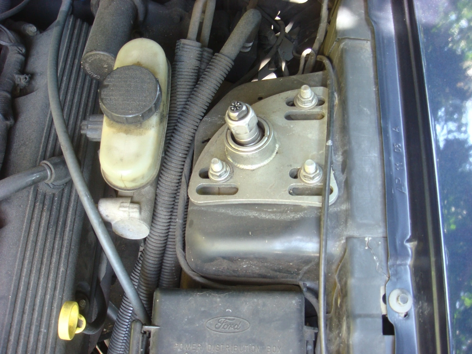

Because of the K-member, CC plates, and coil-overs, they wouldn't do the alignment but they did check it and came back with some horrific results. The camber on the driver's side is 2.1 deg negative, and 1.5 deg negative on the passenger side. Caster is 4.2 on one side, and 2.1 on the other, and both wheels were about a quarter degree toe'd out. Eek.
So I go to a spot that Just Tires recommended, Bagge and Sons at Washington and Motor, and after having spoken with UPR, I let Paul at Bagge and Sons know that the CC plates were installed incorrectly and that the alignment is totally outta whack. He tells me I can do the CC plate re-install myself and he'll do the alignment after I get the plates re-installed. When you look at the CC plates, you can see that the bean dip who originally installed them put them out of position by 90 deg and on the wrong sides of the car. The adjustment slots should be running the length of the car, not the width.
Come Monday morning, I'll be attempting to flip the CC plates to their correct sides and positioning, then heading to the Bagge & Sons for the alignment at 10am, in hopes of finishing it with enough time left to get me over to work (20 minutes away) not too long after Noon.

Passenger Side C/C Plate Drivers Side C/C Plate​
Passenger Front Tire Driver Front Tire​

As of this morning, the car is fixed. The welding was completed to the alignment shop's satisfaction yesterday, and the car was aligned to factory specs (-.2 camber, 4.3 positive caster, .1 toe in) today. I was considering going to MM recommended specs across the board, but decided at the last minute to drive the car with the factory specs until I get the MM C/C plates in. When my lady comes back from Japan on the 20th, I'll snap some pics (she's got the camera till then).
Special thanks is due to Kim Strange, an Acura RSX driver who manages a Just Tires at Sepulveda and Jefferson. She made the recommendation to go talk to Paul at Bagge & Sons Alignment Shop. Paul and Tom at Bagge and Sons also deserve a big thanks for not only recomending Bob at B&S Auto Body to weld up my cracks, but for also taking great care of me and my car. All three shops and people were staffed and run by good ol' fashioned red, white, and blue blooded 'Merican Mechanics and they all went out of their way to accommodate my special needs as an enthusiast. 3 other alignment and tire shops refused to work on my car (although all 3 were run by foreigners who do a lot of LA's custom rims...).
The car has settled down so much, I can't believe it's the same car. No more twitchiness when the car is on uneven pavement, quieter and softer over the bumps thanks to the non-run-flat tires, and a much more consistent and confidence inspiring car altogether. The turn-in is definitely slower and heavier as I no longer have a .5 deg toe out, but at least the car rolls a hell of a lot less (thanks to caster settings that are the same on both sides). Surprisingly, the steering is a lot tighter, and I'm not sure who or what to thank for that. Additionally, the majority of the suspension squeak from the front end has been greatly reduced if not eliminated. There's still some chassis flex you can hear, but obviously I have plans on addressing that.
I'm pumped the car is not going to eat its new tires or shoot a strut through the hood, but I haven't yet started to push their limits again. I want to get the lug nut and brakes done before I take it back to canyons. I probably ought to have the rear tire(s) replaced as well before hooning it too hard.
