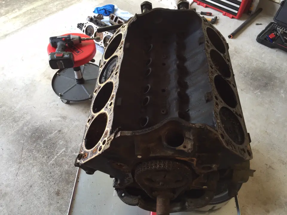

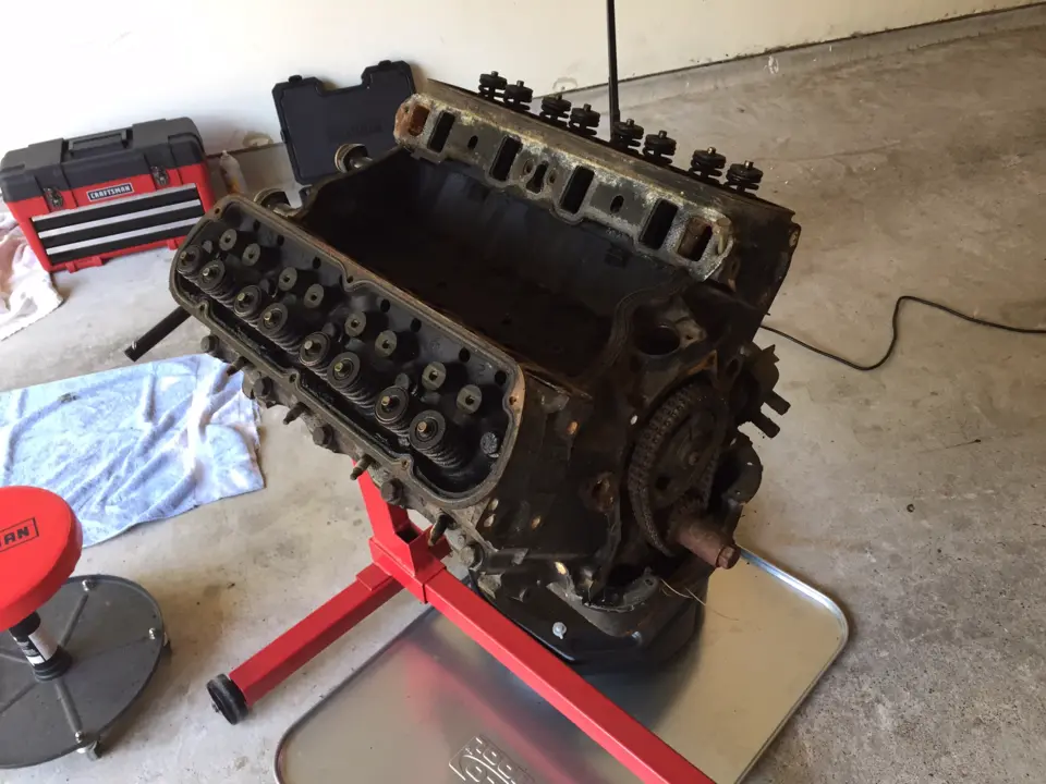

Well, I thought I'd start a new progress thread. The thread I started before was basically a gathering of data and the parameters of the build changed quite drastically during the course of the many posts. Yesterday, 06-06-15, I picked up a 351w longblock from a guy for $250. Personally, I thought that was a pretty good price (you may chime in to say one way or the other), but I thought the price was right. I'm currently in the process of tearing it down - I got the heads off today. I'll get everything else out so I can get it over to the machinist early next week to have the block cleaned, magged, bored and to make sure everything is trued up before the rotating assembly is installed. I decided to go with a Scat 408 kit - forged 4.00" crank, forged H-beam rods, and forged pistons. If the block gives before the parts, so be it. When I can get me hands on an aftermarket block at least I'll have good parts to put in it.
As the build progresses, I'll let everyone know what kind of progress is being made and post pictures as well. I'm also pretty sure that I'll have a ton of questions along the way since this is the first 351w I've ever done...I've just worked on 302 based motors in the past so I'm quite excited about the power and torque this thing is going to make.

I've always been a big fan of TrickFlow and the products they make. I might be able to go a different way if a good arguments is presented. Like I said, this is the "gist" of what I want to put together. Nothing is final, thought the short-block will be assembled in the next couple of weeks.. Chime in, advise me on current combination, let me know if I need to tweak anything. The pics posted are of me tearing down the 351 today.

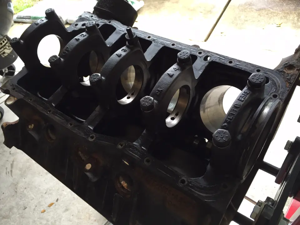

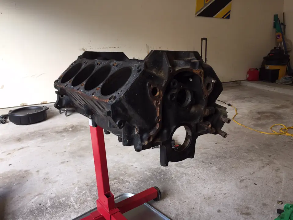

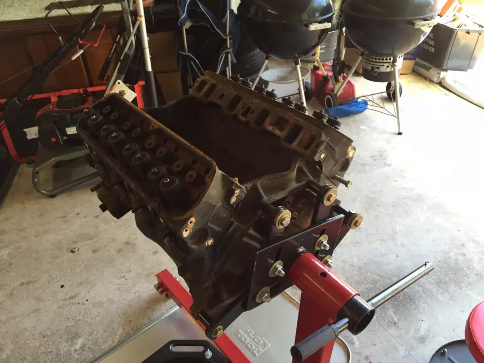

Well...I have her all torn down and ready for the machine shop. I'm dropping it off at my machinist Friday (6/19) to get cleaned, magged, bored and honed...gonna have it all done with torque plates so everything stays true. This motor is going to built right so it'll give me several years of fun before I have to tear her down again and do it all over again...which is fun, but it's not something I want to do 6 months into the motor. Anyway, I'll post pics when I get her back from the machinist.
