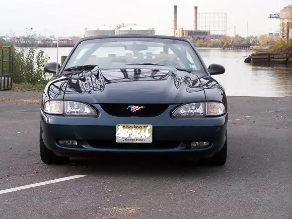

They are the projectors i tried on my 96...i thought the light output was equal to or less then stock....so don't waste your money..go for some clear lense headlights and you'll be happy.
Heres what i switched to...with clear fogs also

latino are these the parts you used for your conversion
2) Bosch Projectors
(2) Hella/Philips LVQ-212 G3 Ballasts
(2) D2S HID Bulbs
(2) Ballast Covers/mounts
(2) Ballast connectors
also did you have to make your own wire harness
hey ALEX, yeah i made my own harness also thats exactly the package i used to go HID. I got sold on the idea that its all OEM parts off of Audi's so the quality is superior and only for about $390.
All the parts needed could be found at RadioShack. About ~$20 to make it and there's a how-to in the University section of hidplanets' forums.
I know most will say that $400 for some lighting is way too much, but hey, it has more function then a shakerhood, bling wheels, body kits, mufflers etc(all which are cool if done right).
