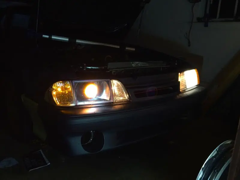

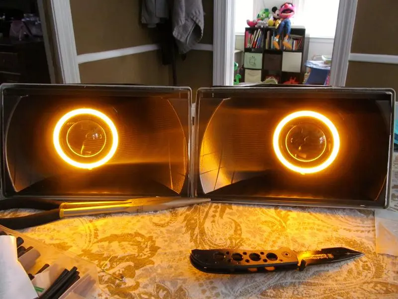

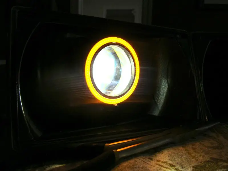

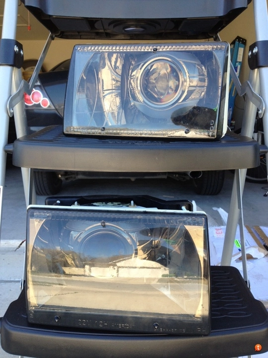

I had a set of ultra clear headlights, decided to paint the housings anthracite. Wasn't able to tweak the cutoff to be perfect, but oh well. Anything is an improvement over the headlights on this car, probably one of the worst outputs ever recorded in history in mass produced cars. (Yes, i stand by this statement)
Morimoto B-Stock Mini H1 projectors
Morimoto 4300K H1s
Amber 2nd Gen xbALed's
Chrome Mini Graphite H1 shrouds painted black
All purchased from www.theretrofitsource.com. Great place, can't recommend them higher. The projectors fit without any cutting, and you can use one of the provided adapters as a washer since its the same diameter as the I.D. of the 9004 socket.
Anyways here are the pics. Should be a vast improvement over the 9004 Silverstar Ultras that are in the stock housings now.
