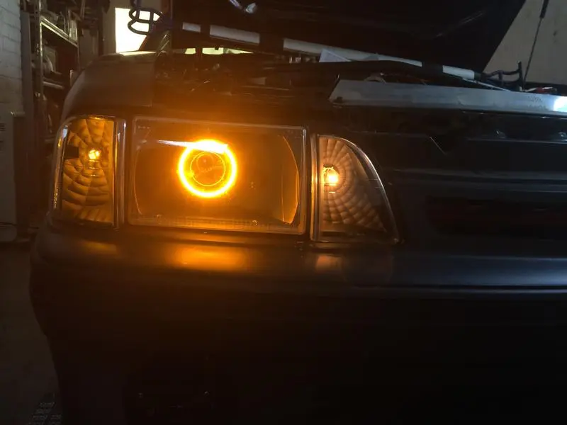

Alright, new inner and outer lights are in, pay no attention to the fitment, they are literally just resting in place for now.

Looks good! I will post pics of mine this weekend when its a little warmer outside. It's currently in the 20's here and I get all my work done at night so it's too cold for me in the garage.

Looks like a nice set up with the new ambers. Much better than I initially thought it was going to look.

I just need to get an amber bulb for the turn signal. Still debating LED or Halogen.

Did you wire up the H.I.D's yet? Did you set them then seal them? how s the cut off?

That side is wired temporarily, and not sealed yet.
The cutoff seems to be pretty good. It's hard to tell though since the wall is only about 3 feet away. Soon as I am able I'll get the car backed up into the driveway and see what the cutoff really looks like. I can safely say it is MUCH brighter than the Silverstar Ultra in the drivers side.

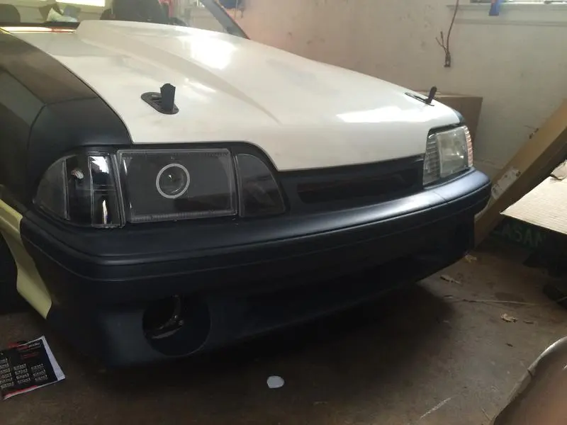

Everything bought from RetroFit. Projector kit, 5k bulbs, and glue. All pretty much plug and play with the exception of cutting off the stock bulb holder on the headlights

cool ill be ordering my kit soon. I think I'm going to go with the square X housings
