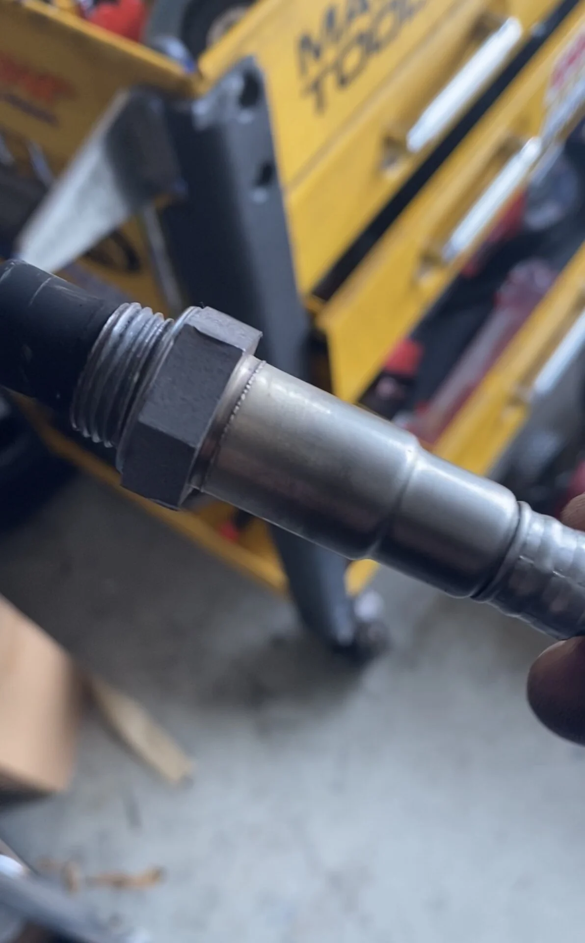

So I usually run an aem wideband in most everything we do, usually a 30-0300 or a 30-4110. The past couple years I’ve seen the supplied sensors fail 3 different times. Twice on my cars, and once on a ls truck we built in the shop. Each time they’ve been replaced with a parts store Bosch 17025 and they work great for years.
So this last time, I had a aem gauge actually just quit working. I’d had it for years so I just replaced it with another. I reused the 4.9 sensor (the parts store one) since it worked well and had the supplied aem 4.9 in the box. About a month ago, that parts store 4.9 failed (which it had lasted a few years) so I swapped it out with the supplied aem sensor. That sensor lasted all but 2 hrs and then quit on me.
So naturally I was pissed and I emailed aem about the failure. I called them out that this had happened several times, and only with their supplied sensor. They mailed me a replacement one. Which lead me to what I discovered today.
I believe they’re shipping knock off ones in some of their kits.
Every single aem wideband we’ve ever purchased had came directly from summit racing (or atech, the summit wholesaler), I have POs for all of them.

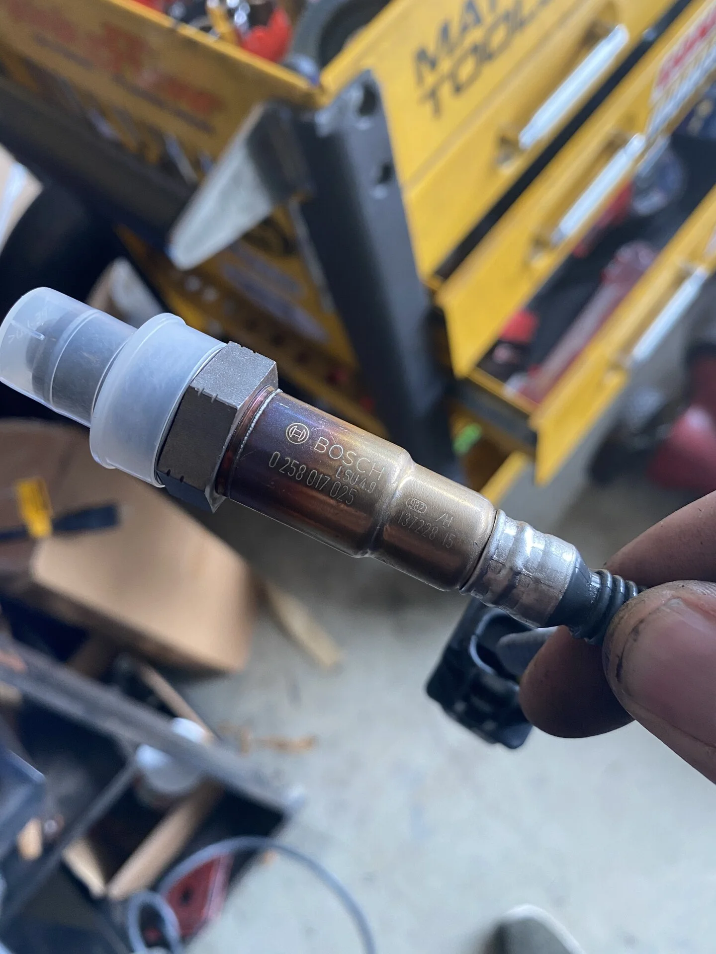

If you buy an aem sensor, make sure it looks like this, which was the replacement they sent me:
And not this, which was the one that came with the 30-0300 kit:
Let me know what you guys think. Anyone else seen this?

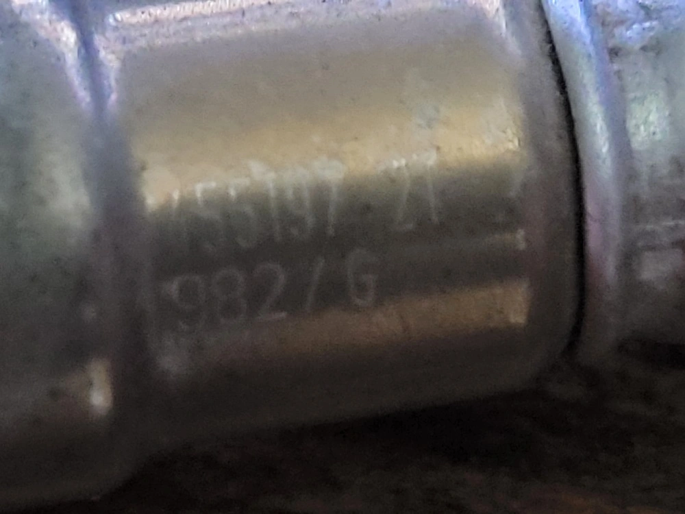

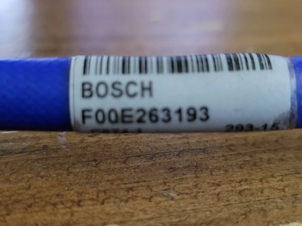

This is interesting, I have an AEM gauge from a few years ago that was bought at Summit Racing. Here's what it came with.
Kind of looks like a no name with a Bosch sticker on the wire, and none of the numbers match. It's worked good for a couple of years now. I saved your picture for reference when this one dies on me. Thanks.

I don’t have any extras. I still like the aem widebands, and maybe they got a garbage batch of sensors from a supplier. Who knows. I know the replacement sensor they sent me is a legit Bosch 4.9, so I’m sure it’ll be good.
I actually did email Bosch with a picture of the one that failed, and the rep said it appeared to be fake, but also said it’s tough to come to a for sure conclusion. He also mentioned there isn’t always the Bosch logo on the body, but it’s not as common since these are usually ordered in bulk from major auto manufacturers, so they can have their own part number on them. He also said he’s not used to seeing them without the purplish heat mark either.
LX - that’s actually a similar number that I’ve seen on 4.9 sensors before.

I’m glad you guys chimed in. The tune on the car has pretty much never changed, at least not in the last year and a half. Car has always been consistent and always just ran on regular unleaded gasoline
I’ve really never had any sort of issues with the gauge itself, just the sensors. I had one gauge fail, but it was after a couple years so I really didn’t care about that.
Doesn’t it seem odd somebody would buff off the only thing that actually identifies the sensor? Especially on a manufacturer where there is so many people making fakes.

We appreciate your support! PM me with your email address and we will send you a call tag to ship the sensor. We would like to see it. As for the buffing, we agree that it is strange and can’t explain the “why”, but can say that “what” we put in our kits is OEM Bosch.
That's good to know.

Only replying because you quoted my post. I used this current one for a couple of years with no problems, for tuning my truck. Currently, it's not installed in anything, kind of waiting for the next project.

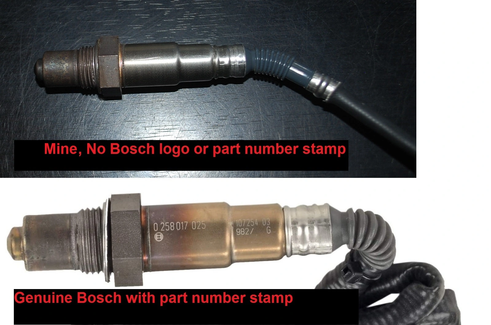

I just found this thread and wanted to mention I'm having the exact same problem.
Purchased an AEM 30-4110 wideband gauge with "Bosch" LSU4.9 sensor which does not have the Bosch logo/part number stamp.
I haven't even driven the vehicle yet and the o2 sensor is apparently already bad. Tunerstudio is reporting a completely unchanging & unrealistic lean o2 signal voltage while the engine is obviously running quite rich, and the AEM gauge just shows three dashes(off-the-scale indicator I guess?)
I ordered the AEM 30-4110 on Ebay from a seller named Boostprojects and I can't help but think this is a fake knockoff bosch o2 sensor. Why else would it not have the Bosch stampings, and why would it be dead already? I don't know if it's Boostprojects including fakes in their kit or if it's coming from AEM this way. I just hope the gauge is genuine... or are the Chinese making fake AEM's too?
I just placed an order for a known-genuine replacement Bosch 17025 so hopefully that solves my problem.

Installed a 30-0300 wideband in a friend’s car about a year ago. It’s that blue convertible I did a v2 on and just got done doing hci on. A year in, and well under 2000 miles later of course the sensor takes a :poo:.
You’d think I’d quit buying the aem stuff, but the controller and gauge does work good. I contacted their cs, again, and since the sensor is more than 6 months old they won’t warranty it. Honestly it’s a shame they won’t just come out and admit the sensors they provided with these kits are **** from the get-go.
So anyways, another aem supplied wideband sensor goes in the trash.
