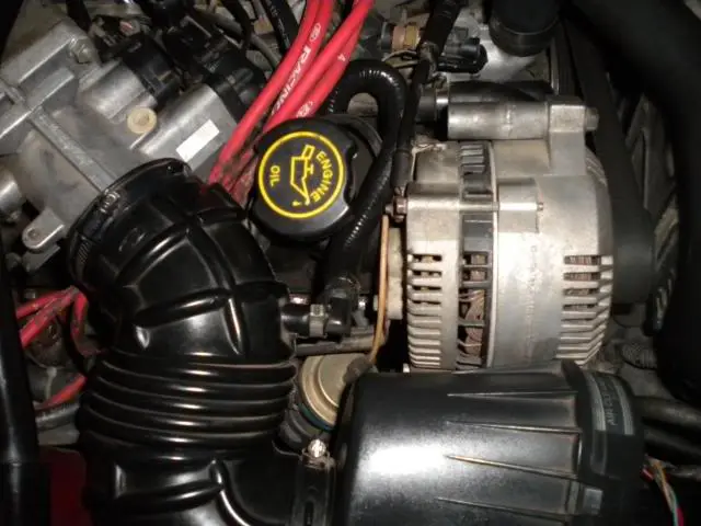

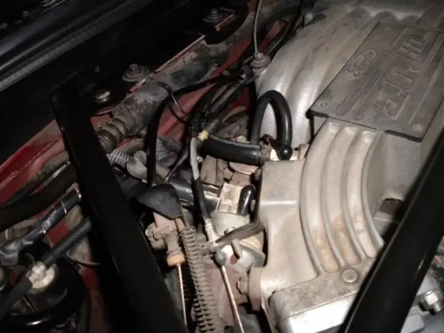

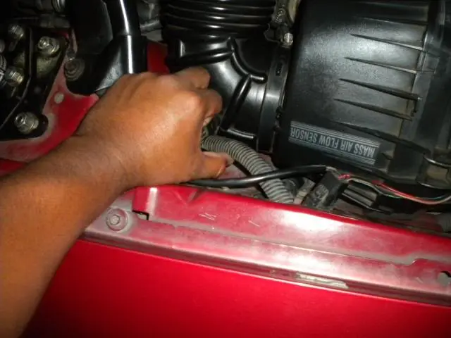

there are 3 colored hardlines.
ones tan,the other green,and the last red.(i think)
they are wraped in a black loom coming out of the pass side fender,near the mass air connector.
remove the air intake tube to get to them.
one goes to the egr valve,the other,a valve below the alt,and the other to the vac fitting on the upper intake.(i think)
i replaced the broken sections with rubber vac lines.
here are some pics i took to give you an idea of their locations.sorry,i dont have anything with more detail.
hope this helps ya out a little.

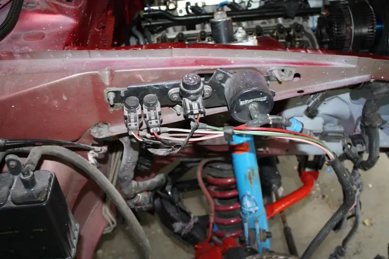

Other side goes to here.
