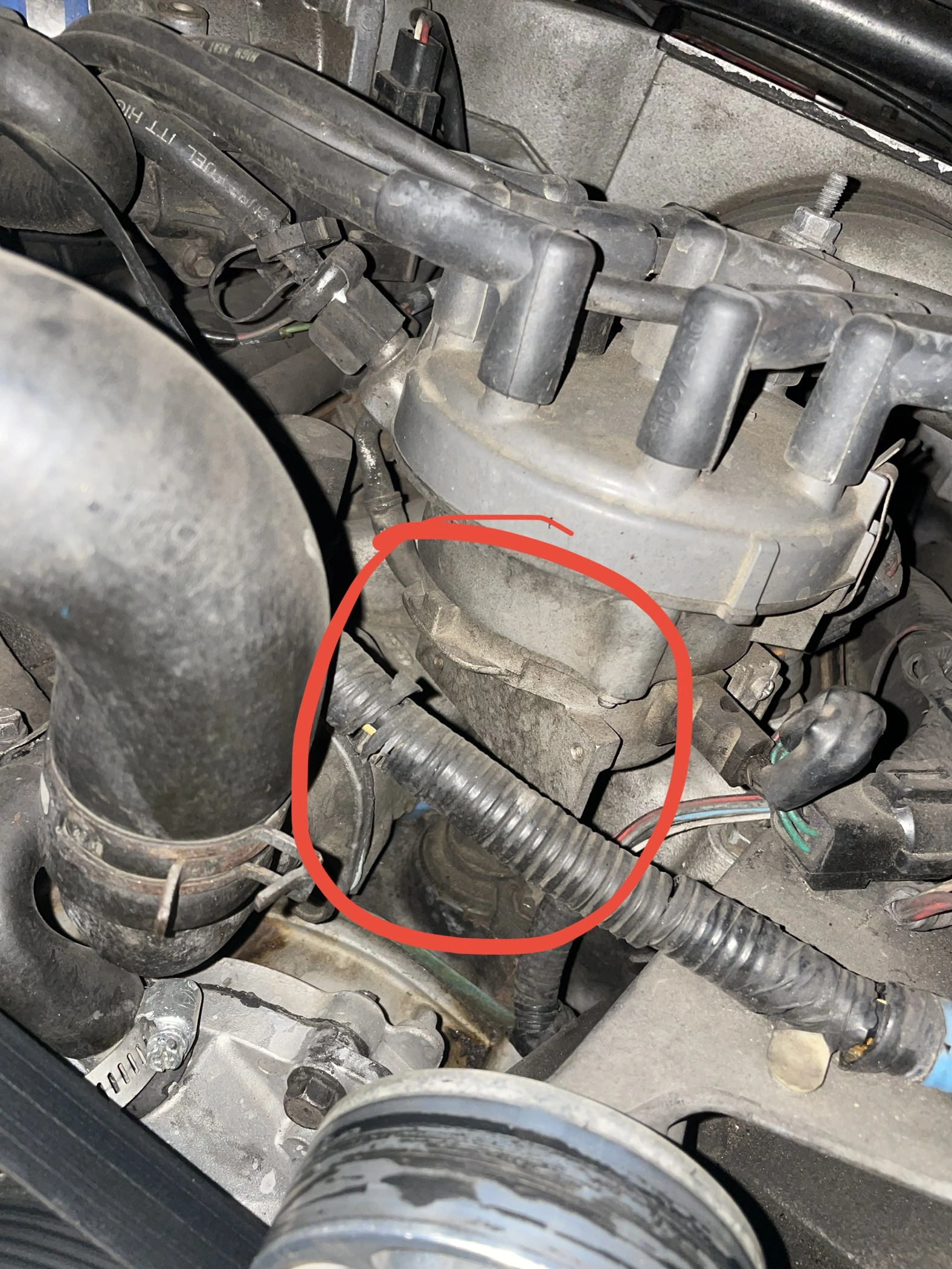

Upon my search for the spout connector I noticed this empty bracket point on my distributor. What's supposed to be here? I found the first Spout by the wheel well but not one by the distributor.

94/94 cars no longer have the TFI module mounted on the distributor (area you noted that is “missing something”). Ford finally addressed the issue of them getting heat soaked on the 86-93 cars by remote mounting them on the 94/95 cars. So no need to worry about something missing as nothing is missing.
Use the check list the General has pointed you too.
