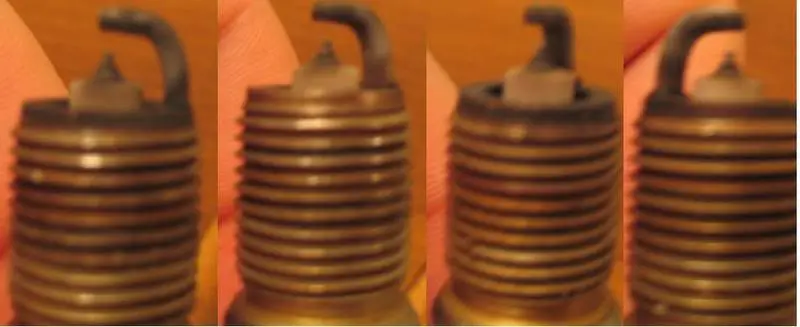

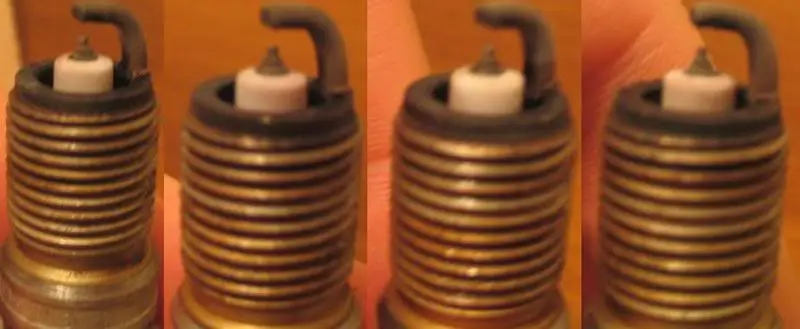

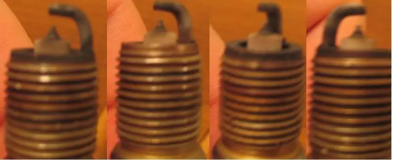

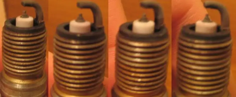

Ok so here are the pics. Sorry about the quality, I suck @ photoshop and my camera hates closeups. I tried focusing on where the largest deposit buildup was
Drivers side:
Passenger Side:
As you can see, the passenger side plugs are still white, while the driver side are browned

BooWFO said:
True but doesn't the entire bank get corrected by the o2 sensors reading? Could a messed up injector and a lazy o2 cause a fueling issue?
Just wondering for my own knowledge.
A bad injector would cause that bank to read lean or rich at the thus cause a correction for that bank, but the one plug with the bad injector would still show signs of being leaner or richer than the others.
Well I appreciate everyones input here. I think maybe I just worry too much about my car :shrug:
But anyway, jstreet and BooWFO if you look at this, I posted pictures of the plugs a few posts up in case you're interested in taking a look.
