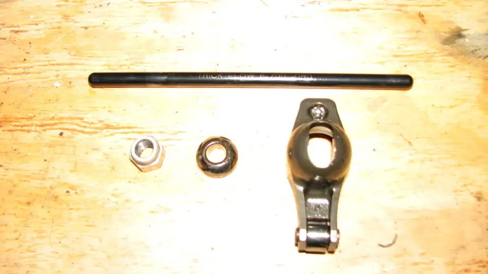

The rockers have a flat spot fot the nut to sit on.... or i guess in this case a poly lock... so what exactly do i need... im almost positive the TFS hardened 6.7's that i have should work fine...
so all i need is guidelpates and what else???:shrug:
in this pic you can somewhat see the flat spots... the peice that sits in the washer is a half spherical shape with the rounded part pointing down...

Yeah, those are stud mount...you need stud mount rockers, guideplates, and hardened pushrods.
Pull a rocker off and look at the fulcrum. A stud mount rocker will have a flat spot which faces up for the polylocks to sit against. The rest of the fulcrum will be round.

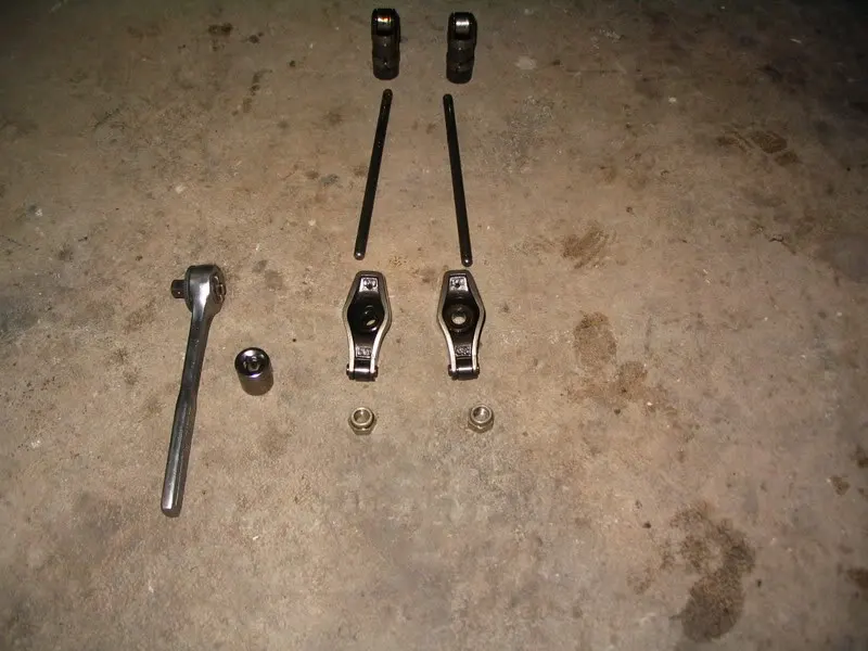

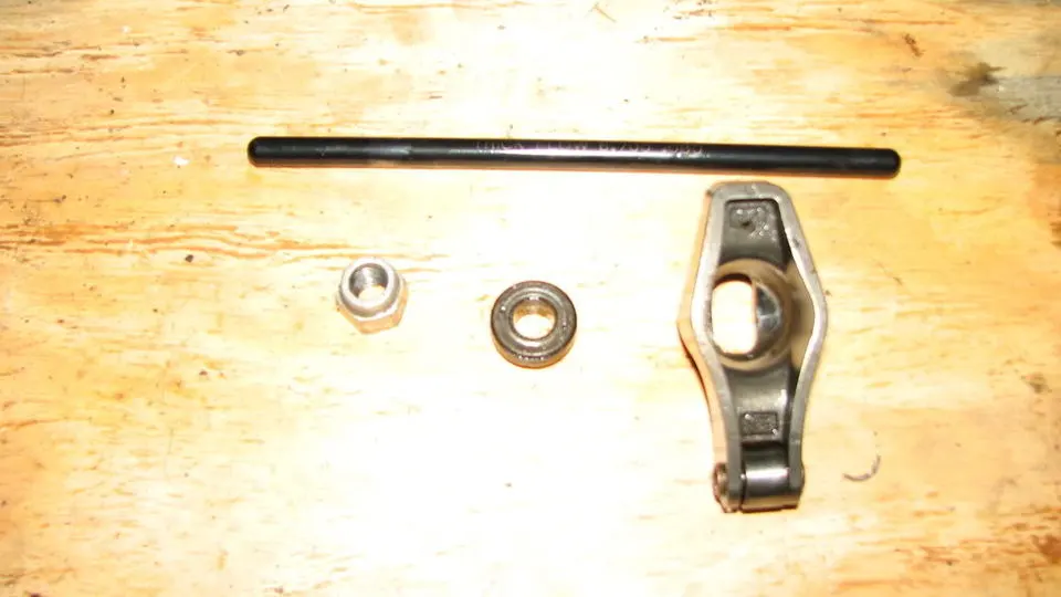

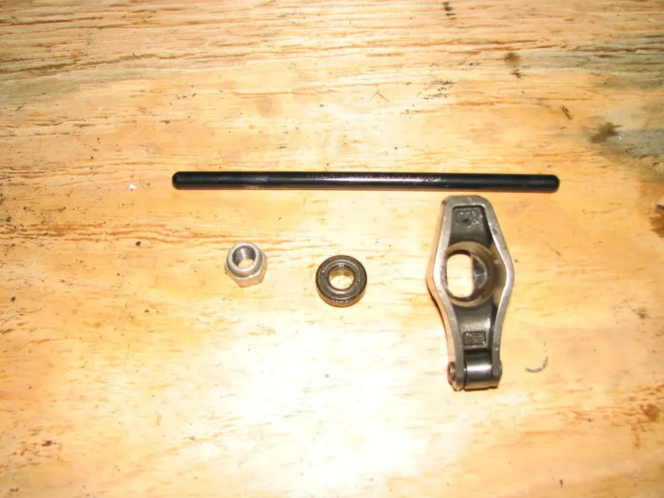

this is a closer view of what we are working with. I cannot even read the brand name inscription in person so I'm not sure how anyone can in these pictures, but they lack the 442 inscription on the ones you linked. these have an H where those say H442
I searched by that part number on google for anything with a close up of the inscription, it looks close to correct but the pics are from pretty far away.

When you put the guideplates in (edelbrock makes a set IIRC), take the shims out from under the studs...no need for them. While those rockers "might" work, I wouldnt use them...I would get a set of Stud mounts...crane or comp both make good sets.
As far as adjusting, (for each cylinder) I turned the motor over until the exhaust valve opens, put the intake rocker on, turn the polylock until zero lash, tighten 1/2 turn, lock it. Turn motor over again until the intake valve opens, then do the same for the exhaust. I need to adjust them agai, as it has only been run in the driveway, but I had good results with this method.

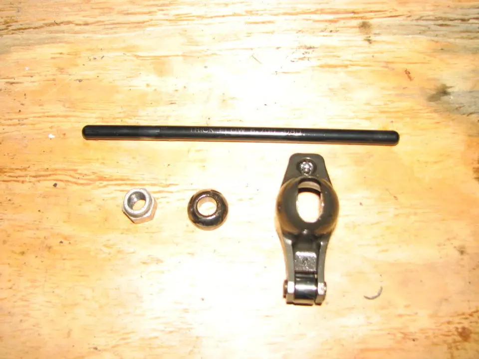

After looking at the rocker again, It wont work. If you look at a serious stud mount rocker, you will notice the amount of movement on the fulcrum is unlimited...meaning if you hold the fulcrum only, the rocker will spin around it completely. There is limited movement on the type you have.

The proven system is guide plates, hardened pushrods, studs, poly-lock rocker arm adjusters, and reputable brand roller rocker arms. What you have now are an older design that was based off Ford's rail-guided rocker arms (no roller tips). The guide plates sandwich under the hex shank on the studs, no shims necessary. Then you just use the poly-locks to adjust the lifters.

the style rockers you have are designed to work without guideplates the guide is on the nose of the rocker arm. they are called rail type
however these are prone to having clearance issues with big lift camshafts at the retainer and I fear you will have the same trouble.
the locking nuts you have are designed to work with those rockers, but can be replaced with poly locks if you would like.
i think that pushrod is actually a little long for that setup but you need to do a stem sweep and make sure, and for gods sake get the washers out from under your studs and put sealer on the threads or yiou will drink oil through the threads.

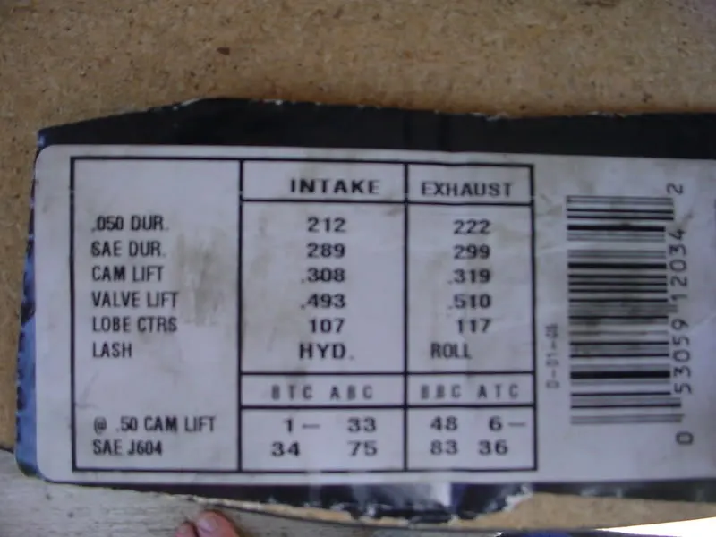

my cam's lift is only a .51 IIRC....
Here are the actual specs....
