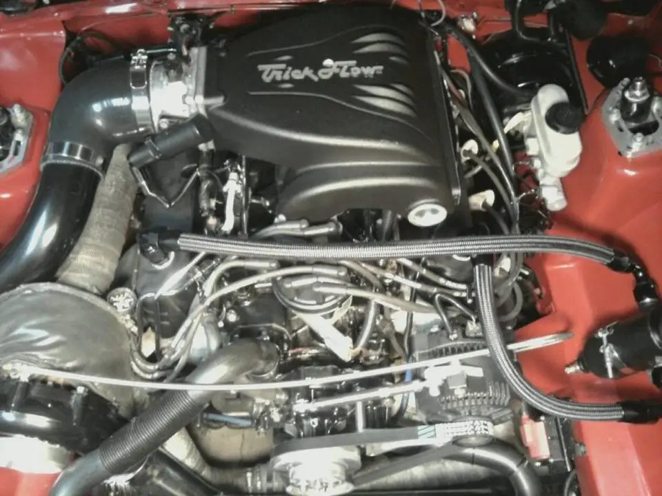

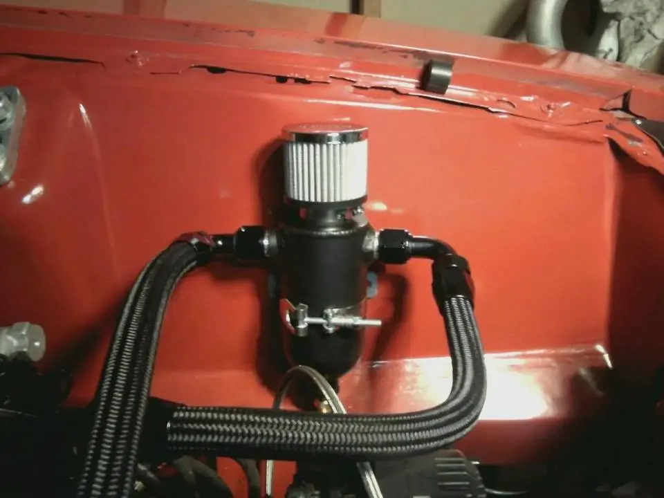

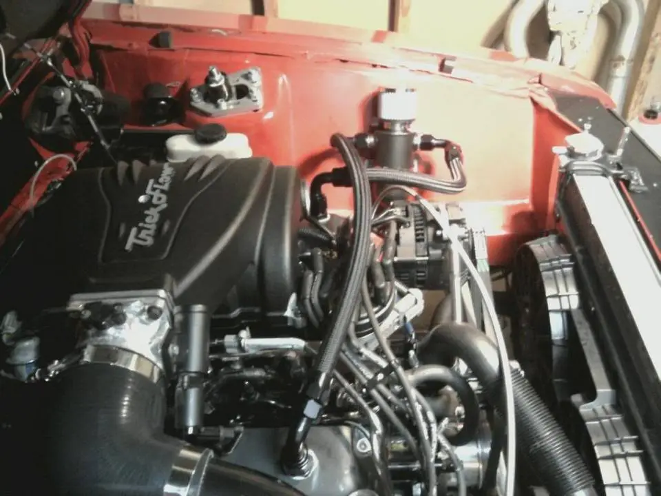

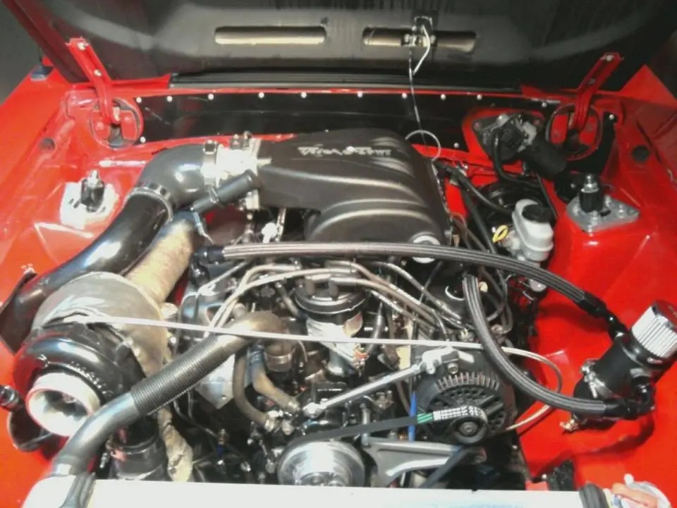

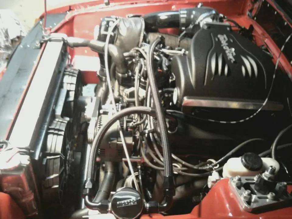

Got my catch can set up from summit installed yesturday,but i had to take to take the valve covers back off cause the bulk head fittings wouldnt stay tight,so they are getting tig welded on.And i tig welded the other fitting on the other side of the can cause it only came with one.Heres some pics. peace

76mmlooks nice! what size is the turbo?
Well yeah with almost $100 in just hose i hear ya!I need to do welded fittings too, the hoses look good, I cheaped out and used rubber lines for now.
that engine bay is straight tits
Thanks guys!Wouldnt have it any other way! peaceThat bay is really sanitary.

I just did the same thing last night. Had two -12AN bungs welded to my valve covers, bought two summit 90 degree AN fittings for 16 bucks each (nice fittings), 6 feet of russell proflex braided hose for $50 (more than enough hose), a moroso tank with two 12AN bungs for $95 and two mr. gasket shadow series 45 degree fittings for 12 bucks each (on sale, reg $30 each).
I'm into into it about $250

I used the exact same stuff almost just more hose didnt wana wait on the 6' to come back in stock.Did you get the 15.5"L can?peace

yeah it's pretty long, looks pretty decent though, I bought it because 1991vert had the exact same can

Looks real good, love the black. What turbo setup is that?
iirc its the on3 setupd
I have a dual inlet vented breather tank like that on mine. I did it the quick/cheap way and used 5/8" heater hose. I mounted mine inside the passengers side fender where the air silencer would have been with the factory air box. Out of site.
