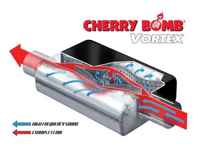

Has anyone ever tried these? They're supposed to be pretty tame from what I've read about them and still a straight through design
Thanks!
Popping is a symptom of no cats most likely. I don't know much about the Vortex, I think it's supposed to be similar to a Dynomax Ultra Flo or Hooker Maximum Flow, but they're straight through with a perforated core and a big case.
Don't know if you can get the Vortex in a pre-made axle back...I believe you can get an Ultra Flo axle back. Would definitely be quieter, the big case has more packing, and that might be a decent option if you want to remain catless.

Yea it's definitely too loud when every time I go passed 1/3 throttle everyone thinks I'm driving like a maniac and the cops pull me over. But as far as the cherry bomb is concerned I can weld it in no problem but it may be a couple weeks before I can get to it. I have too many projects and not enough time at the moment
