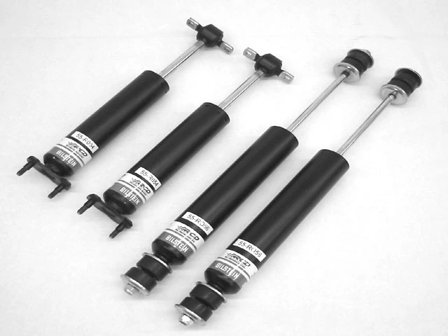

Maier Racing has many variants of Bilsteins for the classic Mustang. Go here http://www.maierracing.com/ , hover the mouse on the Catalog button, Early Model, Suspension, and click Shocks. $350/four base price, more for customs.
I have the Bilsteins from Maier as well. I ended up with the Sports with my spring combination (their 700 front / 200 rear). I have yet to autocross this combo, but will in early May.
Mike Maier told me that the rear shocks have identical valving in all three variants. The fronts are the only ones that change.
I hope to have mine dynoed soon and look at figure out the percentage ciritical damping to see where they lie. That's a few things down the list though.
