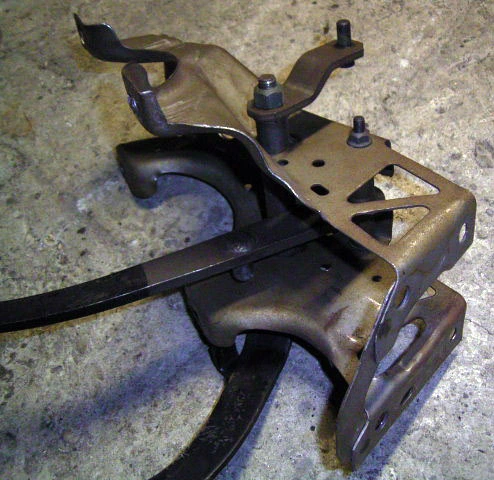

But I guess I forgot to figure out how to link the clutch cable on the new bellhousing. The old cable won't fit anymore, and if I get a new cable it won't fit the old pedal assembly :bang:
It needs a quadrant or something ... :shrug: If I look on sites like Jegs and others, they mention that those quadrants will fit the 79 pedal assembly, are they right? Anybody ever done this?
I called some shops but nobody seems to be sure about the quadrant fitting the 79 pedal assembly, or an other solution besides ordering a new pedal assembly.
euuhm, ..... help ? :rolleyes:
Get an OEM cable for a 95 or get a complete kit from Maximum Motor Sports. The 95 cable (as I've recently discovered) fit's the Fox bodies as well as it's intended years and allows routing around all sorts of silly things (like steering and exhaust). The only portion of the cable worth looking at for 'fitment' is the clutch fork portion. So long as yo're using a T-5 and T-5 bellhousing, then it will fit.
I guess you're refering to your 86, that came stock with a plastic quadrant?
The 79 model only has the small bar (that can be removed) with a pin where the cable attaches on.
Maybe a quadrant will just bolt on instead?
Or are there other parts needed to be able to use the quadrant?
here's a pic of the pedal assembly :

The pedal assembly looks very similar to a later model one -- except the clutch bracketry. I would think you could either try and swap the parts into that one or just obtain a later-model assembly and swap it in. I don't see how you would attach a cable like you need otherwise. :shrug:

I don't see an aftermarket quadrant working in that setup. The aftermarket pieces have two mounting points -- which your pedal assembly doesn't have. I don't think it will stay on there or function right with that setup.
The spring is for the factory plastic adjuster -- it gets removed when you put an aftermarket one on.
Mustang GX is right. The quadrant will not work in that '79 pedal assembly. I know because I tried it too! LOL! Eventually I came to the realization that I needed something newer so I went to the junkyard, found an '89 four-banger LX that was missing the entire interior (including dash) and unbolted an entire pedal assembly. It literally took me 5 minutes to get it out and the cost was only $10.00.
I took it home and it was a direct bolt in. I then was able to attach my Steeda quadrant, cable and firewall adjuster. It's now a year later and all is well.
