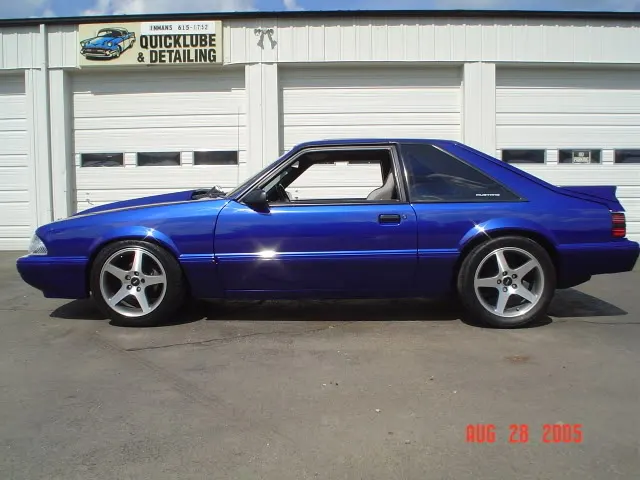

YES! they will work:
Although i did use 5/16" spacers up front, or i heard u can "grind" the rotor hat down to make them work w/out a spacer. There is an article on the grinding somewhere......
