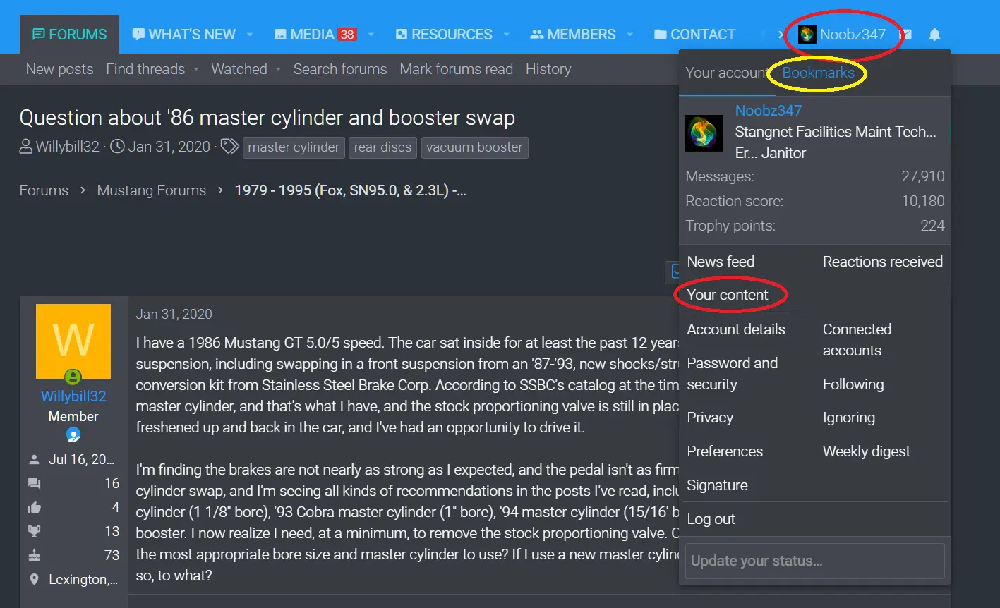

my apologies that I keep getting lost in the forum threads.
If you ever forget where you put something, look in here:
In Red:
Click on your screen name in the upper right
Click on (Your Content)
This will show all of the places in which you interacted.
The one circled in Yellow is is the Bookmark tab. You should play with that and see how it operates. It will help too. :)
