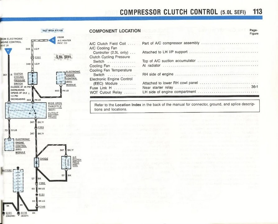

Hey guys, I have a 93 mustang. So the relay next to the fuel pump relay is supposed to be an a/c wot cut off switch right? What measures the wot on our cars? The tps? In planning on hooking up my nitrous kit why cant I just wire nitrous to turn on through that relay instead of mounting a little switch to the throttle body?
The Clutch Cycling Pressure Switch is in series with the WOT relay. You would have no nitrous whenever the A/C compressor clutch is shut off by this switch.

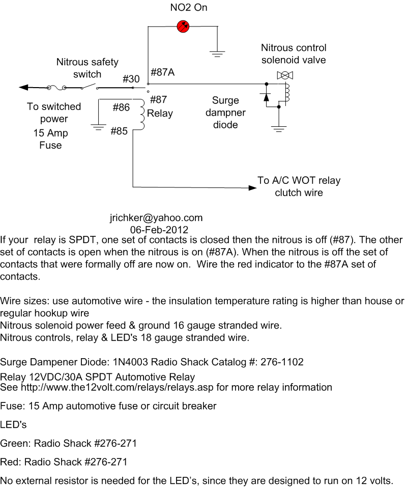

Use a Single Pole, Double Throw relay with the coil wired to the WOT relay and ground. Use the relay contacts that are not closed when the relay has coil current. That way when the A/C WOT relay opens up, the other relay does too, and the contacts close and make a path for the electricity to open the nitrous solenoid.
nitrous-control-using-a-c-wot-relay-with-safety-toggle-on-and-off-gif.69553
Awesome Joe, that's exactly what I was thinking, I would just wire it up to another relay, for some reason I see everyone mounting those little micro switches to the throttle body, this seems a lot easier.
