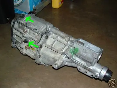

Here is a picture...

The top one looks like you nuetral safety switch plug and the bottom one is for the reverse harness to plug onto.

bottom

When I did my new engine/trans install I never saw a harness to hook up to the trans' neutral safety switch. The only connections my car has is a hook up for the VSS and another one for the reverse.
The reverse plug is more like a cap and would not fit the neutral safety switch harness.

the one extending from the top of the case is for a shift light, some cars such as the thunderbirds came equipped with them... you want to plug it into the one thats on the casing itself on the side.
