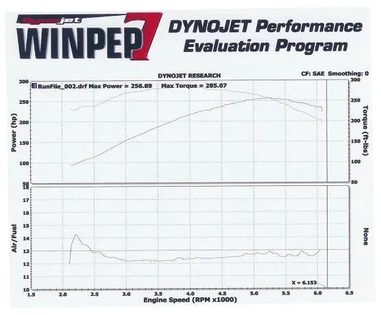

Just thought I would be gettin alot more hp to the wheels with this setup i have. Any comments or advice?

what kind of alum. heads?
which size rockers?

The stock Cobra came from the factory in the neighborhood of 235 hp. YOu added aluminum heads but they are still GT-40 design so you'll get a negligible gain. Going to the 1.7 rockers might help you a bit depending on tune. B cam will help with your 1.7's and long tubes. A 75mm MAF can never hurt and your fuel pump prolly didn't change anything. Underdrive pulleys will get you a couple. I would have estimated somewhere in the neighborhood of 265 - 270 hp. Your numbers of 258 hp and 285 tq are pretty accurate. I always tell people not to dyno their cars cause they will only end up disappointed.

I think it is pretty acurate, my understanding is thet gt-40 heads should give more tq.The hp seems ok but I would see the tq being at least in the 270's 280's
