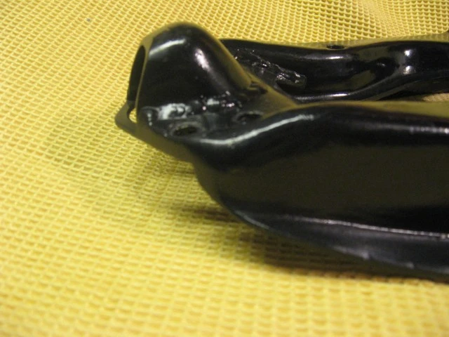

IMO 1/4" is plenty. The rim/wheel shouldn't flex. The tire will roll over some but not much. I run my cars with less than that.
You can grind/cut back on the upper arm too. Here is a photo of an arm I did for my Falcon.
