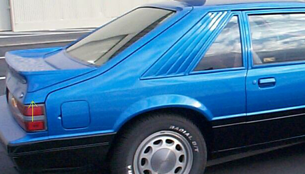

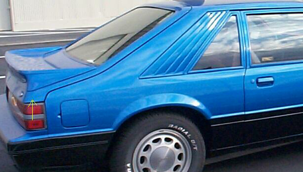

Here's the actual spot where the rust is coming up under the paint:
Unless you're completely enamored with the metal hatch, if fiberglass replacements are available, I'd make the swap. Lose a few pounds and eliminate corrosion completely. And if over time fatigue cracking is an issue - that's easy to fix with fiberglass.
I read your original post on the fiberglass option before I posted. I think reducing weight and eliminating what's likely to be a continual corrosion problem is absolutely a good idea.
If you're worried about weight distribution (not ideal on the Stangs) go about it by removing weight from the front too. Crossmember, engine set back, battery relocation, etc.
Yeah... battery relocation is definitely on my list of things to do. Crossmember will be swapped out with the motor (Rick is currently building). I'll look into what this one will cost to save and keep the fiverglass option in reserve.
pic.php
pic.php
Well, be happy yours doesn't look like mine; I'm sure you'll take care of it before it gets this far out of hand - mine was like that when I bought the car 4 years ago. I went to a body shop a few years ago about it and he said it would be cheaper to just buy a used hatch and have it painted than it would cost to have that cut out and repaired. I got a nice used hatch, but it's beige, so I'd have to paint it and retint the back window...haven't gotten around to it. I'm just now thinking about getting it done since it's been bothering me for so long. There's no way if I paint the hatch that it's going to match the rest of the car; the rear bumper was repainted 3 years go when I was rear ended, but other than that, the rest of the car is faded red paint. The front bumper is gonna have to be replaced due to my latest front end damage. I'm thinking about just checking prices of paint and possibly getting a decent paint gun and just do the hatch and front bumper myself depending on how much more money it would cost to have it done at a bodyshop - the way I see it is it can always be repainted over, I've wanted to paint for a long time, and it probably couldn't look much worse than what it does currently, lol.
Sorry for the rambling, not to steal the thread; I'm gonna start my own in a few days once I get some numbers for paint and all the supplies and then comparable numbers from the body shop.
...and two completely different issues I suspect -- Daggar yours from the leaking spoiler; User's from a previous owner's MANY years of driving chemically treated roads in the winter and having that 'stuff' kick up under the edge/lip of the hatchback over time.
Perhaps... it's hard to tell just by looking at the pics and even looking directly at the rust, which side it's actually rusting from. I just assume that mine is rusting from within because of the patch work that I did last summer. Yes though.... Those pics are exactly the kind of thing I'm trying to prevent before it gets completely out of hand.
