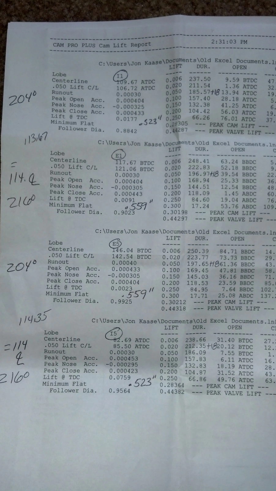

Had a set of cams measured the other week. Stock cam in my 04 GT is .484 on intake, and the new cam is .523 on intake. Talked to my buddy and he told me that the only way we will know if we have contact or not is to put them in and hand turn the motor. My question is, does anyone already have a cam this size or close to in a 2v GT?? I don't want to have to put the heads apart to find out if is too big.... Any advice is appreciated
