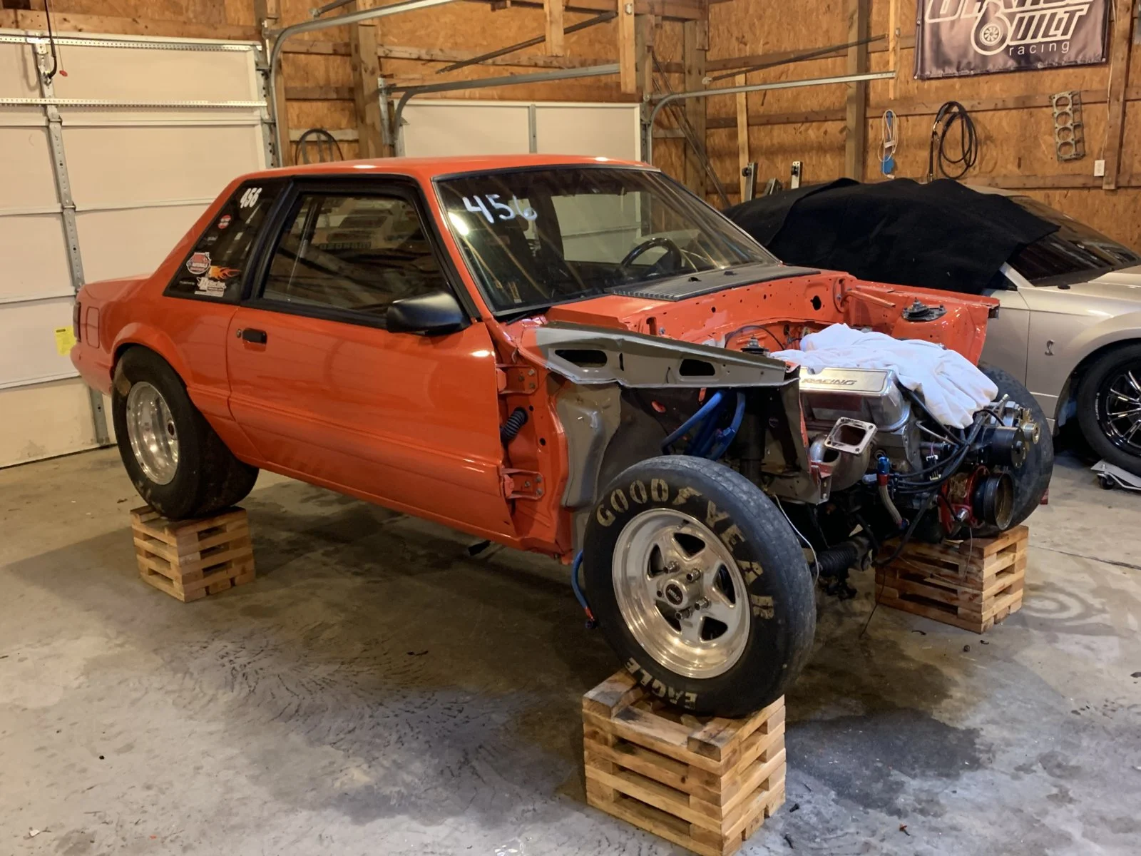

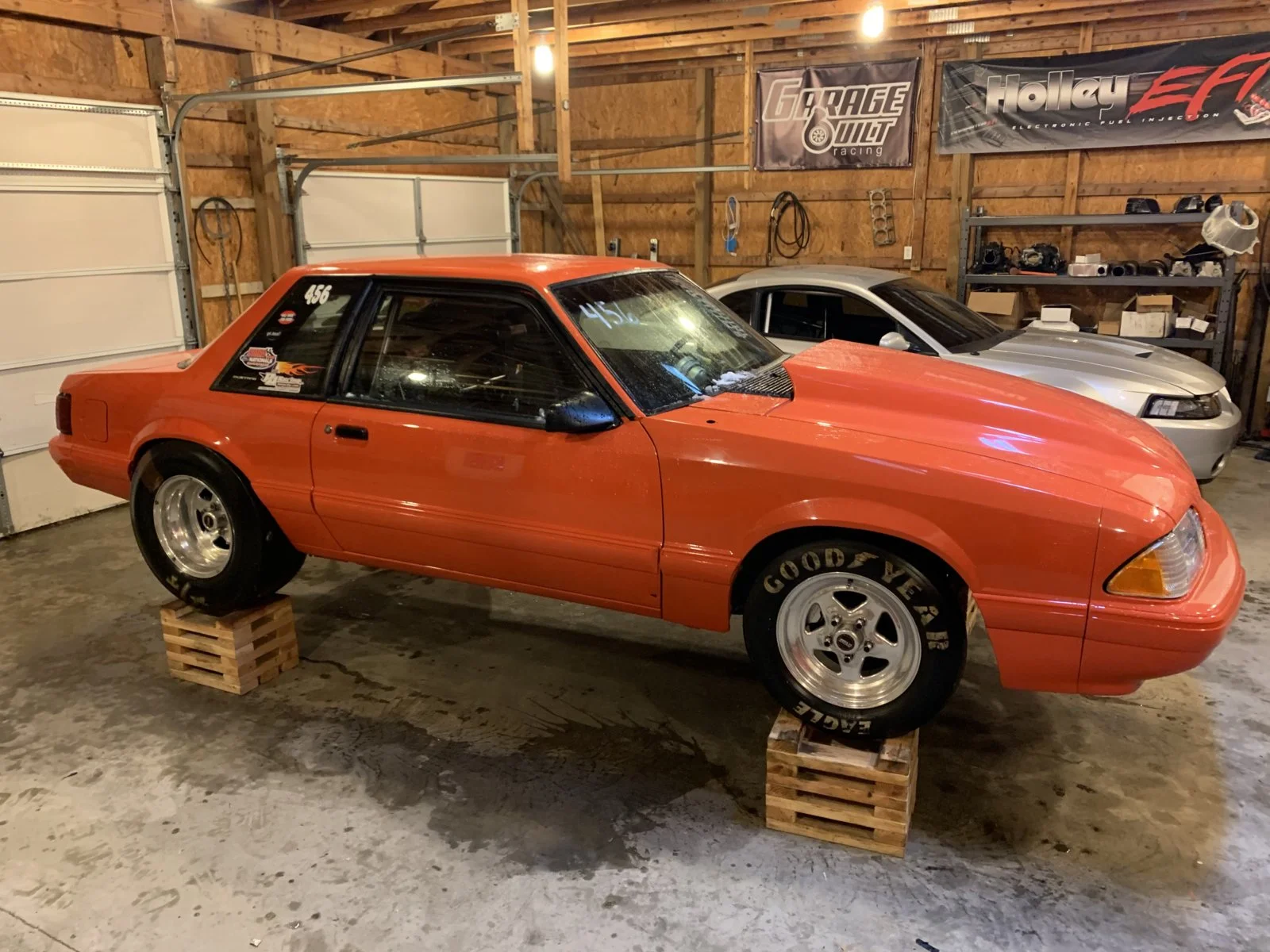

I’ve had a coupe in my shop for the last month or so putting a Holley EFI system on the turbo 306 combo. Made some small changes to the turbo kit, fuel system and just general wiring cleanup. It’s a really solid car, 8.50 cage, built-ish rear end, etc. Its just a bit outdated for 2019.
Anyways, the owner is ready to get back into class racing and that means basically starting from scratch on this deal.
Engine,trans,converter, rear end have been sold.
Will need to make 1200-1300fwhp range with the new combo to be competitive.

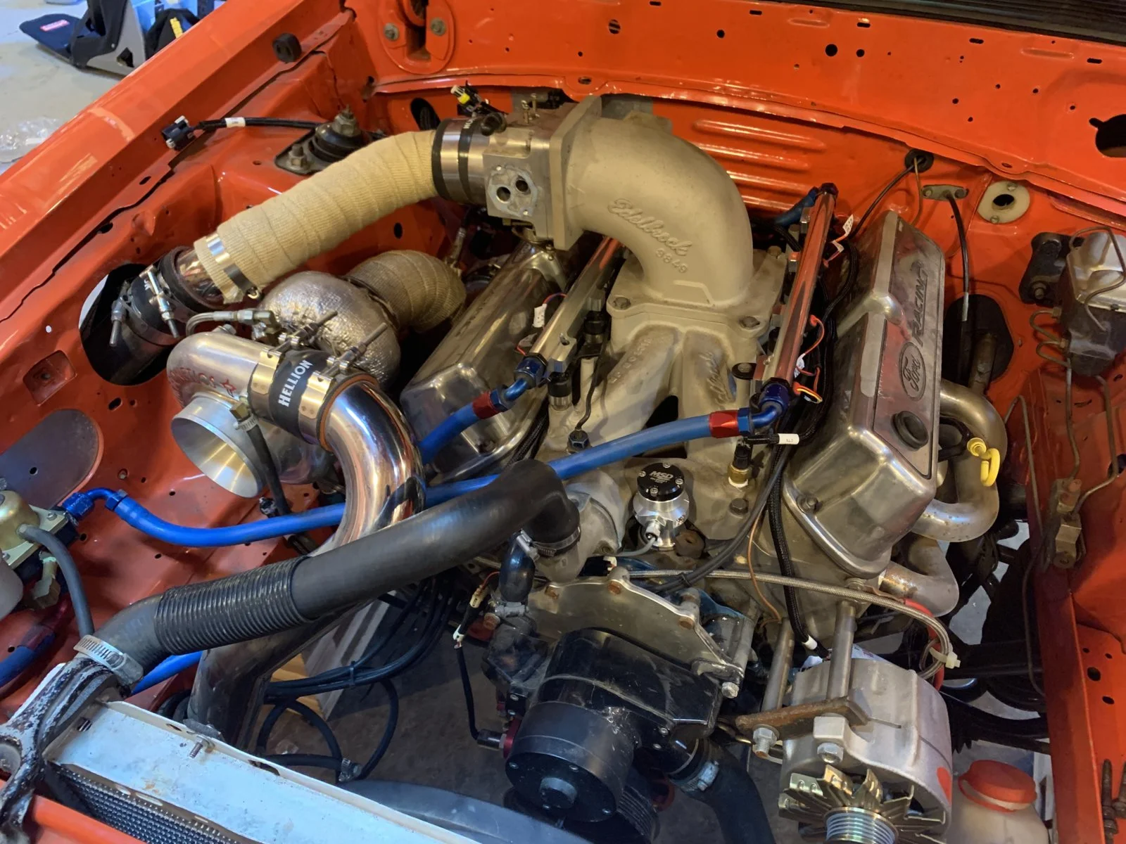

He has an R block based short block (347”), hi ports, will get a custom cam and converter, a glide and a new rear end as well as a much larger turbo than the little guy pictured and an a2w system.
I’ve converted it to crank trigger, cam sync and COP as well.

My turbo cars (954 and 889 rwhp, to date) have a ton of back pressure, which can/will ultimately both restrict power gains and prematurely wear exhaust valves. Go with a T6 housing, and make sure the exhaust wheel is known for the power level. As long as you have heads/intake/cam that's in the ballpark, the turbo does 90% of the work. Regarding the questions about the upper end, just remember that you build the upper based on the volume of the motor. Boost does affect flow, but less than you'd think. A motor that makes good power n/a will also make good power on boost. IMO, only the cam needs adjustment. Other than that, make sure it's got a good cooling system, and that the heads and block are ultra smooth for the MLS gaskets. E85 vs. race gas doesn't matter too much, but you need more pump and injector for the E85. If you have it, then you can run either. That's about all I can think of.
