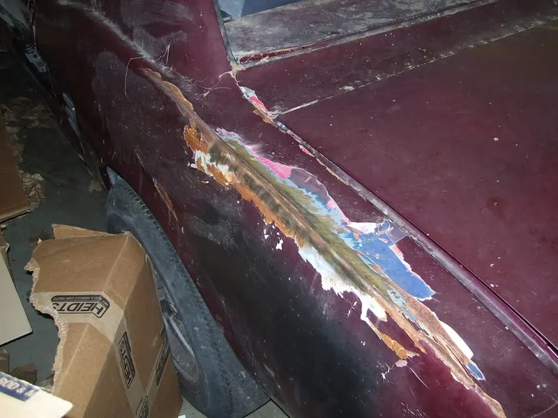

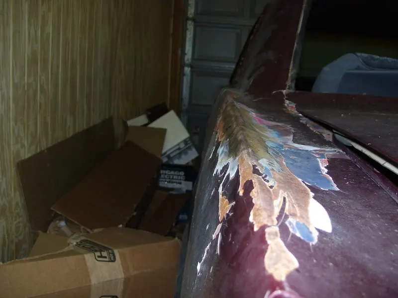

why is it this type of thing always has to be on a body line? I'm not a metal worker and see no way I can get this body line back to being factory crisp, this somewhat rounded appearance is the best I can do...no surprise there....so it looks like I will have to cut it out and replace it. My question is whether a 1/4 panel skin will cover this area or if I am going to have to buy an entire 1/4 panel....there is also a small area of the lower quarter that had a rust hole someone filled with bondo, so it will need to be cut out and replaced as well...the only rust on the entire car really....except minor surface rust in areas, no rot though
The 1/4 skin I'm replacing on my fastback extends from the body line in about 2", so it would replace that bad spot. Not sure about the bottom you are talking about, but I found out the hard way that the skin does not fold under at the bottom of the trunk filler to include the mounting hole for the rear valence. I'm still trying to figure out how to obtain / manufacture one. Have been told that the full quarter does have it.
in the rust hole at the bottom? yes, the rest of the panel is solid...I'm not too worried about it, I'll just re-skin the entire thing, the hole isnt in the part that curves under, its partially up the side so that should take care of it
I did the whole skin on my 65 coupe. It came in on top about 1 in so. I couldn't tell you which would be the better 1/4 panel replacement with the one that goes 1 in beyond the body line on top or the one that goes up the rear pillar. I think though that the one I used would be easier since you dont have to mess with the lead on the pillar.
probably the skin would be ok...how long did it take you to do? I dont mind replacing the whole 1/4 panel if I have to, just a shame to do that if I dont need to(I hate drilling out spot welds, I would rather cut a patch and weld it in)
I couldn't give you an exact time since it was my first time and I also had to replace my trunk floor and drop off on that side as well as my outer wheel well. Once i got all of the inside work done though it went pretty fast.
You're better off in the long run with a full quarter..... the style lines and general fit will be better and it is ctually easier, but takes a little more preparation removing the panel. The "Easier " part of the full quarter is that you utilize the factory spot weld locations to reattach it, rather than welding ( and warping) the middle of the crowned panel surface. My rule is that if there are more than two factory style lines altered or damaged, it's time for a full panel. My 66 was " pretty rust free" until I started doing work on it. the wheel house needed a patch, the trucnk floor was rotten at the bottom and there was rust in the front of the quarter that ZI would NEVER have seen if I hadnt had the complete quarter off. Here's acouple of tips..... Leave the trunk lid and door ON the car... these are your reference points to set your new panel to. Cut the spot welds around the tail light bucket on the new quarter and remove it. Leave it in place on the OEtail light [panel... it seldom rusts.... the door jamb on the front of the new quarter should come off by drilling the spot welds as well... keep the original latch pillar in place for reference so that you're not stabbing blindly for fittment... will give you a good reference point and make your multiple test fits easier.

That quarter will have about 30 or so spot welds, so get ready for some time consuming drilling. I still maintain that it's easier to replace the whole panel than to patch together a "skin" like in the photos.... either way, you'll open a window into your car and uncover some surprises, no doubt.
