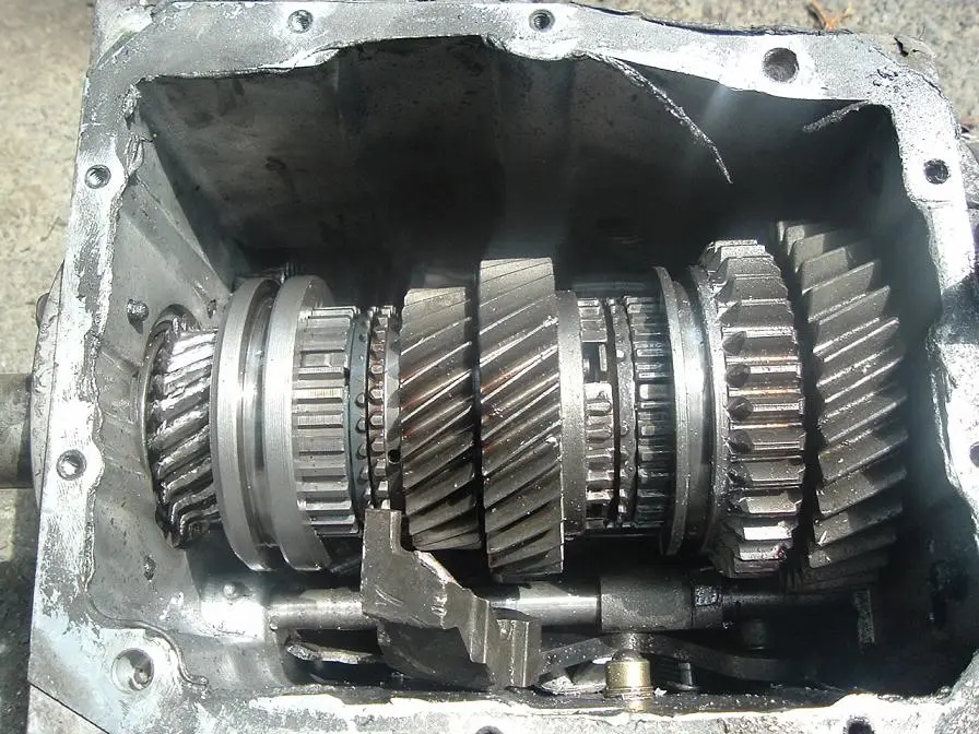

If it starts whining louder and louder than youre in for trouble. Mine started whining to the point where people swore up and down I had a kennebell and this is what happened. (gear to the left)
