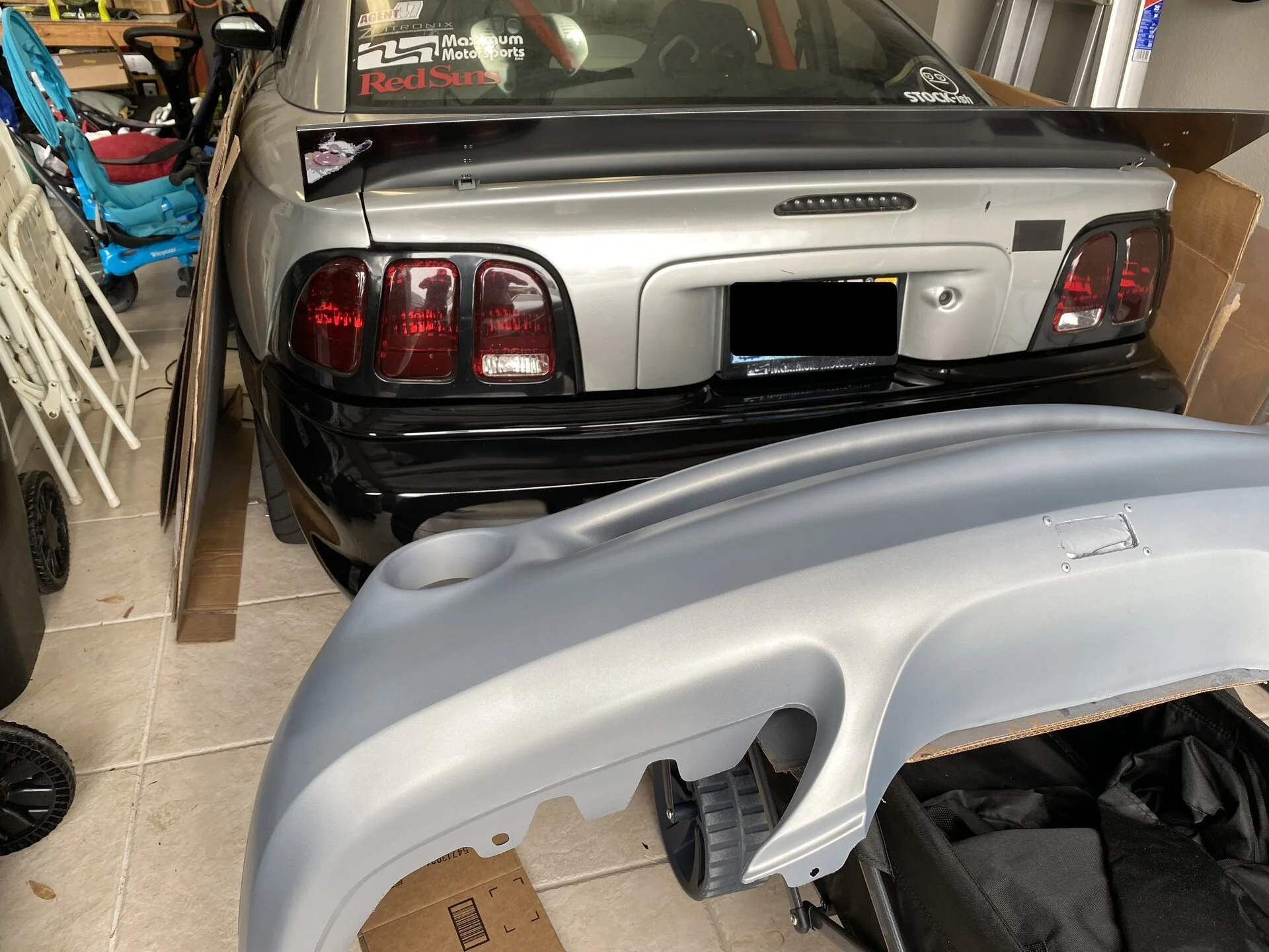

Hey everyone, I have a bit of an issue. I'm painting a front bumper for my 95 GT. The color code for the car is Opal Frost. I purchased rattle can paint from a reputable source that is supposed to be paint matched to Opal Frost. Also, this is the 2nd time I ordered Opal Frost - I sent the first batch back because it didn't match my car. As it turns out, this color on the bumper is similar (if not identical) to the previous batch I had. My point is this: it's not a one-off bad match. It's either a good match for Opal Frost OR the company I bought from just does not have the match correct at all.
So the issue: after spraying the bumper, when I compare the color to the color on the car....it does not look matched. The car looks more silver, the bumper looks more blueish/gray. Now, I DO NOT have a clear coat on the bumper yet. And I understand that this will make a difference to final appearance of the color. However, the basecoat just looks fundamentally different than what's on the car.
There have been a number of owners prior to me, and to my knowledge the car has not been repainted a different color. However I do not know this for a fact. I looked for evidence of a respray - I looked in door jambs and stuff. But nothing obvious. And the car was not well cared for prior to me, so it's not likely it was a perfect all-surface multi-thousand dollar paint job. It's possible the Opal Frost and Silver are so close that I just can't tell in the door jambs. But it is a possibility the car has been repainted. Also, for my year, there is no other "silver" color - Opal Frost was the only "silver" color.

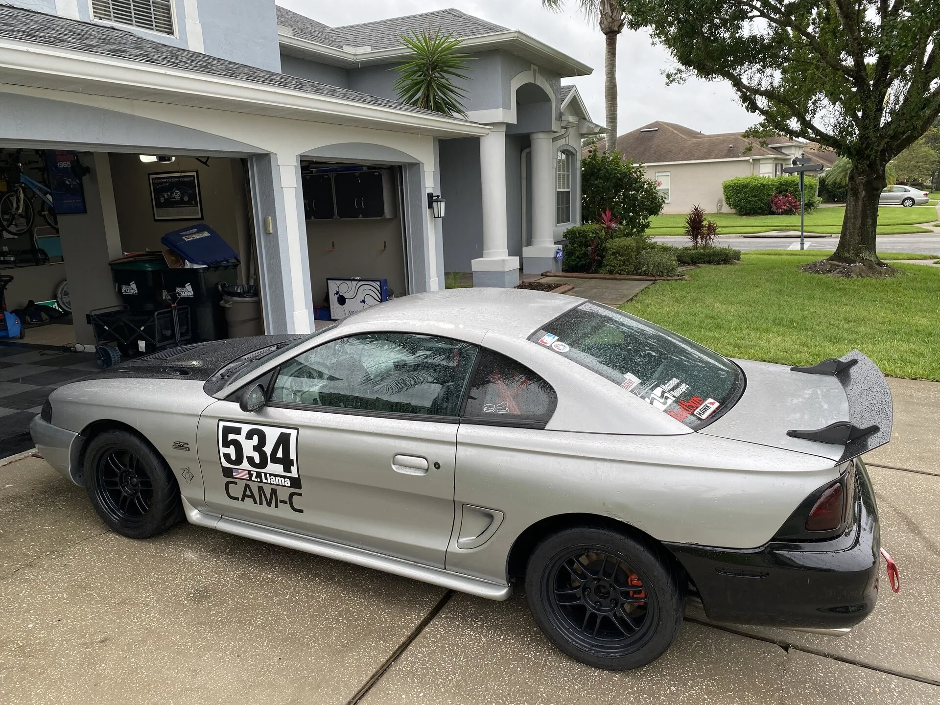

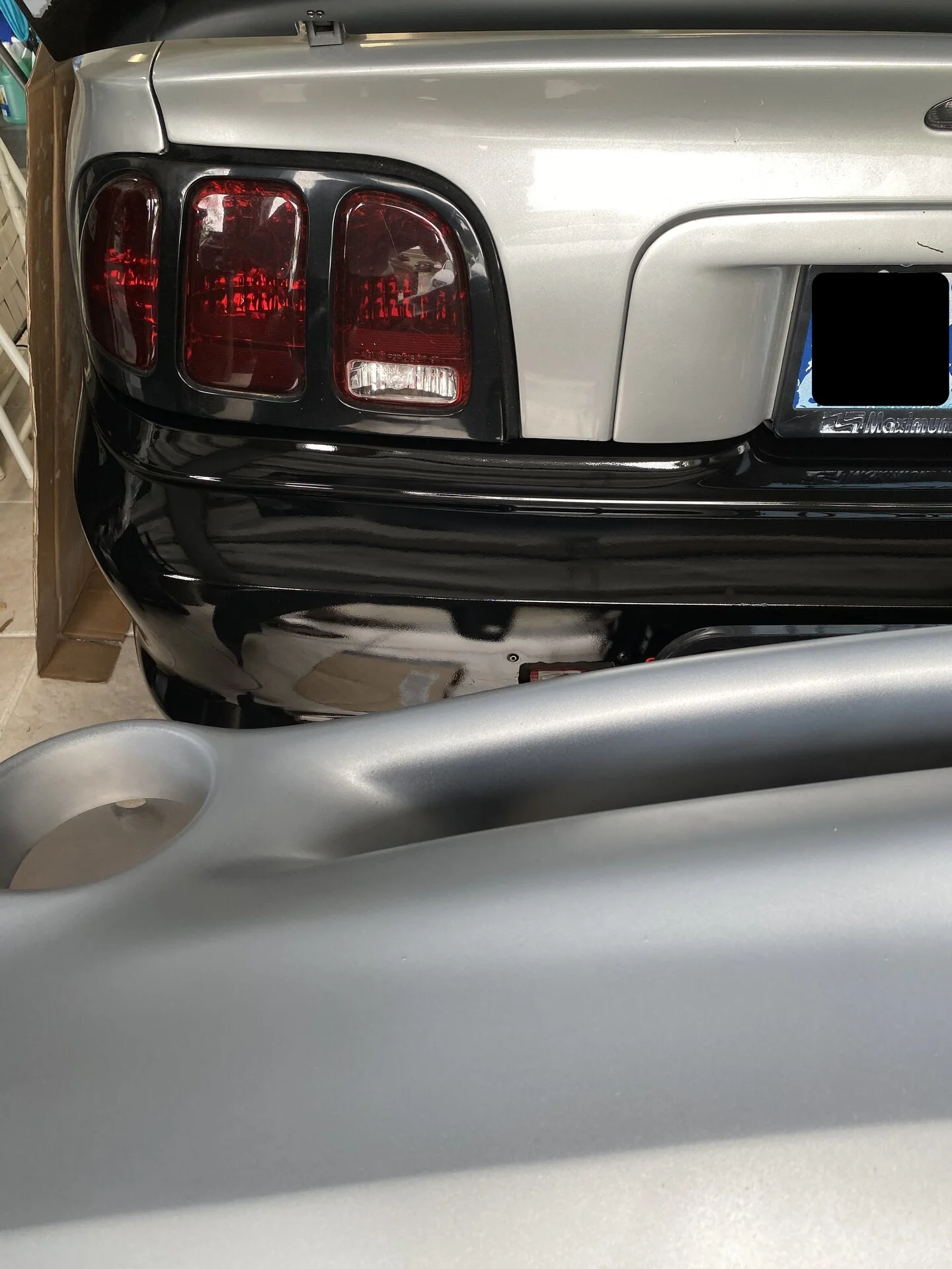

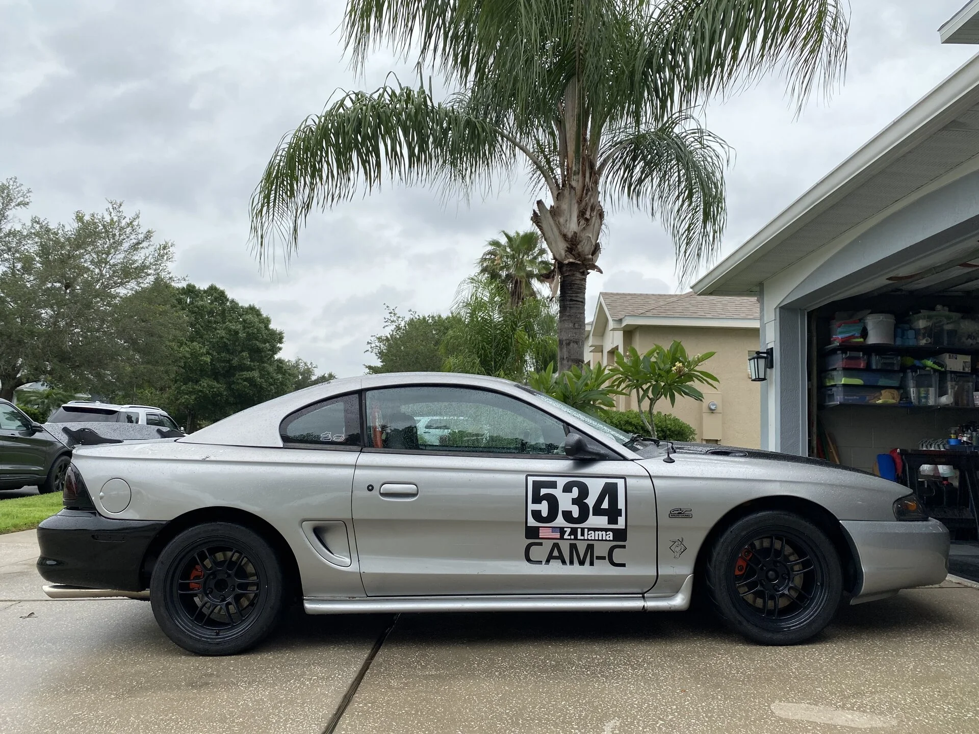

I have posted pictures below showing the front bumper painted Opal Frost (no clear coat yet!) next to the trunk of the car, which looks decidedly more silver... :(

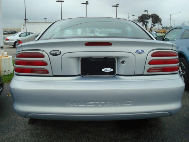

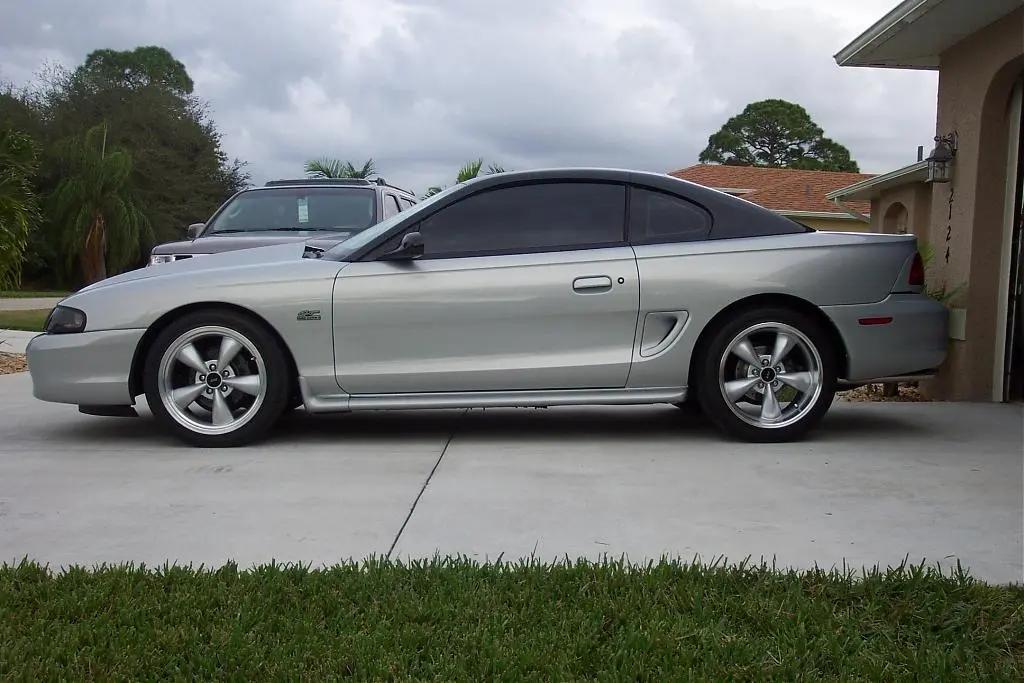

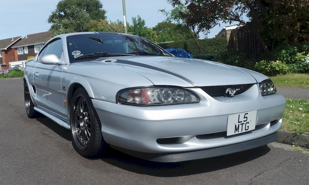

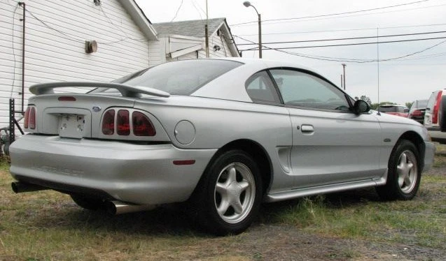

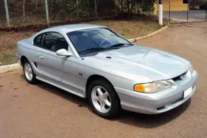

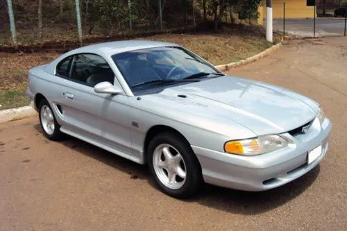

Opal Frost shows the blue except in 3rd pic
faf59eccff91795f13a24f2b0cb08fee.webp 1995_00027_03.webp 1996_00031_04.webp 1995_00020_02.webp

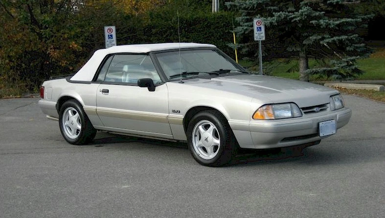

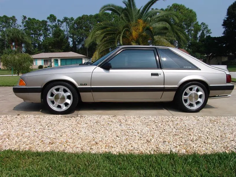

93 Titinaium Frost looks closer. You'll need the paint shop to do a custom match. Take them the fuel filler door.

Lulz. Well I certainly appreciate the input. I'm thinking more and more the car was repainted at some point is no longer Opal Frost. I think you are on to something with the silver color of a different year Mustang. I did a little Googling and it looks like the silver (code YN) from a 98 Mustang is preeeeety close. Can't tell for sure from internet pictures of course.

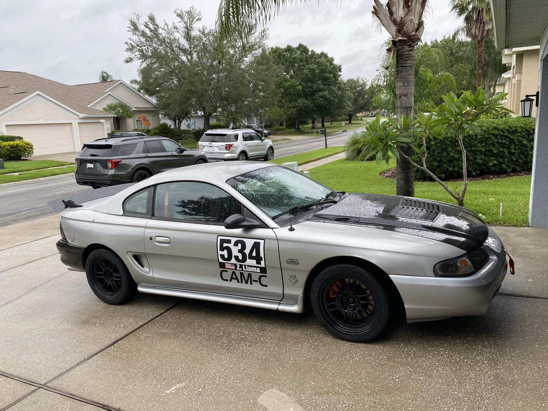

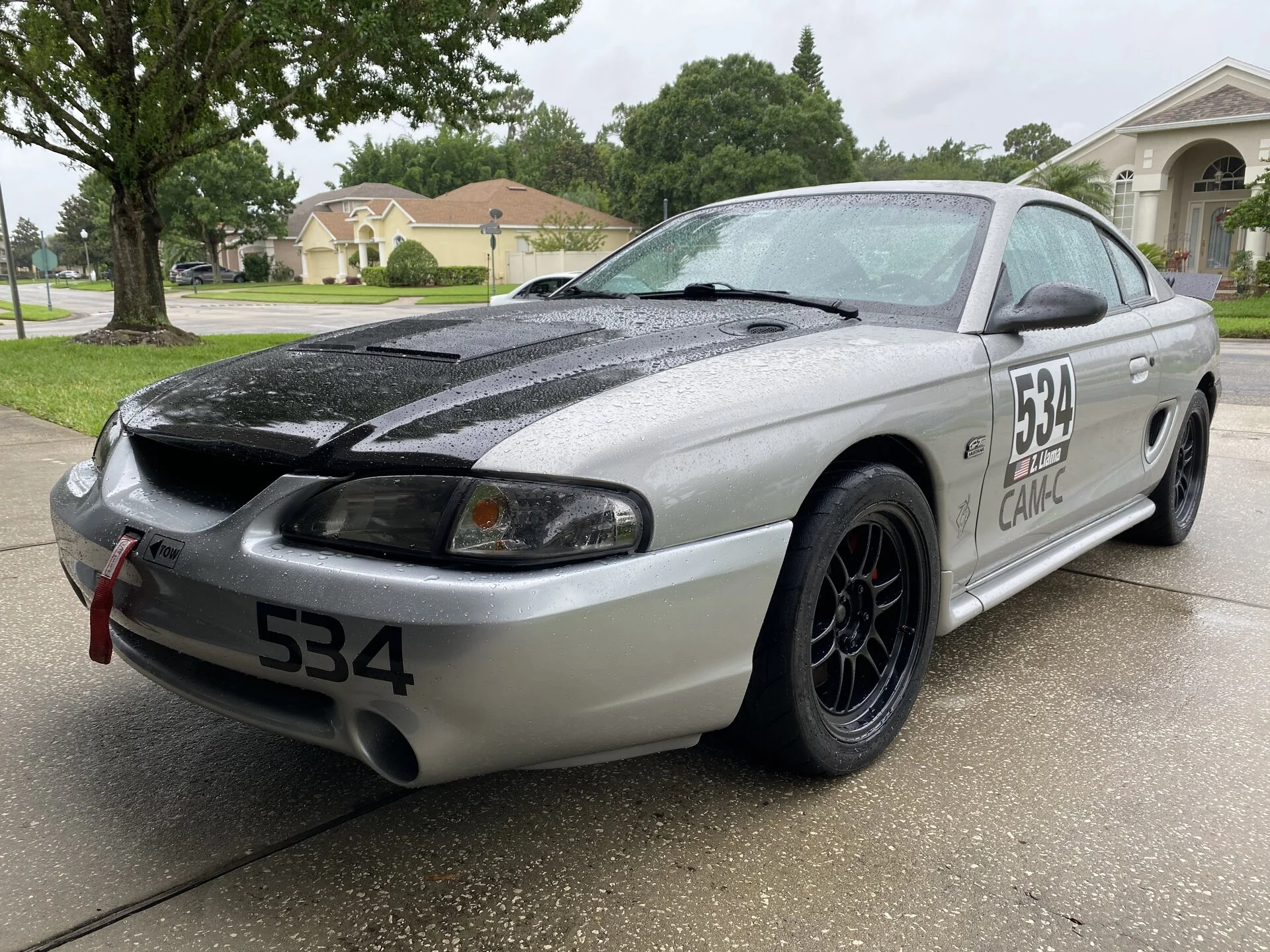

Okay, sorry to take so long, but finally I got around to closing this out. Firstly, thanks @2Blue2 for the suggestion to take the filler door to a paint shop. That was exactly the advice I needed. And it's what I did.
Turns out the paint is NOT Opal Frost (not really surprised there since it didn't match). But rather a silver from the Ford Fleet vehicles apparently. Anyway, *very* close to Ford Silver Metallic. Apparently, my Opal Frost Mustang had been repainted at some point - which also doesn't surprise me given the history of this car lol. But it's all good. The paint shop mixed up the paint that they said matches, and I bought 4 rattle cans.
And the result is...it's pretty damn close. Maybe not quite *exact* but honestly...it totally works for me. In these pictures, it's the front bumper that got painted.
So, I'm happy. Much appreciated! :D
