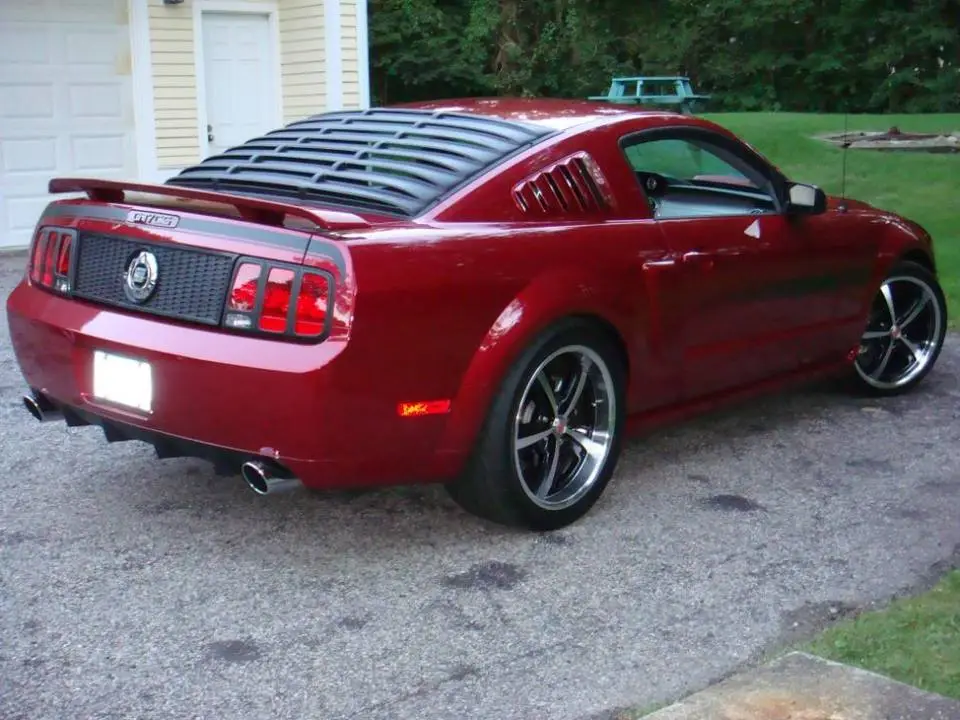

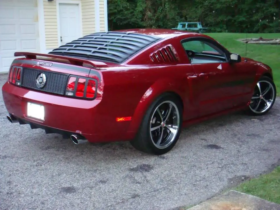

Mine do block some visibility, but its not terrible. Here is a shot from what it looks like if you were to turn your head and look out:
My biggest piece of advice is this: If you get ones that use 3M tape, cut a small notch out of the bottom corner towards the front of the car. One of the ones on my car didnt have a bit of tape in the corner and the other did. The one that has the tape all the way around the corner ends up building up water when you wash the car and its a pain to get out. The other side drains perfectly.
